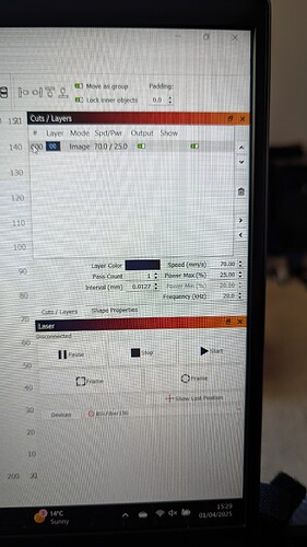

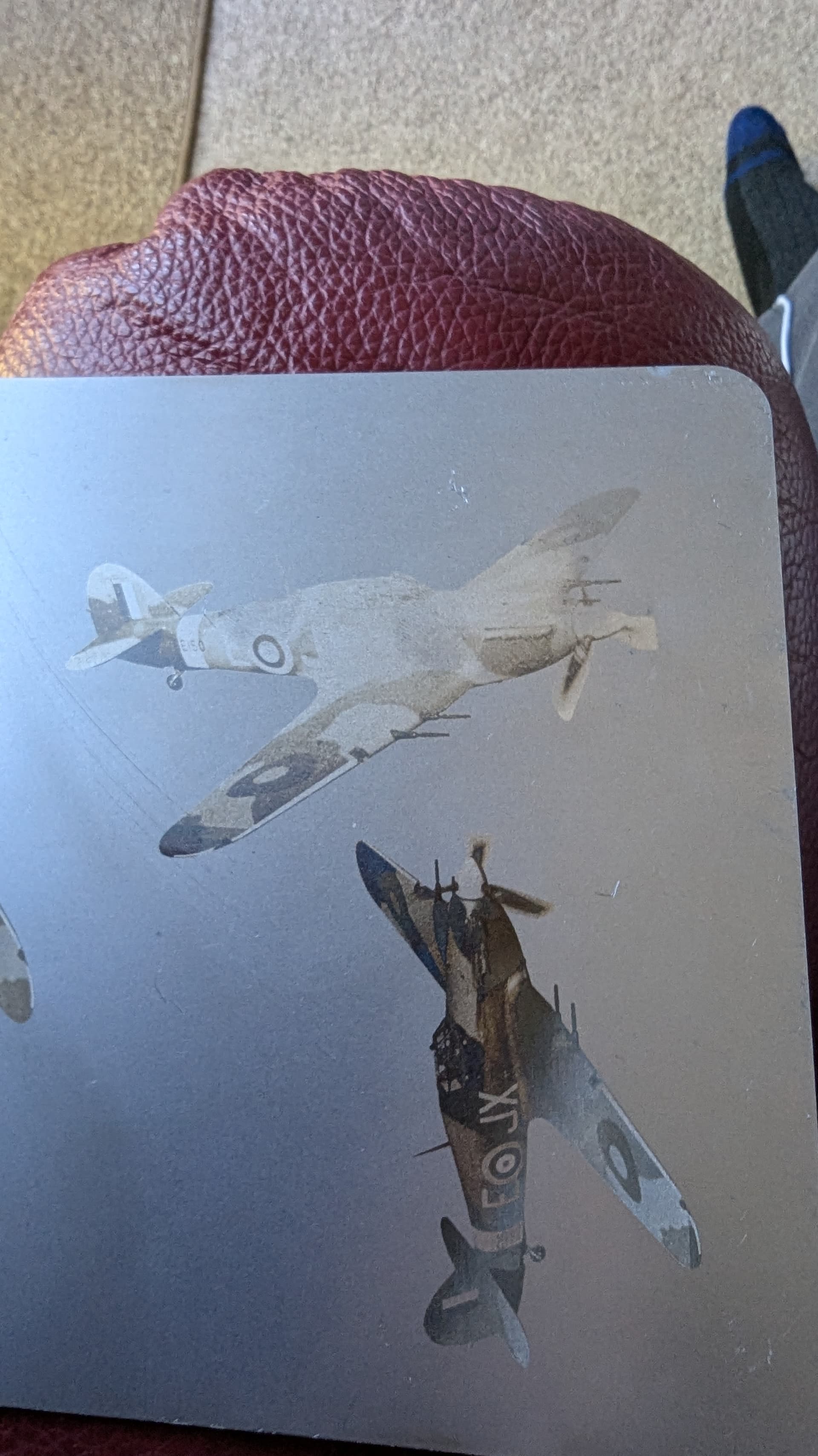

I’m new to lightburn and to the G2 pro 30w laser and am having consistency problems when using Glaser it engraved fine but it never engraves evenly when using lightburn any help will be great

Are you saying, the same project file on another location of the material shows different results? The only explanation I have for this would be a warped sheet of metal or an otherwise changed focal distance.
If your picture shows the results from GLaser and LightBurn, which is which?

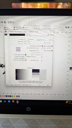

Some of your settings might be different. (my bet would be on the line interval)
If you send us screenshots showing the layer settings in both programs and pictures of the respecting engravings we might spot the difference.

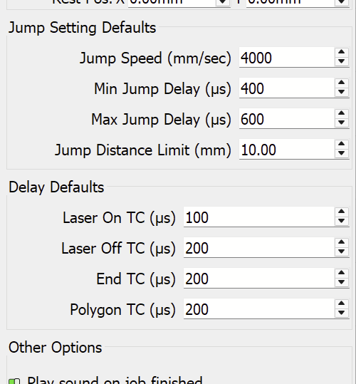

BTW, I have the same machine and got better results with these adjusted timing values in the “Edit > Device Settings”:
