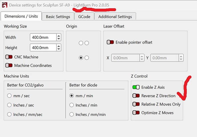

Perhaps:
There is a option regarding this issue, but I can’t see this option in the dialog window. Very strange.
Reverse Z Direction
If your machine’s Z Axis moves in the opposite direction of what you expect, toggle this switch to flip the direction for Z moves.
This is very strange…..?

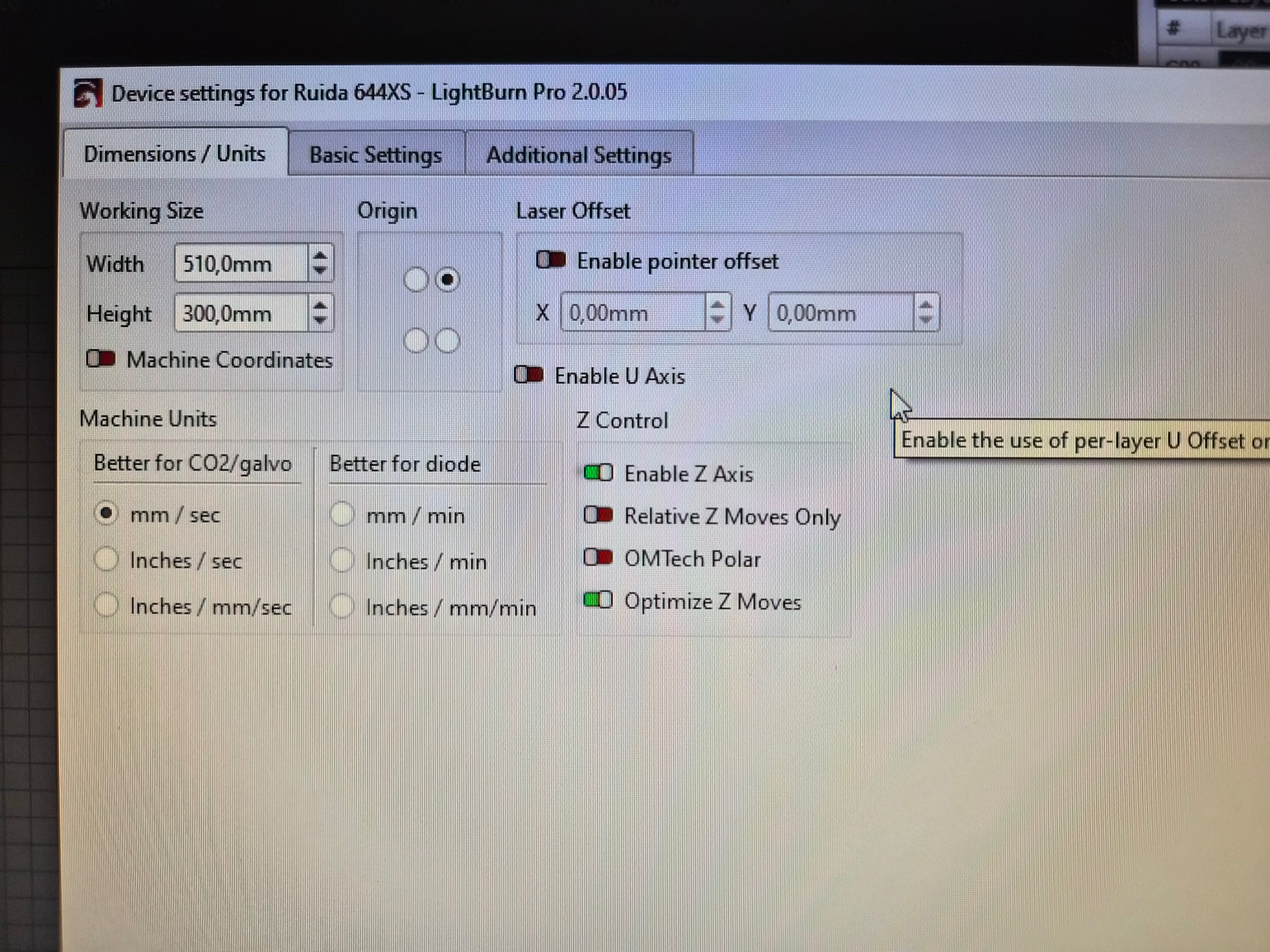

LightBurn presents only the available options for the controller chosen during the Device setup, so what you see corresponds to the Ruida 644x controller (and we now know which controller is inside the NOX :grin:).

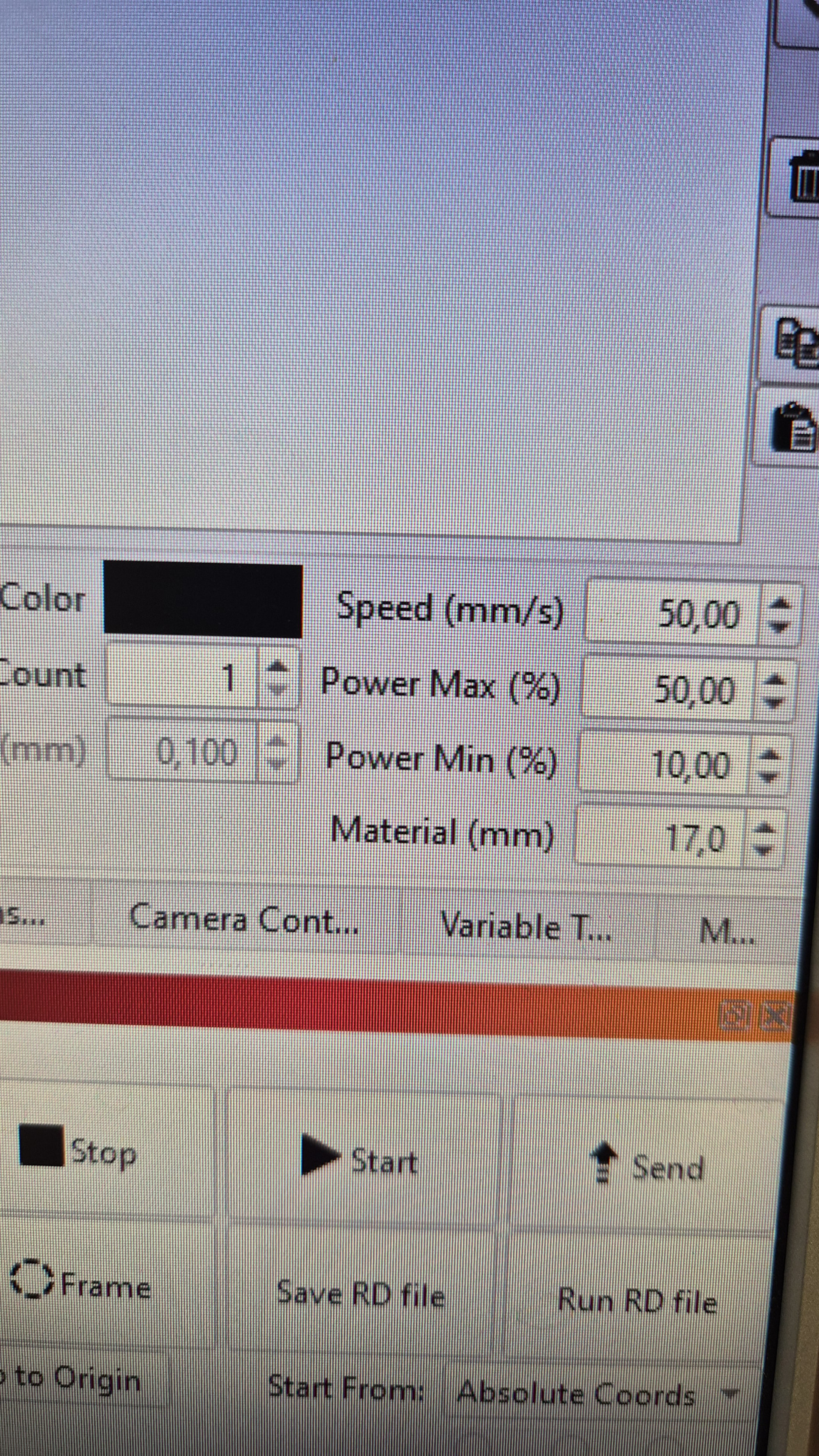

I will do some tests today :slightly_smiling_face: I have read in other threads in this forum that it should be possible to set the focus by entering the material thickness. To invert the movement seems like a easy thing to adjust…
I have tried the Z axis in RDworks and it moves as intended, I have to do the “17 minus the material thickness” dance, but thats how it suppose to work as far as i’m aware.
0 mm setting puts the lens at the top (as far away from the material as possible) and 17 drops it to the bottom, this must be a easy setting to adjust. I had the Cohesion3D control board before, is the ruida system not able to make an easy adjustment?

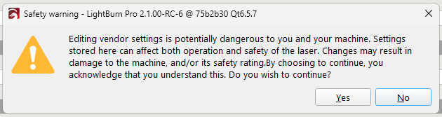

Those switches are available in the Vendor Settings section of LightBurn’s Machine Settings window, after you acknowledge the warning:
