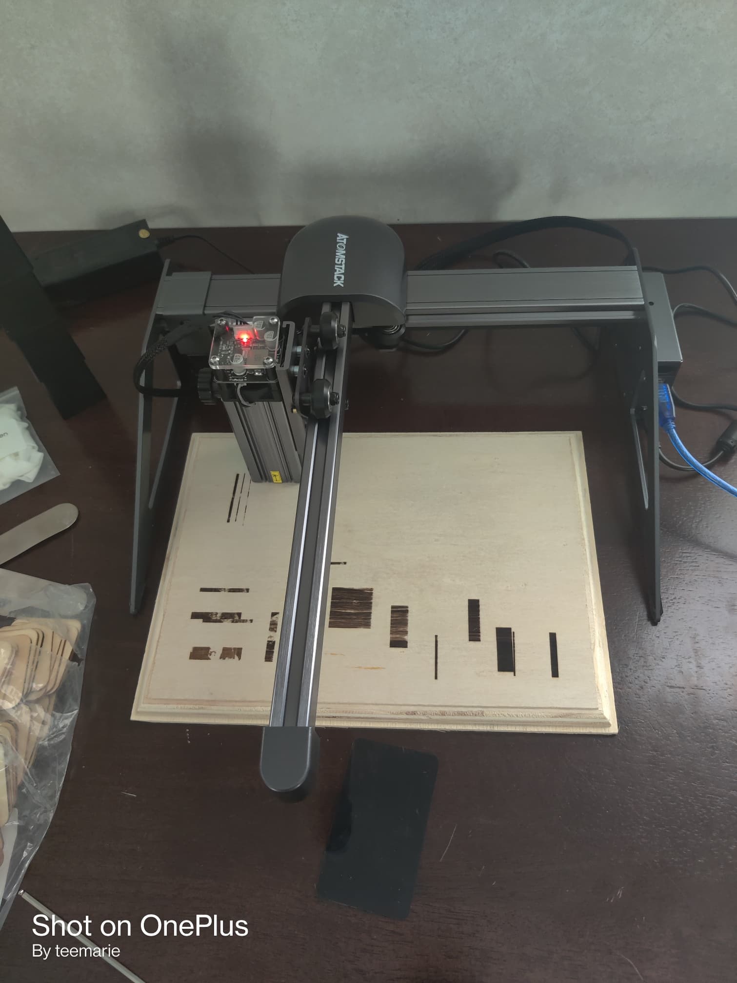

Can take a photo of the laser as you have it setup please?
here is the picture of my laser
me either but for some reason i still am and its a bit flustering because i dont know what else to try
side note!! i only have this issue when trying to fill (engrave) when i do like lines it works just fine
