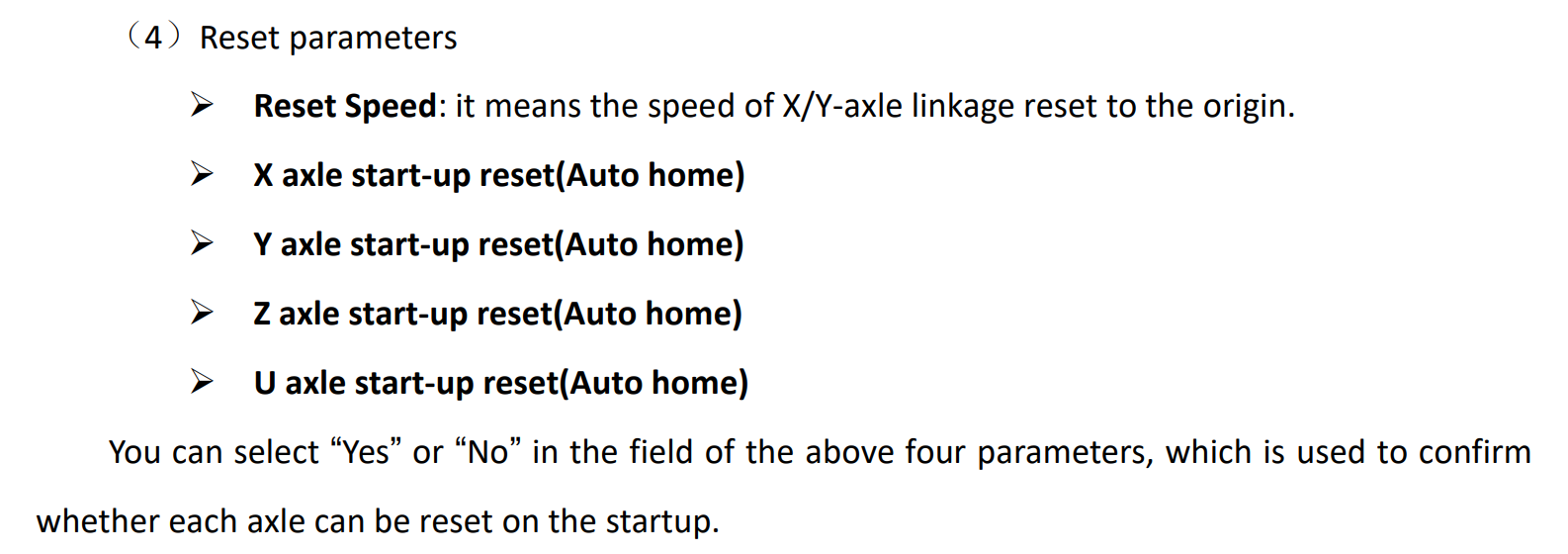

Under User Parameters:
You haven’t listed your controller. This is for a 6445.

In that case I’d suggest going into your user settings and adjusting the settings I listed. That may be enough to get it to work.
Both the x and y were already set to yes. And still when I press home in LightBurn it goes to back right and slams into sides.

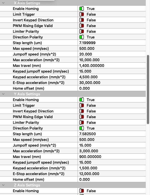

@edbarber The key point is that the system must perform a homing cycle when you power up the controller or hit the reset key. Can you send a screenshot of the Lightburn Machine Settings window showing the “X axis Settings” and “Y axis settings”? I’ve attached such a screenshot from my computer. As @berainlb mentioned, “Enable homing” must be set to “True” for both the X and Y axes.
Thank you two for your help. I think with your help I finally have it fixed. I’ll know more tomorrow when I have more time to use the machine. But for now with the settings you showed me it is homing properly when I reset , and when I start up the machine. Can’t thank you enough.
