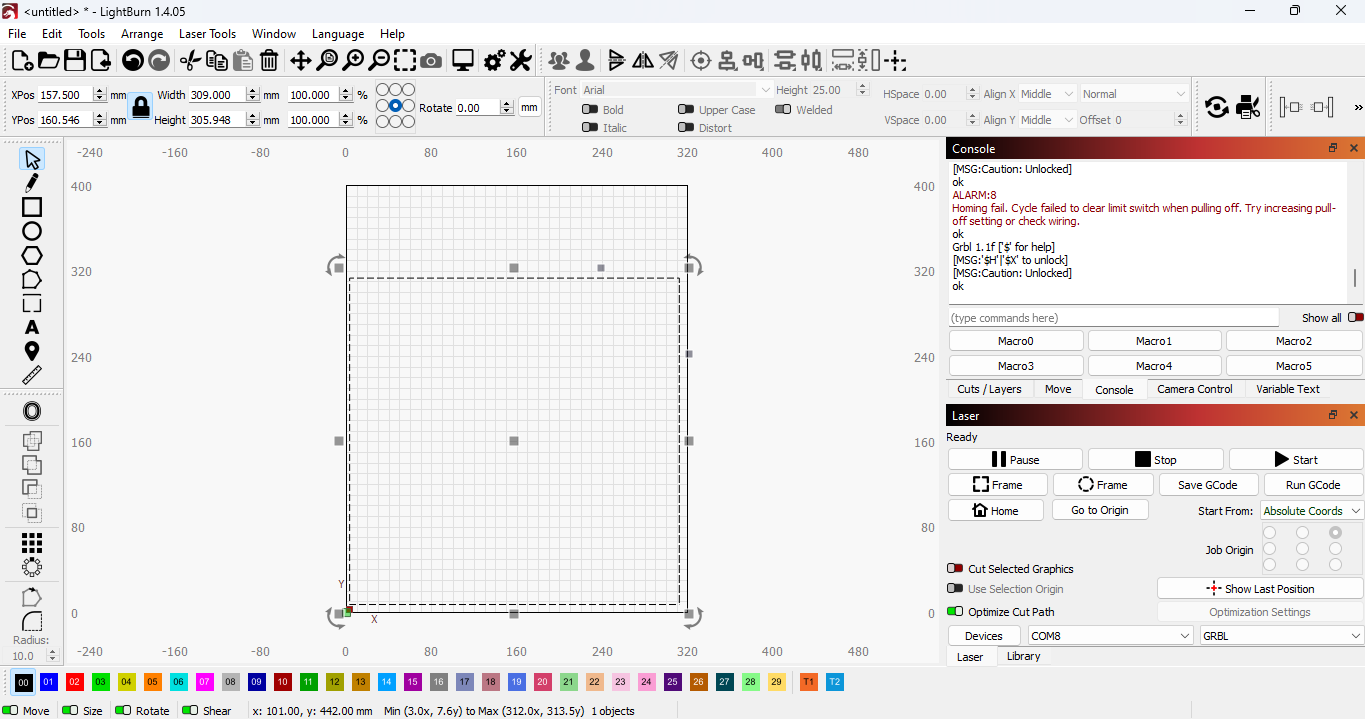

I need help with my machine, once I turn on the machine the motors gets stiff and can’t move. Lightburn keep saying there is HARDLIMIT issues. help…
The motors lock when you turn on machine.
Can you jog laser in move window?
Yes it does and giving the hard limit messages.
I would turn hard limits off.
So it looks like your limit switches are a problem. Shut machine off and move laser to each switch and see if it is tripping each switch.
