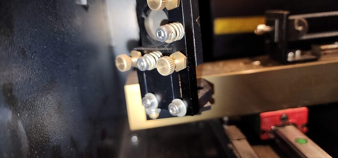

Looks like at the very least I would need to get a nice laser head, doesn’t look like there is much adjustability.
The mirrors look like they are already maxed out on height, but nothing a spacer on the mounting end couldn’t fix.
Tube brackets look like they would adjust just fine for a 80mm tube if needed.
EDIT - You know what , Im thinking about this all wrong. Instead of raising my mirrors, Why couldnt I just lower the tube? The current brackets in there have a bunch of spacers already, Take out 15mm of spacers and I should be lined up in the ball park. Or am I over seeing something?
I was going to mention they have a stack of spacers under the tube.

Think about mirror 1 and how it aims the beam. Its only purpose i to aim the beam parallel to the Y rail. So if the tube or even one end if the tube is raised or lowered sending the beam at a slight angle, Mirror one is still capable of sending the beam parallel to the rail. Once that is done, do the standard alignment and you are in business.
When I put a new tube in one of my machines, it was more powerful and the tube was wider, I just changed the tube holders with ones I could adjust up and down, didn’t touch the mirrors. It was a fairly simple job, new tube, power supply and tube holders. I already had the extension box.
