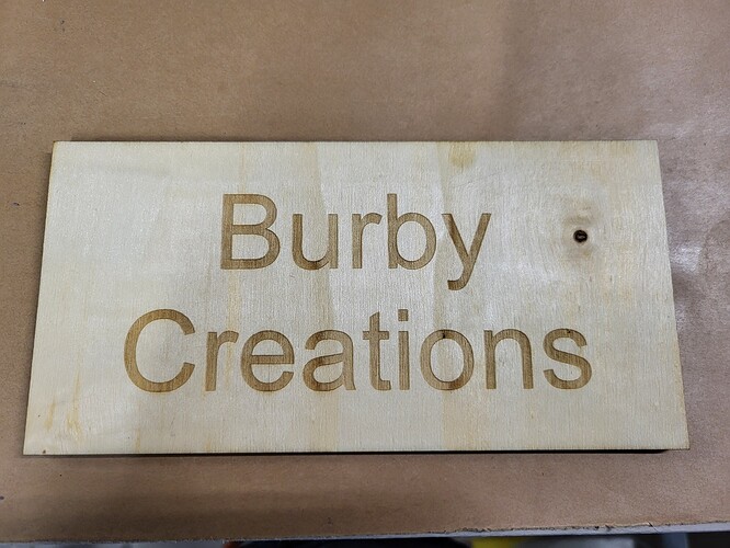

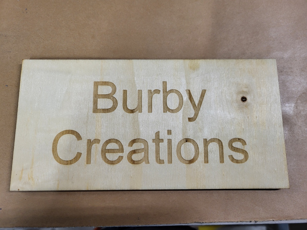

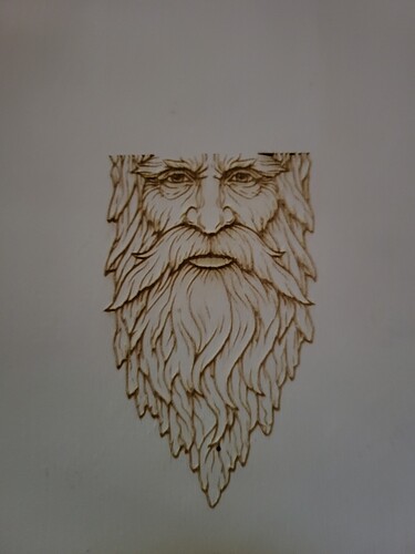

Didn’t know you could add pictures. My lady and the second test job.

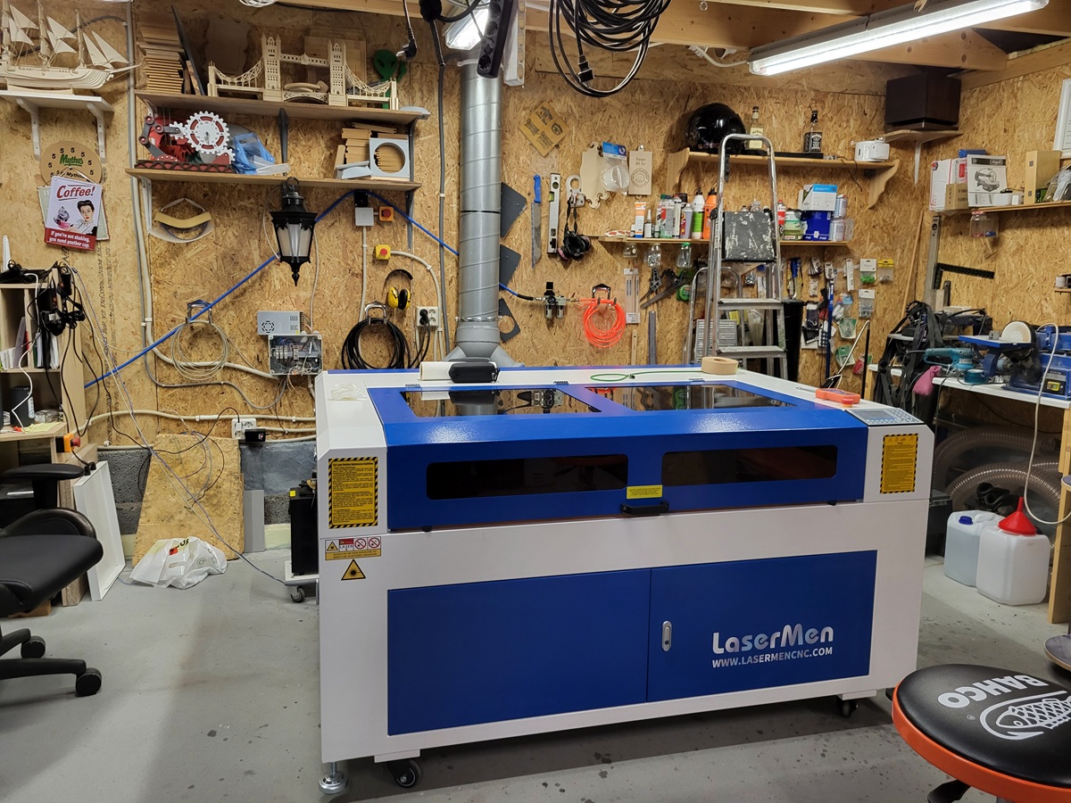

Your setup looks great: easy access all around!

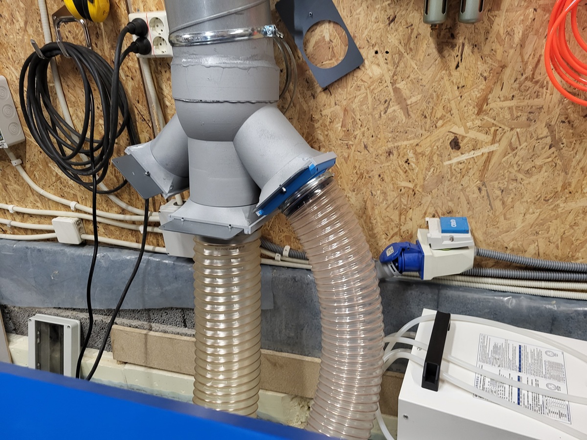

The vent splitter was a fun Fusion, 3D print build. 200 out, 100,120, and 150mm in.

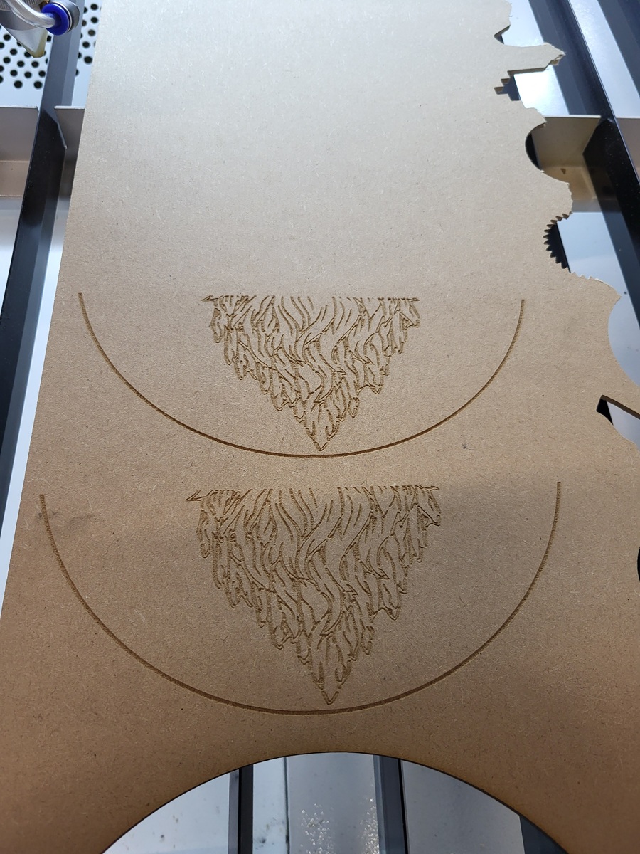

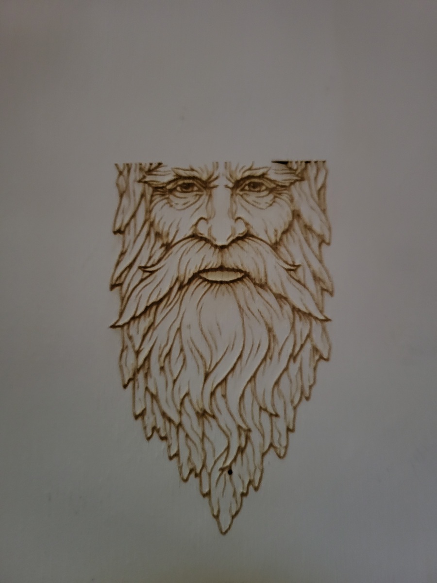

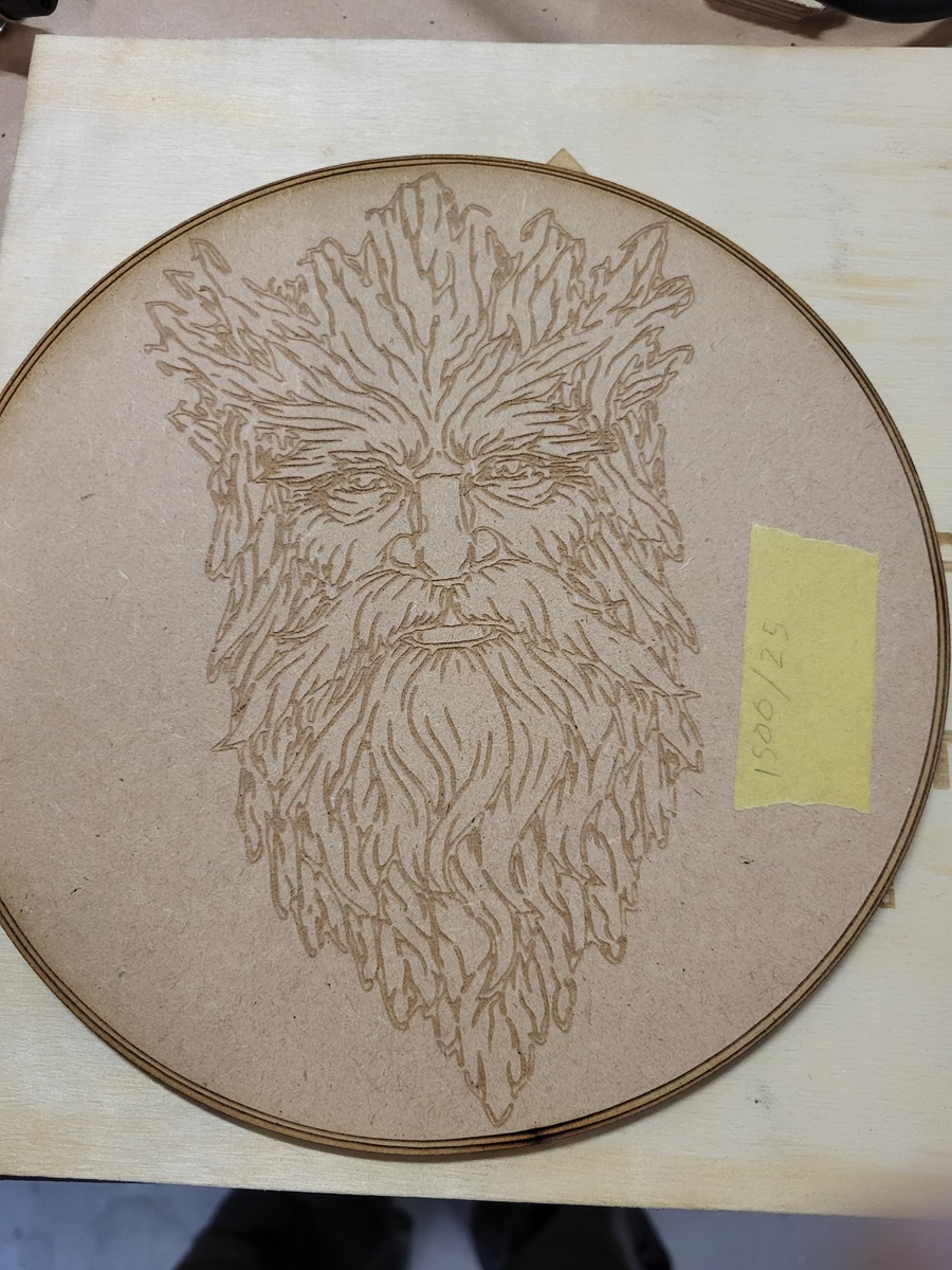

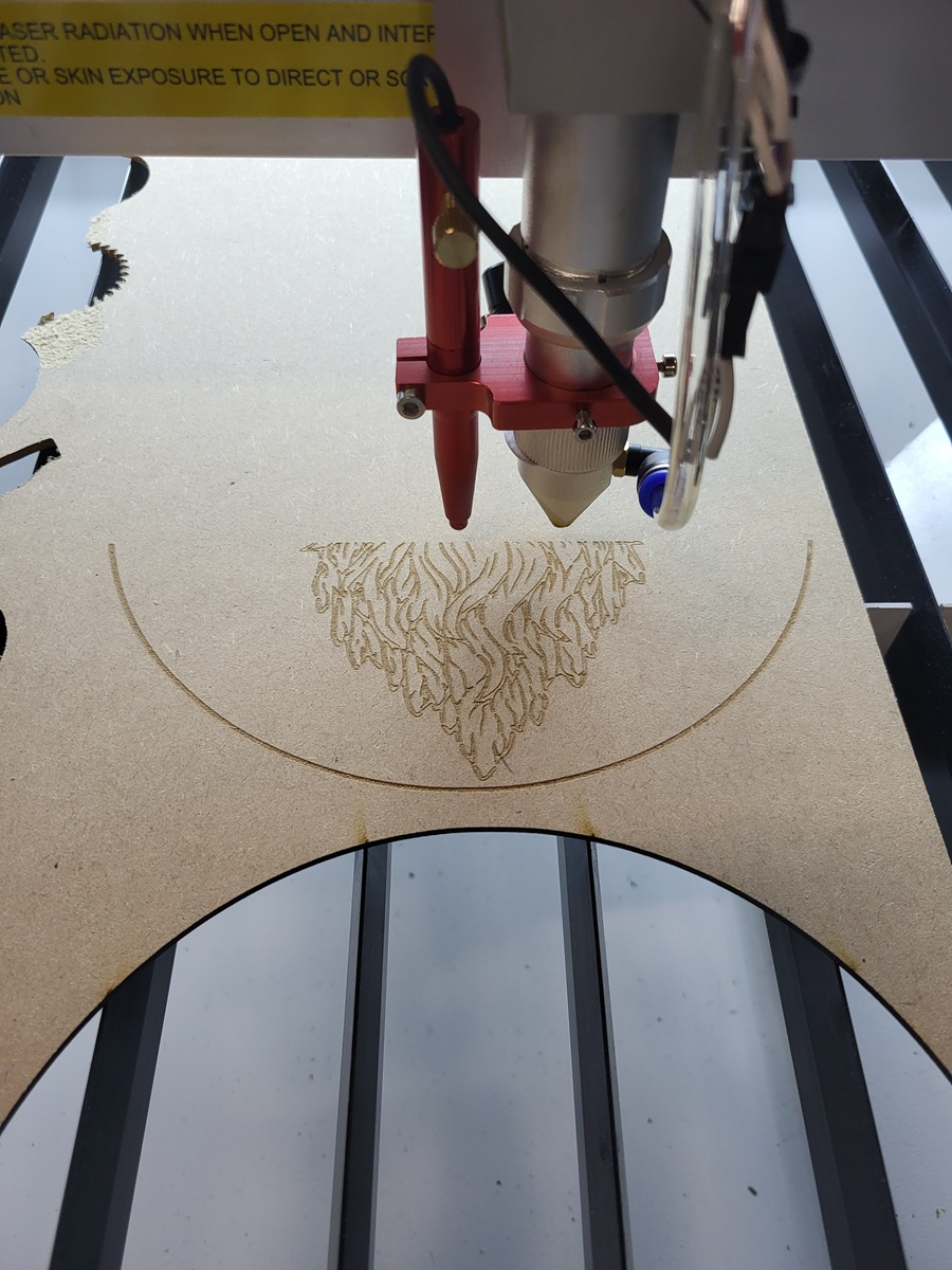

I ran a job (forgot to take a LB picture) I ran one time and then would only run about a 1/3 and lockup. Reset, Try to run, One line and lockup. Turned off the computer and laser, Nope, same thing and almost in the same place.
Deleted the program and made a new one. Same thing. ???
I did something else and it would run OK and then it would take a little trip. Come back maybe in the same place and start (filling) again.
I turned it off for about 10 min. The rest of the jobs I tried ran OK.
