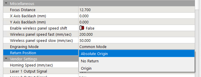

The Machine Settings has three choices:
Which don’t match the four choices on the machine display:
  • ABS position
  • Not return
  • Origin pos
  • Docking point
The machine also has a Yes/No option for Return to Origin, which must be Yes for the four choices to matter. I do not know how No differs from Not return.
It’s always been set to Yes and ABS position, which leaves the laser head at the home position after startup.
Changing it to Origin pos sends the head to wherever it was when I most recently poked the Origin button on the machine display.
I have no idea where the Docking point might be.
