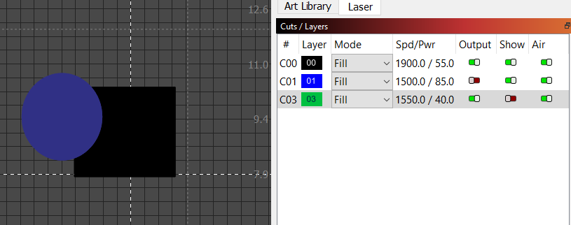

I cannot find the location of a line art object on the grid. The object is selected and the frame of squares shows up but I cannot find the screen that shows the objects location on the grid so I can align the art object with desired location on the item to be burned.
Look at this picture.
The black, blue and green objects are on different layers. Each layer is turned ON for output and ON for show.
Now the blue is turned off for output… and is subdued in color. It will not engrave, but it does show on the grid.
The green layer is still turned ON for output and it will engrave - although it does not show on the grid.
Check your settings and if you need more help, please post a screen shot and/or the save file you are working on .
