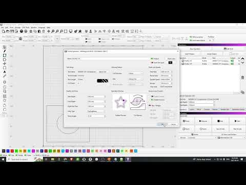

I can confirm that the RapidChange ATC does in fact work great with MillMage. I was actually just going to do a video of the software setup for just such a setup.
New video of my settings in MillMage
Using MillMage with the RapidChange ATC
