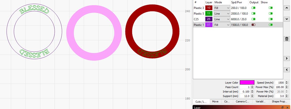

Hello everyone. Im very new to the engraving world, I’m also quite inept at the task I have found. Many MANY questions plague me.
My current one, is trying to fit tow words within enclosed circles. The text does not align very well, and as with the case of the selected text you will see in the picture, it does not align at ALL. Would anyone be able to help me get this issue sorted?

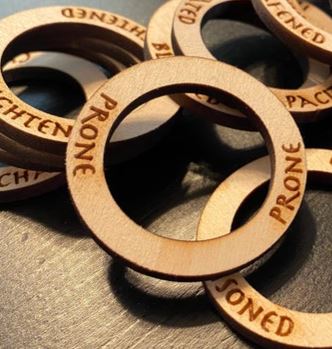

Since you’re just using circles anyway, create a piece of text, switch to selection mode, select the text, then grab and drag the blue dot that appears to bend the text. You don’t need to create a circle to do this, and it’s much a much simpler way to create and work with circular text.
For your actual question, without seeing your file or the font you’re using, it’s hard to say what’s happening exactly, but it doesn’t look like you’re doing anything wrong at first glance.
Thanks for the response Oz. The font was dungeon. I threw a screenshot in just to show what is happening. I’ll give your method a try. My other question further to that, I know how to engrave the lines, or the fill on the text, but How would I go about making the text ‘debossed’ so to speak. So the the fill inside the 2 circles is engraved but the text is not?

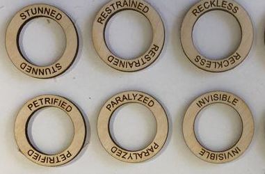

…is that what you mean?

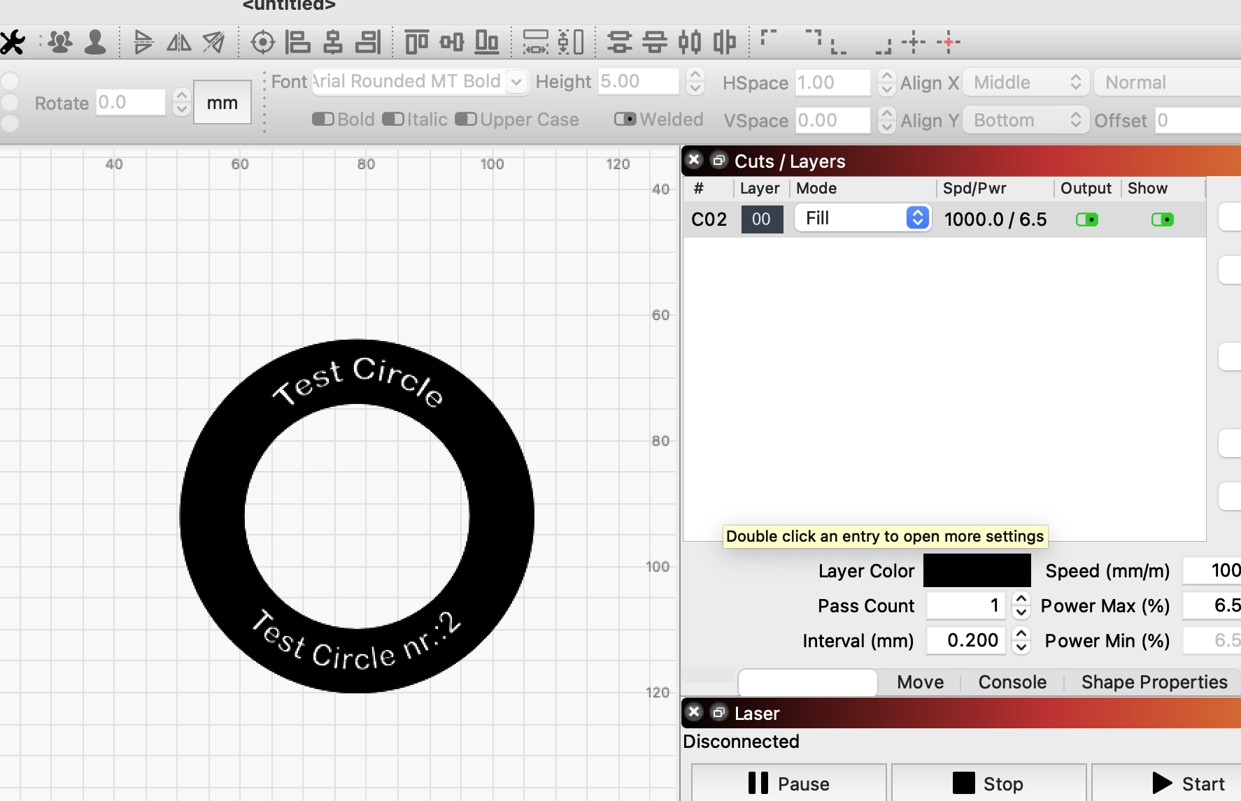

Everything in the same color is treated as a boundary. If you set that layer to fill, the boundary acts as the toggle point between filled and not filled, so just adding another shape inside an existing one creates a hole in the fill. Put the text inside a shape, as Bernd shows above, and the text is now a hole within that shape.

Ok. Excuse my imbecility. I managed to find the filled option under window so I could actually see the fill. However I see on @bernd.dk picture that he only has ONE layer with the text in it. I cant make that happen.
The second circle is a copy of the first circle, but filled in. No text is visible. 3rd circle, text is visible for whatever reason, however, the fill goes underneath it, so it wont stop the fill in that area. But If you notice, I cannot achieve any of these without multiple layers.
The text needs to be on the same ‘Fill’ layer to recreate the look @bernd.dk presented. In your example, it looks like all your text is on a ‘Line’ layer which will not work for what you are after.
Put your circles and text on the same ‘Fill’ layer.
Legend. Thankyou All again. That did the trick. I need a better font to make it work. I clearly need some more training on getting this to work. Thankyou
Hi Brett, it’s a little funny, I also started with 2 layers and could not remember how I “normally” have done some similar tasks. But once in a while, the most simple things are the best, and in this case it is very clear how fine and straightforward LigtBurn is. I draw 2 circles - group the circles, create text and drag and turn the text in the ears (the magic blue dot) - position the text between the circles AND press the fill button .It’s all on one and the same layer. Wonderfully simple and fast.

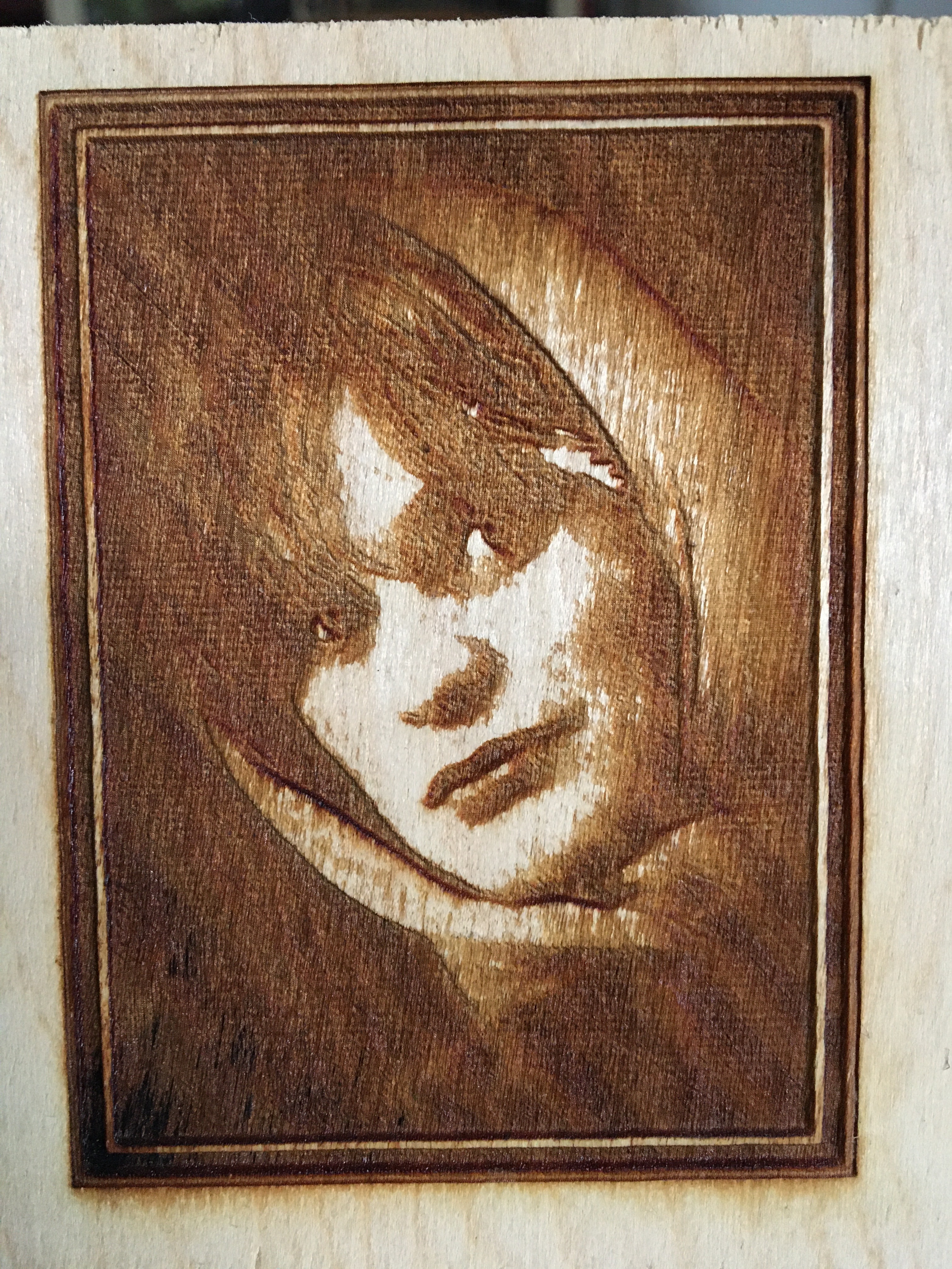

Hi Jeff,
I have found a picture from my “laser diode time”. At the bottom of the picture there are also clear traces of soot, but otherwise the picture is reasonably clean and not greasy, although I have engraved it deep (approx. 1.5mm). For this type of task, I use lots of compressed air, directly on the spot. I clean the picture afterwards with technical alcohol and sand it with k100 sandpaper, but only if necessary. One of the most important aspects is the type of wood. I choose for pictures wood which is very dry and if it is plywood it should preferably be with white glue (suitable for indoor use). Often I also use masking tape but of course it does not work when I engrave pictures.
Another tip is to split the task in two rounds with reduced power and or increased speed, it also works very well for me, but, it takes a lot of time.
The soot at the bottom of the image also indicates the airflow in my laser !!, at the edges I should have used even more air.
