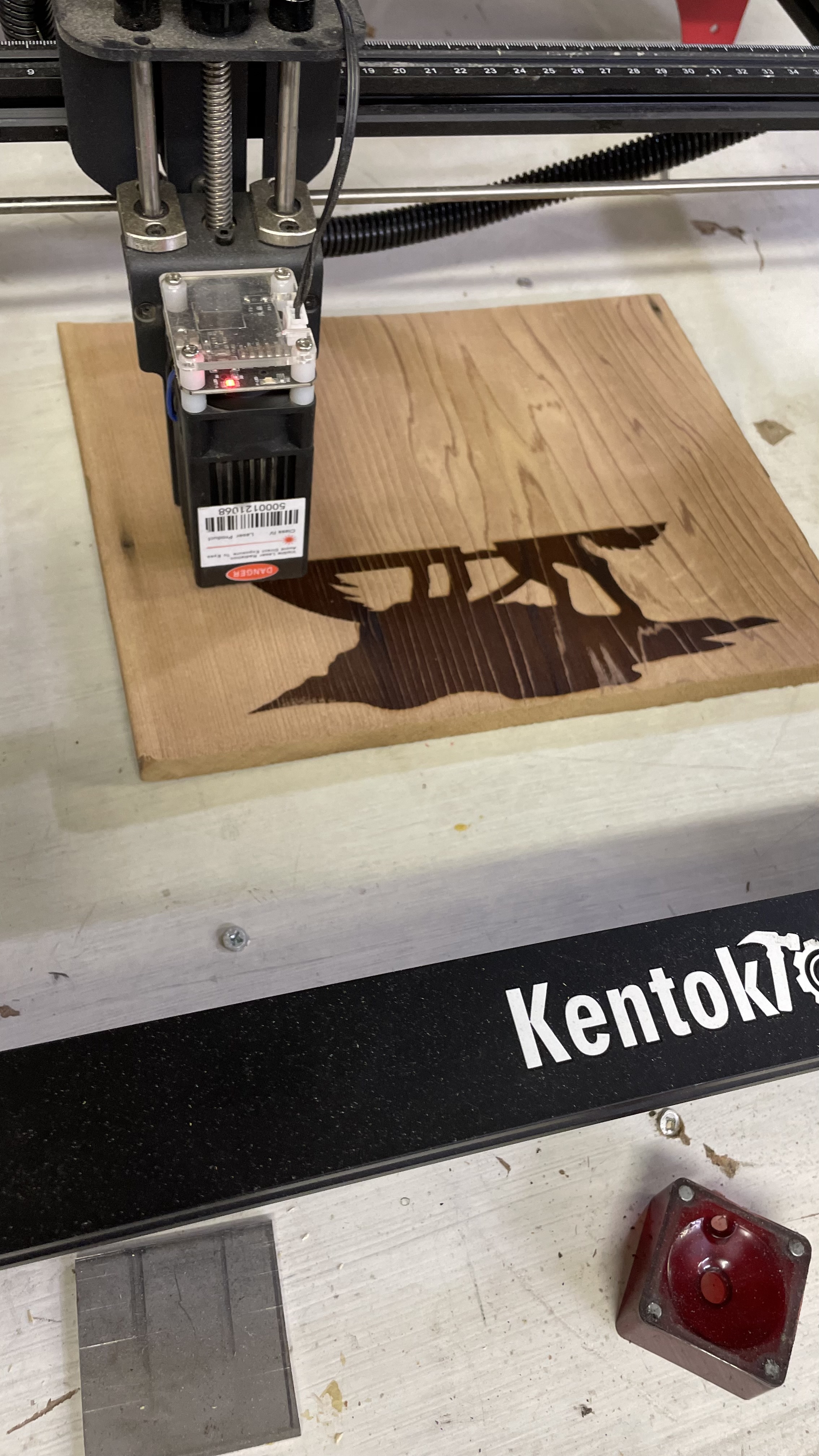

Having issues with “Fill” Function on Kentoktool 5W machine
I’m not sure why it’s doing this, however, it is stopping or “Halting” my burn, 1/4 the way through the process, and it is saying that the stream is complete? Not sure why when it’s clearly not. I’m attaching 2 images, one that shows how much was completed, the other to show the console itself at the time of interruption.

Nothing was touched, nothing was moved, I was not even by the machine when this happened
Post a few screenshots(not phone pics please) of your entire Lightburn screen with the project loaded and cuts/layers window shown. post a screenshot of your preview window with show traversal maves enabled.
You can try the solutions from our documentation: GRBL Errors - LightBurn Documentation
Does your pc go into sleep mode?
It may also be static electricity, but I’d check the above first: https://youtu.be/zzQ9-K-7UqU?si=X-rE05kV82Y3uH6d&t=135
It seems you´re using A LE400 PRO, setup your laser by importing a Lightburn .lbset file and follow the bellow document instructions.
Sleep mode :white_check_mark:
Will check out the video here shortly.
