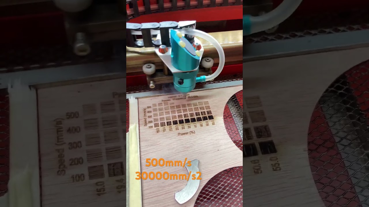

Had same problem with my rdc6432g. Now runs perfectly. File-> device settings-> enable scanning offset adjustment. Than create file for engraving squares with different speed and messure offset and create chart. Make few tests until perfect.
My k40 engraves at speed 500 and 30kmm/s2
Is this the actual acceleration value you’re using?
Yes. 30000mm/s2
I was unaware they these could handle that kind of acceleration.
Mine, with work is 45kmm/s^2. It will also run 1650mm/s confirmed. Great fun, but not practical.
For K40 laser it’s limit 500mm/s and that accelaration on X.
I’m at the moment designing new co2 laser with AC servos, it shoud run at much higher speeds and accelaration of 70000-100000mm/s2.
Here is video
The real advantage of a higher acceleration values is a much smaller overscan. The real limitation is the lps.
Using preview, you can see the overscan and it’s effect for a 40K value compared to a 6K acceleration value. Notice the difference in job time. It spends less time in overscan, more time doing the work.
At 40k there is little overscan. Are you going to profit much eliminating that small amount of overscan?
