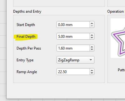

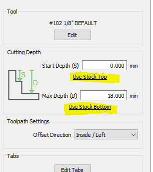

Having the ability to use a variable for cut depth
It would be great on the operation page for the Final Depth allow for the depth of stock to be used.
So for instance if I setup a job I will generally roughly set my depth based on the project, but when I go to the machine I have to double check that thickness with the actual stock I will be using.
If the Final Depth had an option for stock bottom and you update the Project Setup with the new stock thickness value then all operations would now have their new depth instead of having to go back in to each operation and update that value as needed.
A similar variable could be used for the start depth as well.

You can also use percentages though, so if you set it to 100% it will set it to stock bottom
So I gave the percentage a try but the 100% value translates to the current stock depth in the operation. So if I set it at 100% and the current stock depth is 10mm it sets it to 10mm. I then go adjust the project stock depth to 11mm, the operation does not update to 11mm it stays at 10mm.
