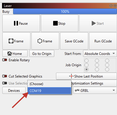

I have to do a fresh install of my S30 pro every morning.
I have to remove my laser from lightburn and then find my device again I don’t mind but |I have to alter my setting in lightburn also.

Once you have added your laser to LightBurn you need to select it in the “Laser” window, and choose the correct COM port in this drop down:
Just needed a driver for the ch340
