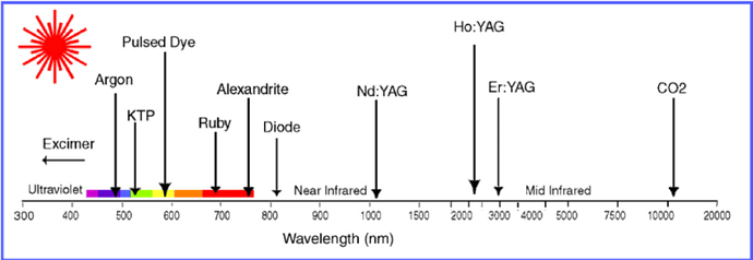

This is the wavelength graphic⦠Yours is a 450nM laser⦠notice itās on one end and co2 is at the other⦠Also, most diode lasers are lower in frequency. Longer wavelength is a lower frequency.
