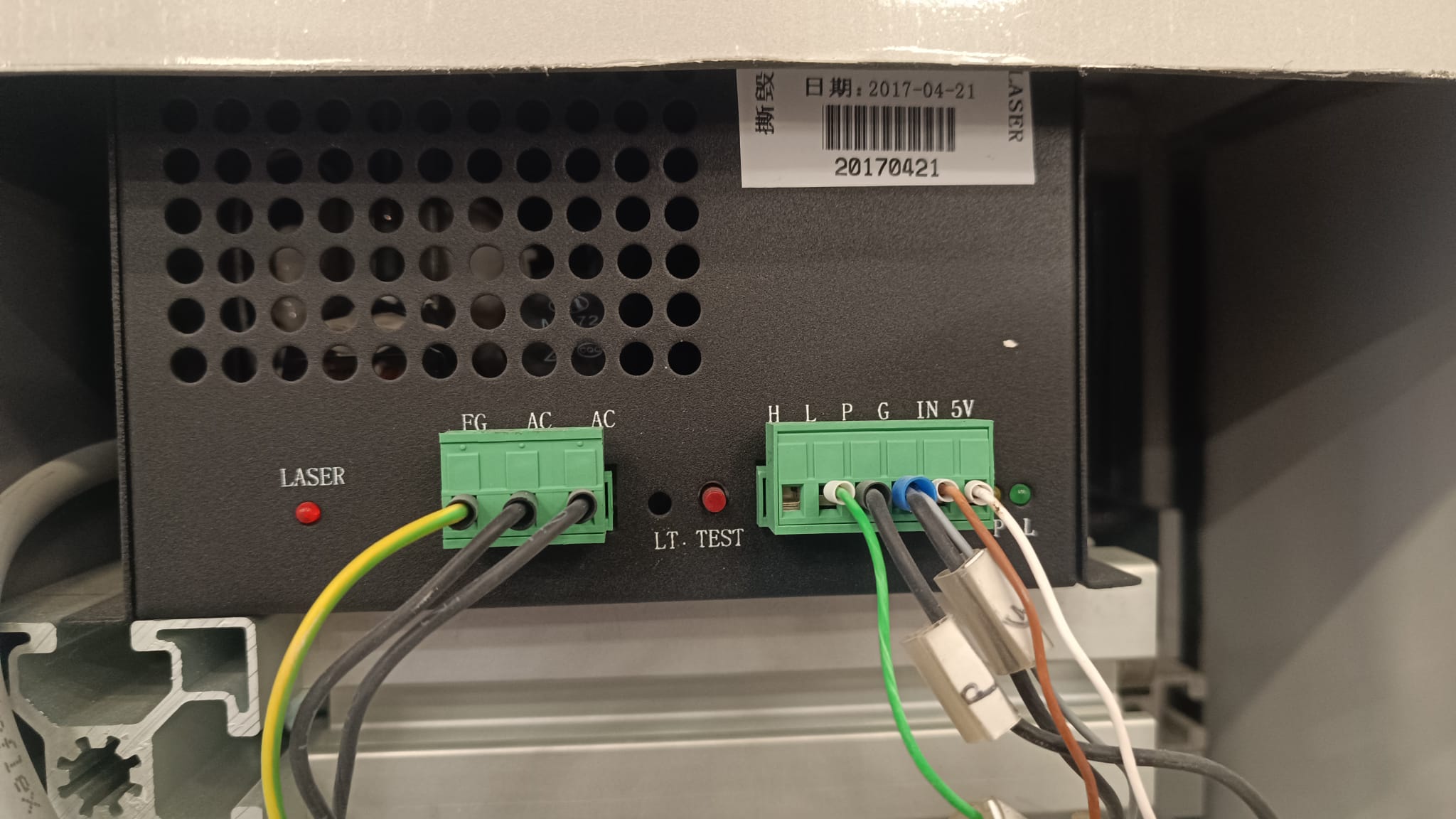

hello everyone. I would like to connect this power supply to a mks dlc32 board. I am not an expert, I have read various links but I can’t understand which is the most suitable procedure. I would like to limit the current with a potentiometer and control the power via lightburn (I would like to make engravings in gray scale). Could someone help me?
potentiometer → IN
Mks DLC32 PWM (S) → L
Could this be ok?
also saw this configuration but I don’t understand how it can be controlled via pwm.

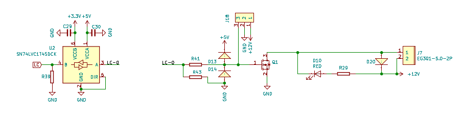

The diagram shows Spindle - of the DLC32 going to L of the lps. This is internally wired to L on the next connector. This is laser enable and is active low.
Here’s how the wiring is on the DLC32 V2.1 – J7-1 (Spindle -) goes to Q1, which grounds L, enabling it to lase at whatever current value you have set by the pot.
In effect, how this works, is you set your pot to maximum current, at least most do. The inverted pwm is used to turn the laser on/off at it’s maximum value, like a solid state laser.
On an led or rf laser you want to run at 50% power, the led or rf tube is turned on for 50% of the time and off the other 50% of the time.
My suggestion would be to use the pwm output of the led module, S, and drive the IN input with pwm. Then the current will be relative to the percentage power setting.

Thanks for the reply. So
you advise me to exclude the potentiometer and use the Pwm directly in IN. this laser is already in operation only that I would like to replace its controller with the dlc32. Since it is used at work I would like to keep the potentiometer because otherwise some people could do damage.

The normal lps has two inputs, the IN which relates to current limiting to the tube and L which enables it to lase at the IN current limit.
If you put a manual control for the IN current limit, the software can’t control that as you’ve overridden the software pwm control to the lps.
The pwm is being used to enable the tube. It is not used to control the tubes current, which is the basis of an analog tube.
An led (or RF) laser is a digital device. It’s on or off. When you set an led to 50% power, the laser is on 100% for 1/2 the period (1/frequency) and off the other half.
A glass tube co2 can run at 50% power continuously as it’s an analog device.
Another way of saying this is, using your 20mA value, that your tube turns on at 100% anytime it turns on. If you have a mA meter, set your machine to 50%, whatever the mA meter reads is only 50% of the true current. Your meter will read 10mA although it’d allowing 20mA through for 1/2 the time.

Actually I had my dlc32 running my China Blue, so I have to disagree.
I stated exactly what you said. The L enables the laser to lase at the set current on IN. If the laser is enable, but the current limit (set on IN) is zero, it won’t lase. That’s exactly how it’s supposed to work.
However, if you want to lase at 50% the only way to do that is to set your pot for 50% … that’s not software control, it’s your hand.
It’s simply do you want to drive an analog device like it’s a digital device or as an analog device, which it is.
