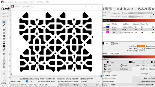

I’m trying to create a template I can burn out of this photo. I only need the center portion bounded by the four circles. I’ve done an image trace and can’t figure out what to do from there.

I used paint to fill the background and retouched it a little
Instead of using the trace tool, it’s not too bad to draw circles and shapes by hand. I also drew a few ‘Mirror lines’ so I can use the mirror tool to get one repeatable corner built.
Circular array:
Turn off the drawing to make sure it’s still looking ok.
drew a little square and one of the middle shapes then arrayed them.
Then copied the top half and moved the copy to the bottom:
It’s a little bit ‘offset’…
But, it should be more square than the original.
preview (fill without border)
preview (line only)
Bingo.

While I was playing around with cleaning up the Image Trace, I too, noticed the symmetry in the pattern, and thought it might be even easier to just manually trace over it, than to expect the tool to pick out the background. (If I’m honest, I did take a couple pieces from the left side and dupe them, rotate them, and slide them into place with the arrow keys - it was easier than doing Node corrections).

cool pattern - help-cropping-an-image-to-make-a-template forum 105639.lbrn2 (1.6 MB)

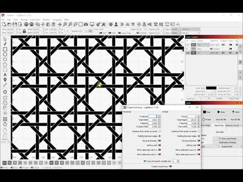

Oz did a few videos on Rattan Patterns. They’re very similar to this (but more complicated).
