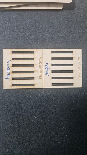

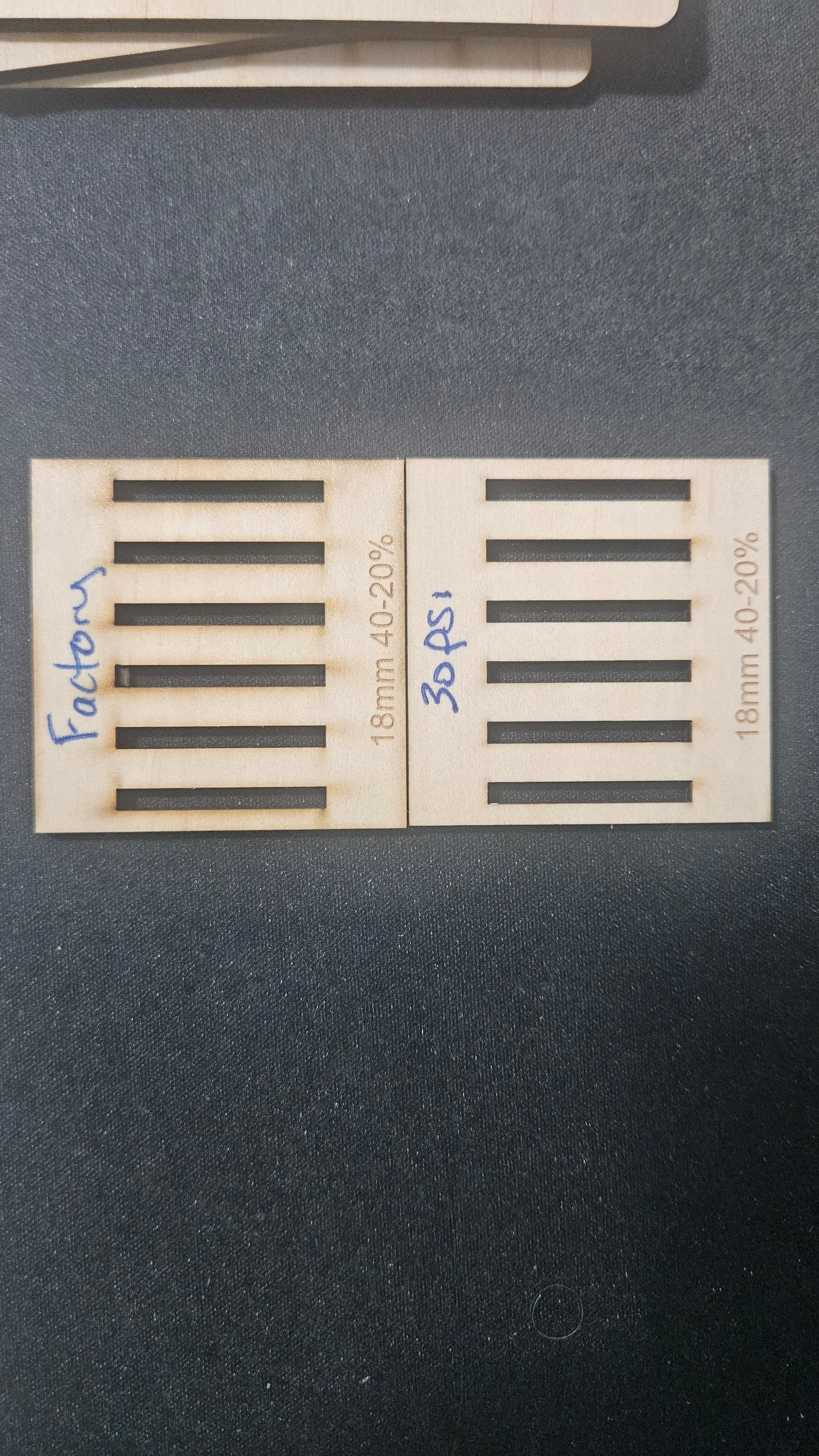

I have an Omtech 2028 60 redblack and I have upgraded the air assist and have trying to get rid of the remaining smoke residue on the top (only occurs in the start and stop position now). I am thinking that I since I am already at 30 psi (8 gal California Air), I would ask for help on prehaps getting the laser to start moving slightly faster so the laser head spends less time in the start and stop point. I have already tried min power settings and that has not helped).
I have included an image of factory vs 30psi for those that do not know how much improvement you can get with upgraded air - worth the upgrade just need to fine tune it a bit right now.

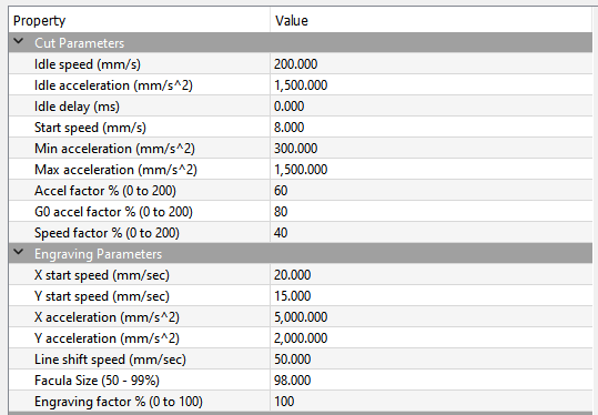

Also if anyone has gotten an Omtech redblack recently would you post your cut parameters so I can see them (got 1 3 months ago that had totally different cut para then my warranty replacement i got 2 weeks ago)
Settings comparison I did for a firmware update I was asked to do before warranty replacement. Start speed was higher on first then on second, as well as Max accel, Accel Factor, GO Accel Factor, and Speed Factor

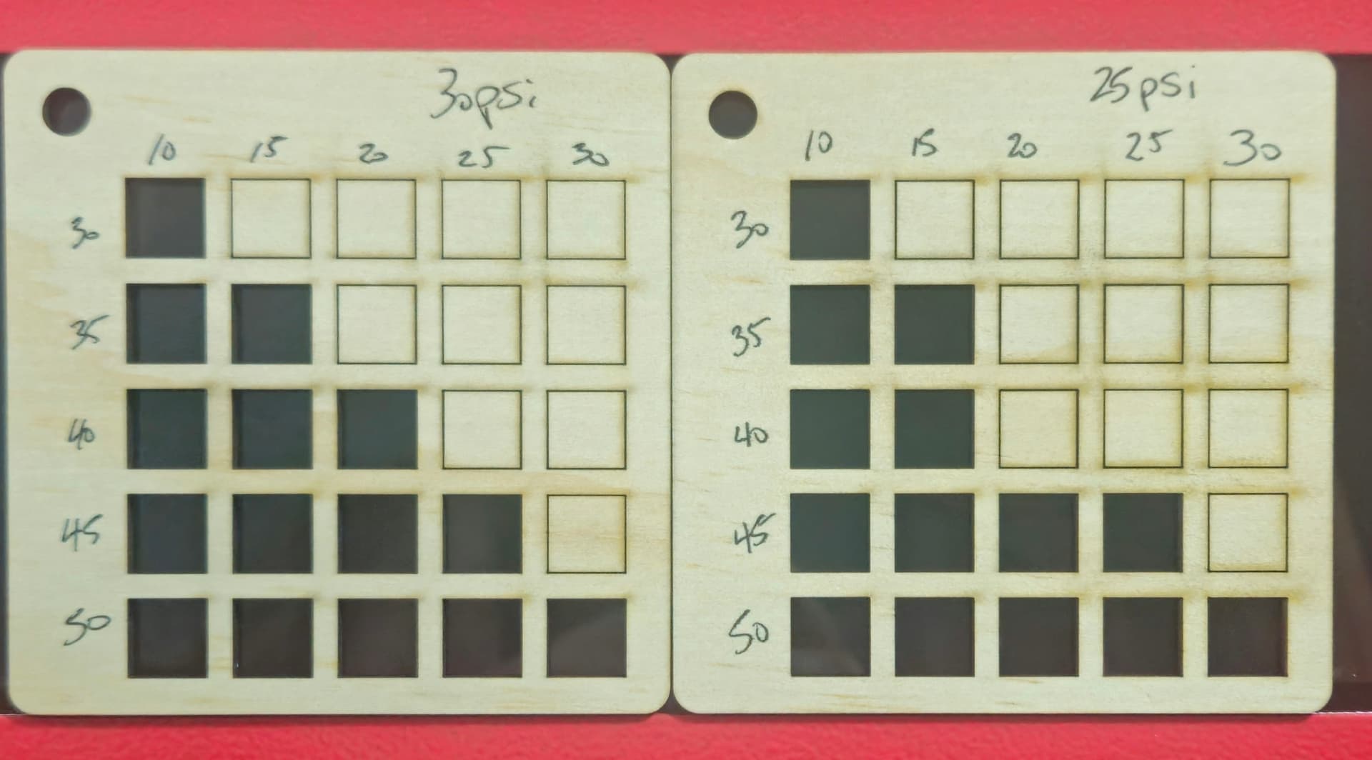

I notice more smoke marking on one axis than the other (X or Y) ? especially on the 25psi cut.
Looking at a similar test cut here I have the same “feature”, mine has more marking on the Y axis than the X. Both on top and underneath.
Question for Lightburn support, is this a software “feature” ?
While I’m not “LightBurn support”, what you see is more likely due to the diode laser’s rectangular spot than anything else.
What does the defocused spot look like? If it’s an oblong shape aligned with the axes, it cuts better in the longer direction and worse in the shorter direction.

As @jkwilborn pointed out, you’re using a CO₂ laser with what should be a nice round beam focused down to a nice round spot that will cut equally well in all directions. I mistakenly thought you were using a diode laser with an inherently rectangular spot.
However, that nice round beam depends on having the laser tube resonate in what’s called TEM00 mode. Failing tubes can resonate in other modes, typically TEM01 and TEM10, with elongated shapes that will cut poorly when moved broadside. More than you want to know about modes.
To rule that out, test the beam shape at Mirror 1 by putting a scorch on paper across the entrance aperture, just as you do when aligning the mirrors. If it’s not a nice round dot like these:
