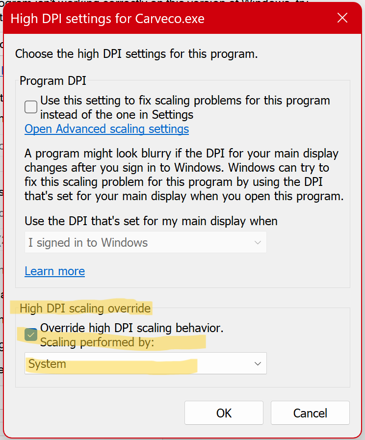

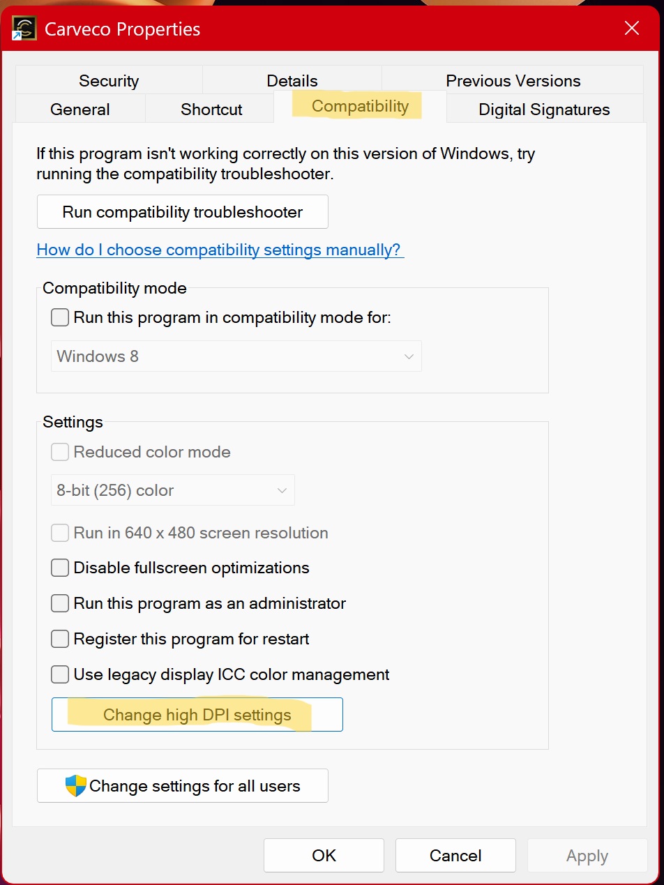

This is a bug in the software that’s never been fixed. It is also in LightBurn. It is a screen DPI issue. The work around is to make a change in the shortcut. Right-click on the short cut and click properties. From there, find the compatibility tab. On that, you will need to click “Change high DPI settings”.
From that dialog box, you want to check the "Override high DPI scaling behavior. And select “System” from the drop down box.
After that, just okay out of all the dialogs. You should now be able to see everything properly.
