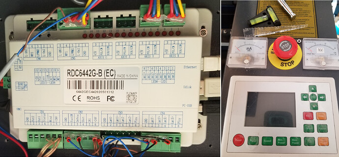

A friend donated a SH-G475 laser engraver/cutter to me (and is now out of the USA for a long period of time working). I am trying to identify it as some google search said it was an OMTECH, but on their site no info is available for it. Trying to get any information on how to set it up, replacement parts and software to use with it. No other markings are available on the equipment other then the product identification tag.

My device has no OMTECH labelling anywhere on the cabinet at all. My friend didn’t provide me with any documentation on it at all so other then using my knowledge and ‘poke’ so to speak at it don’t ave any Mfg docs at all.
Looking at the device it looks very similar to the photo posted except the missing front logo.
Virtually all of these are assembled by some manufacturer and the vendor plasters it with their logo. Most use similar parts many times from known vendors.
Are you using Lightburn? Main thing to know is the controller. So crack the electronics door open an take a photo of it or it may be identified on the label.
If the machine console looks like that in the photo then it’s likely a Ruida. Ruida machines can have different consoles, but this is a common one.

Most of us here have the documents for most of the common Ruida controllers. If you can figure out what you have, maybe we can up the pace for you.
This is my Ruida 6442g and it’s console.
