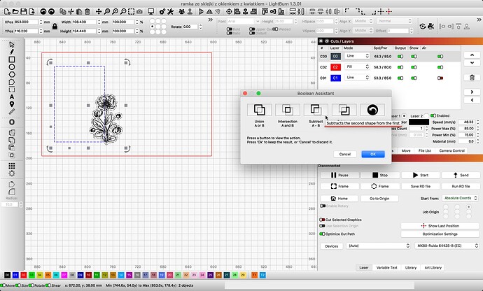

I would very much like advice. Well, I want to cut out a window with a flower in 3mm plywood where the flower slightly comes out of the window (or looks through the window :D). Of course, before cutting out, I want to engrave the flower. I’ve tried a few things but I’m not very good at it. Below is a picture showing what I mean:
The green frame is the one I want to cut out with the flower. It seems to me that I will have to use the offset shapes tool so that the cut does not go on the path of the flower only with a distance. It’s hard for me to find a guide with such … operation on the Internet. That’s why I wanted to write here in the forum. I would be very grateful if someone could show me how to do it, I would love to learn it.

Sorry for my English I am using a dictionary. You can say that i am a beginner lightburn user I understand that I have to upload a lightburn editable file? I’ll try to be more specific about what I mean.

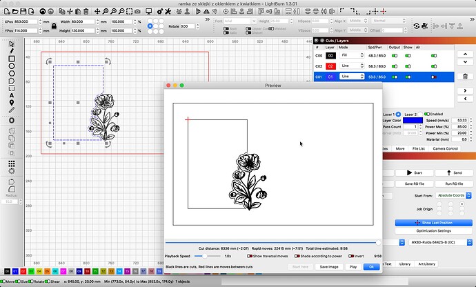

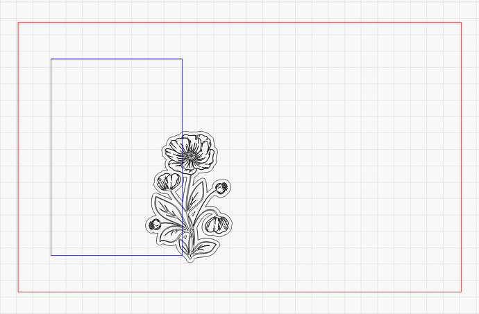

Above is a photo of the entire project and the red line is the total size of the plywood. The blue rectangle in the center on the left will be the window in this plywood.
Now about that blue box. I would like the blue line in line mode to cut out the window together with a fragment of the flower. Only the fragment that protrudes on the outline of the window.
I used the offset shapes tool on the flower. It seems to me that the cutting line could follow the offset shapes line.I hope I explained it clear enough ramka ze sklejki z okienkiem z kwiatkiem.lbrn2 (295.9 KB)
I uploaded the .lbrn2 file. I would like training in this operation, I would like to learn.

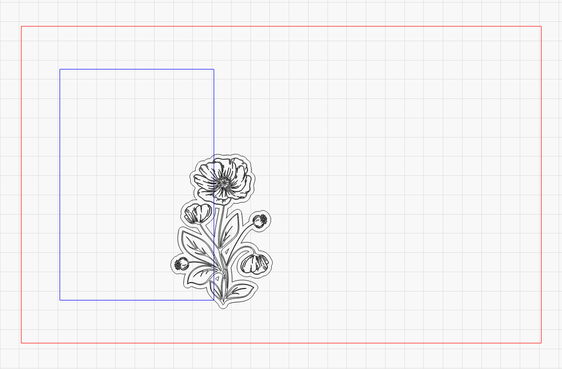

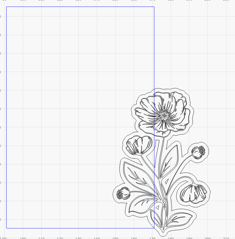

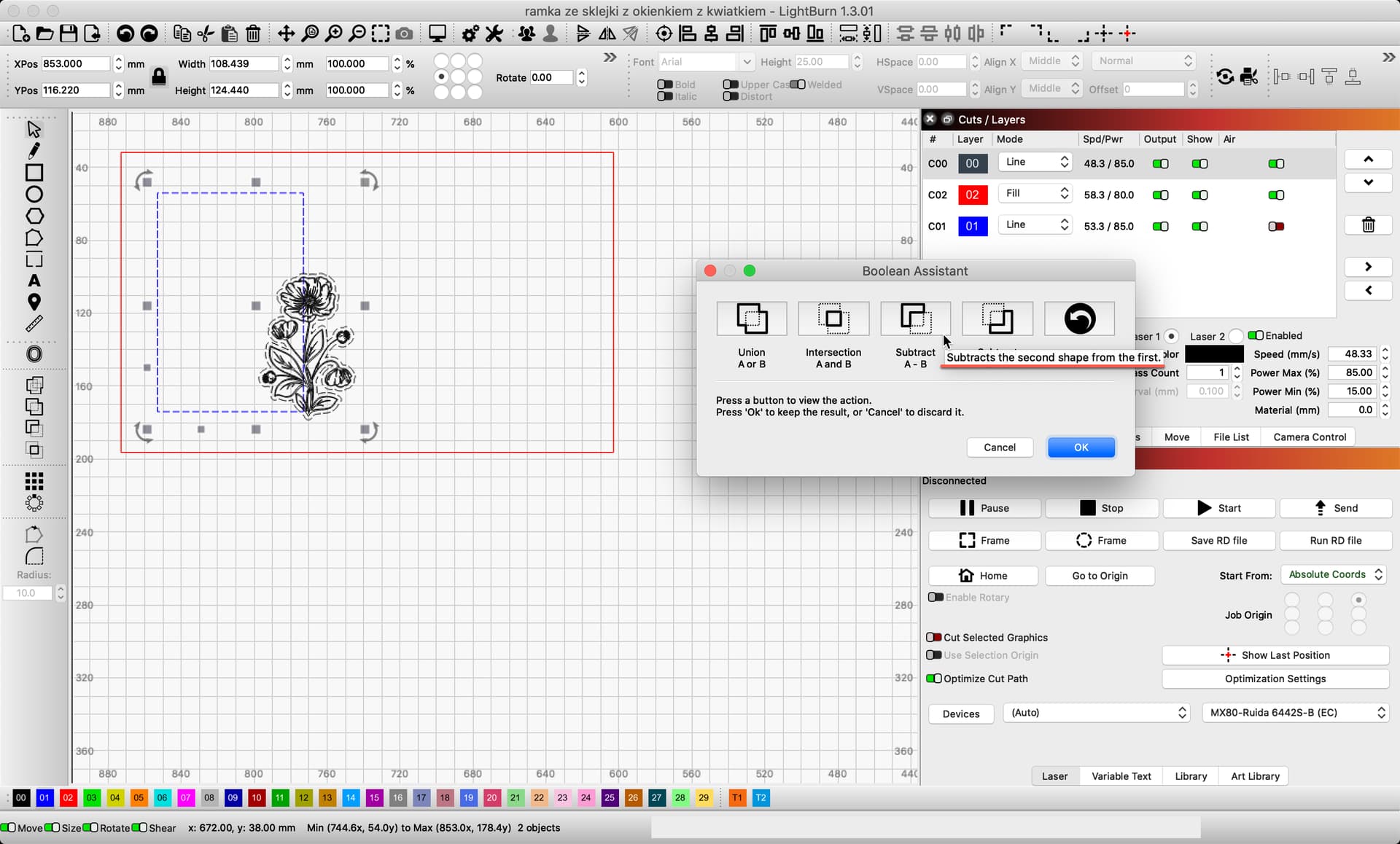

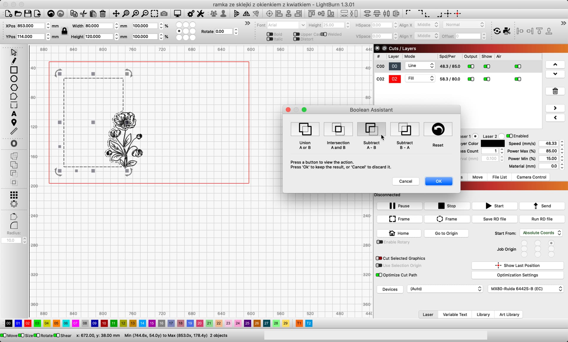

I selected your blue rectangle and then the offset shape to the flower. Then use the Boolean Assistance to see what each operation will do prior to committing this change. I then choose the Subtract A-B to modify and combine the offset and rectangle shapes as shown. I then changed the layers to produce as shown.
I read it as the opposite of what you did, ie they wanted the offset to be added to the outside of the flower and not included on the inside area. But then I look at the first example and it looks like there are also words engraved on the clear area to the right of the green frame in the ‘example’.

*** Yes, the offset command to establish the cut boundary and boolean subtraction to remove the offset from outside the window.
