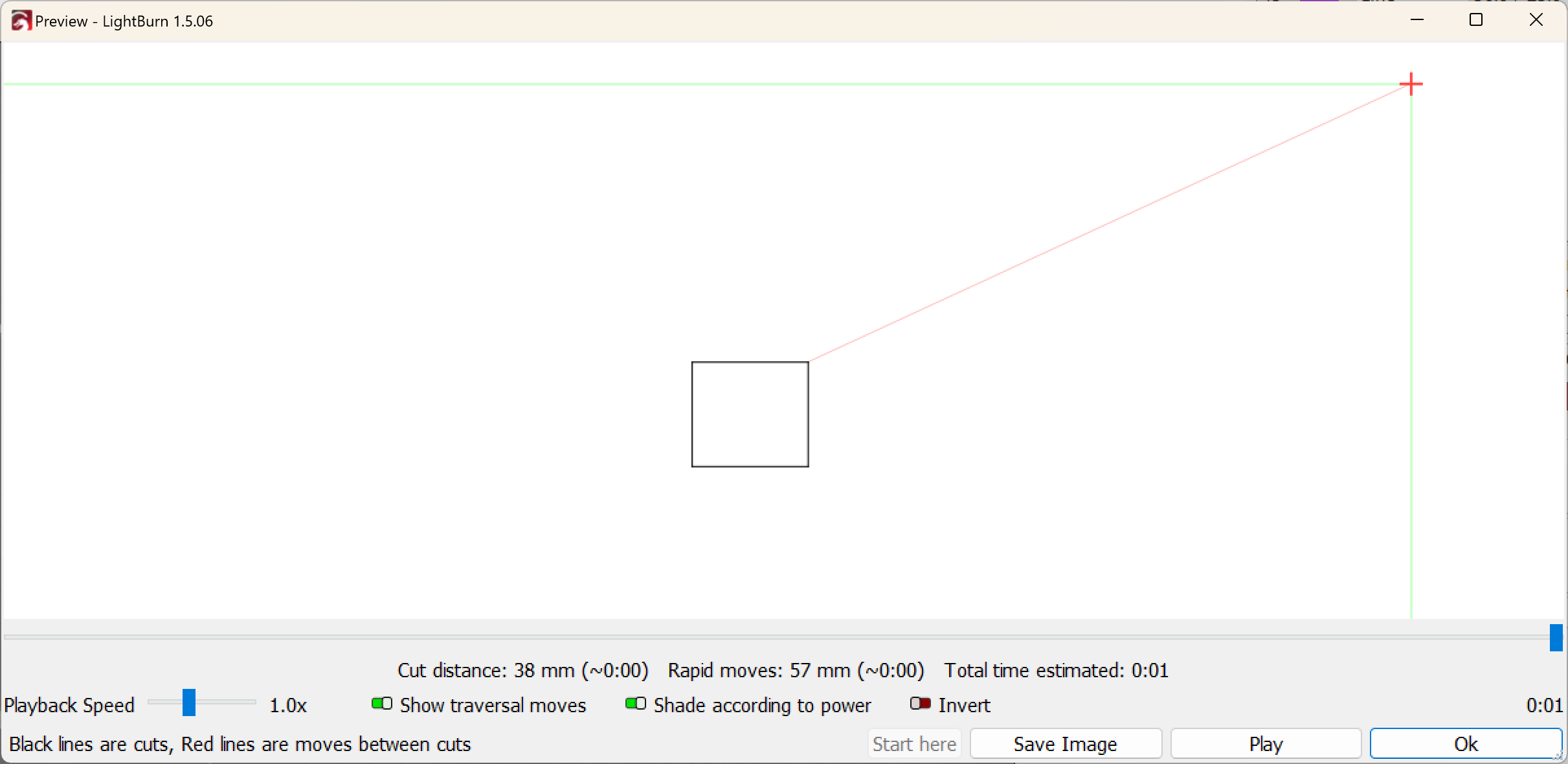

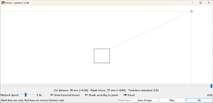

  • The Preview shows the proper job path and animation (image available below). So the path is set to cut and it’s in range of the laser.

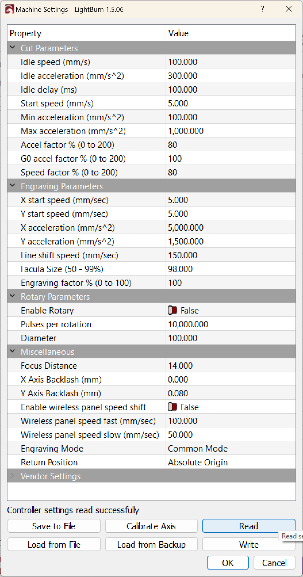

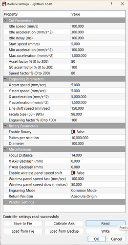

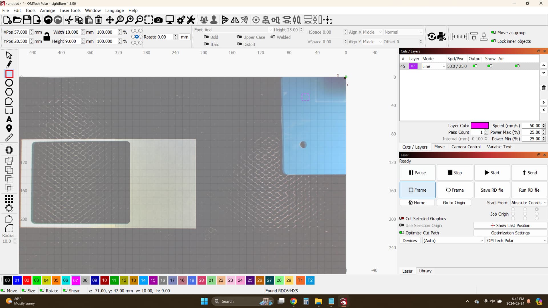

General Settings - small magenta square (07) in the upper right corner is my test cut:

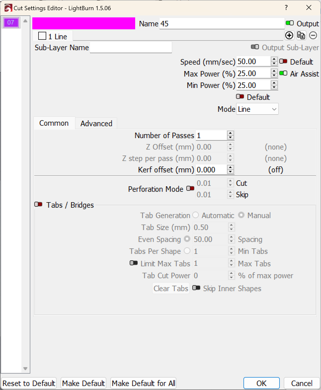

Detailed Cut Settings:
Machine Settings:
Preview Window:
