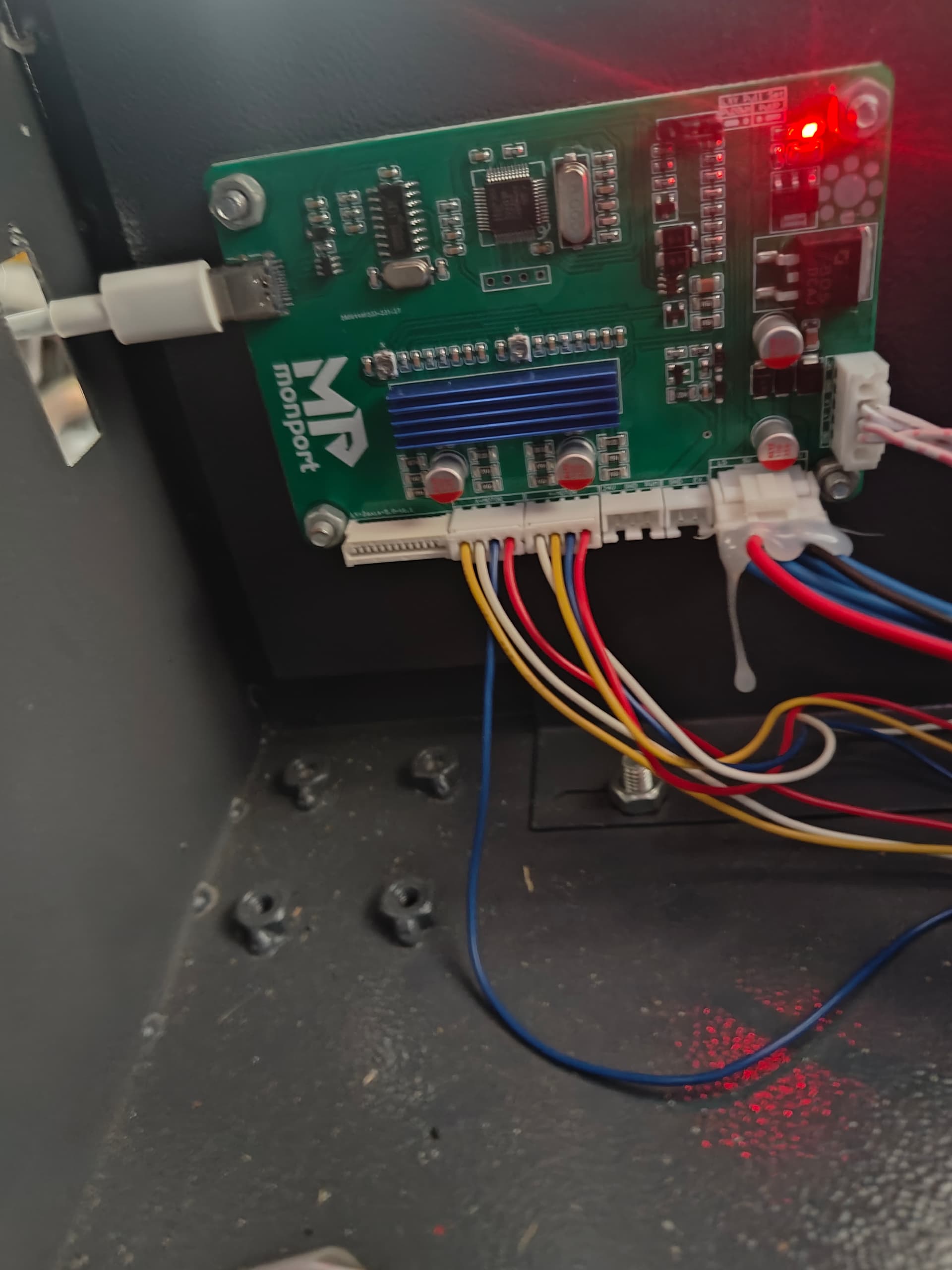

Hello, I have a k40 running lightburn. I’m marking wood and the start and stop points are much darker than the middle. How do I correct this? Also, my K40 is still the one that decides the power level not on lightburn.

What controller are you using?
If this was a GRBL machine i would say to NOT use GRBL M3 but the TOP GRBL
seems youa re in M3 mode where there is no modulation of the laser
By your controls seems you running a M2/M3 board?
I’m using the Monport GRBL Nano 2.0 2 Axis-5.0. Is there a setting I need to change?

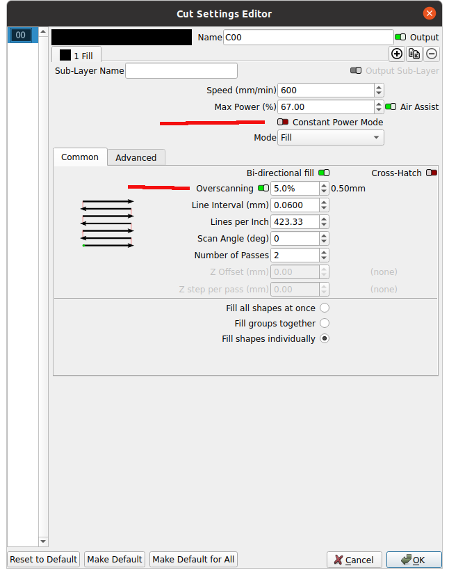

This has the look of overscan not being adjusted. As it slows to stop and change direction it should change the laser power. If it has enough overscan it would be up to speed by the time it encounters the time to lase, if not it will be more burnt near the ends…
Are you using overscanning and/or set to constant power mode?

Of course! So there was two issues.
Since I had an image and a vector, both were set up on 00 (black) and LB was trying to hit two different settings which caused an issue. Once I changed the vector to 01 (blue) it was way better.
The other was my over scanning was wrong, I changed the % and now its PERFECT!
