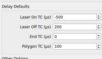

Hello, Would you mind advising what would buse a good Laser On tc (US) mine is currently -100 Laser off is 150 End tc is 100 and polygon is 100. Thank you

I believe every galvo is different and these delays need to be tuned for your galvo.
This is a good video from Laser Everything on setting your delays.
It’s the other way around.
A negative Laser On TC means: The laser turns on before the galvos start moving. Too low of a value will lead to a burn-in at the start of a line.
A positive Laser On TC means: The Galvos start moving and then turn on the Laser source.
The Laser Everything video is a great resource!
There’s also this one on the topic by MakrTheory. His calibration file makes it easy to calibrate the values.
This seems to work OK, using the Laser Everything timing/delay video. Are you saying it’s a problem?
I think the configuration sent with the machine (markcfg7) has -400 here instead of -500 for Laser On TC.
No problem. The Laser Everything video is a great resource with more detailed explanations.
The MakrTheory one just makes it easier to calibrate with the linked calibration files.
Yup I was backwards when I replied, my apologies
