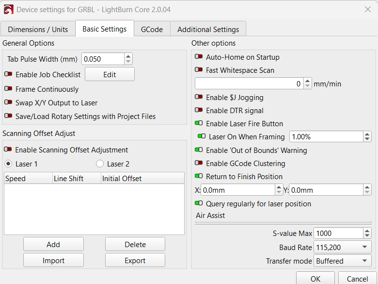

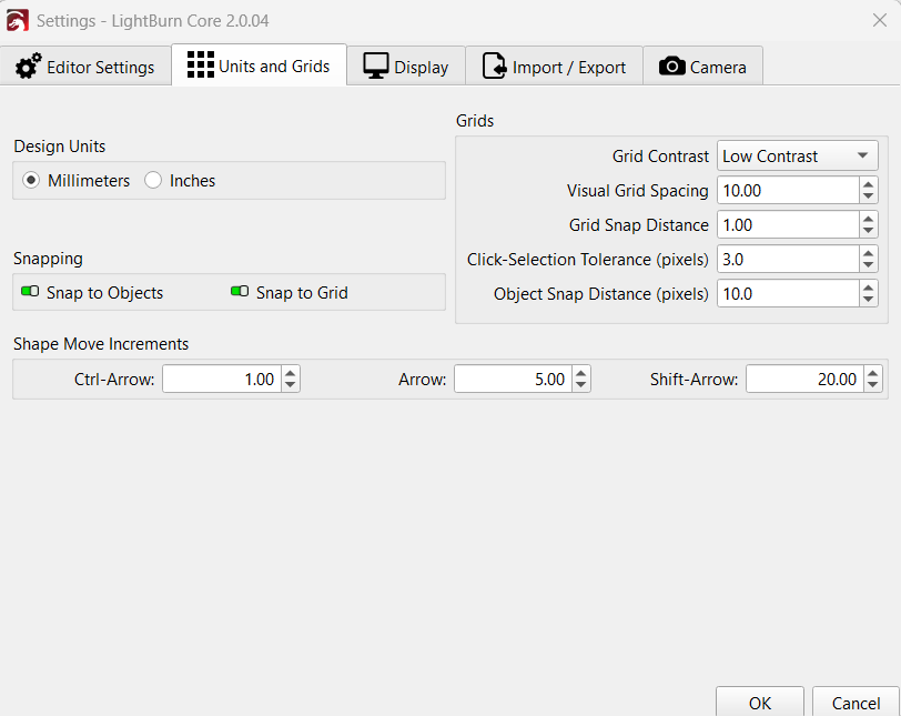

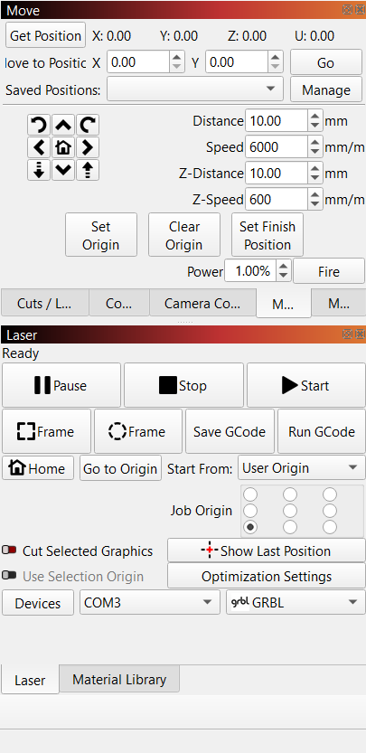

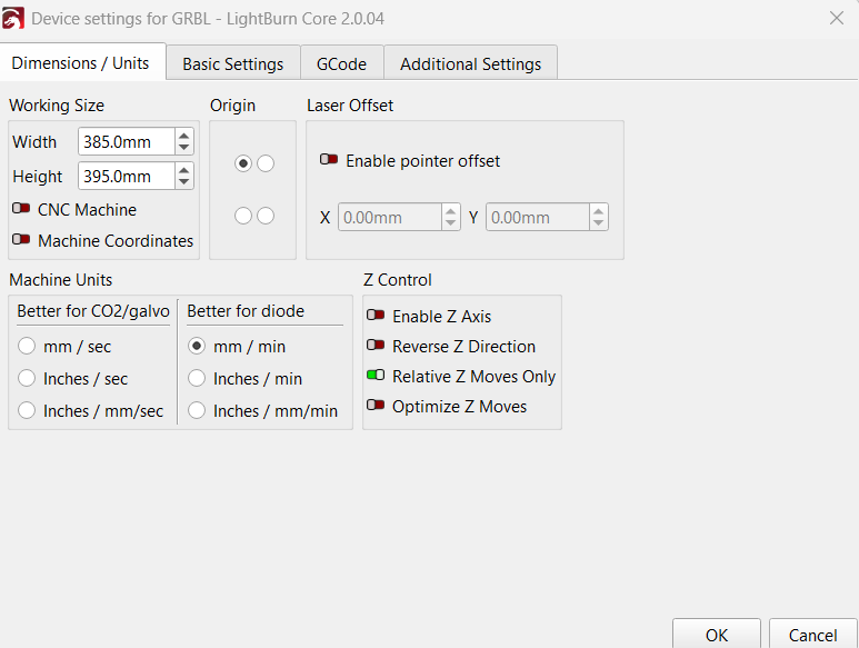

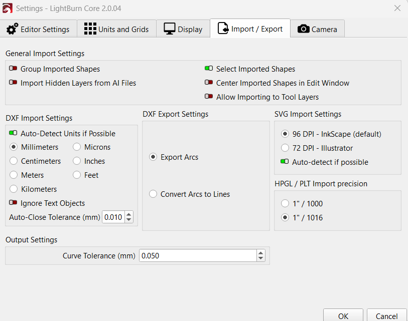

See the attached screen shots of all my settings.

A few things look unusual in the settings:
-Does that machine auto-home? It looks like you have homing disabled? $22=0
-The device origin is back left? That is odd, normally is front left for Atomstack.
-The speed and acceleration settings in GRBL (110-122) are very slow/conservative, (which is probably fine for now give the problem you currently have).

I also adjusted my origin to go front left like you suggested, and I went ahead and turned $22 homing onto 1 so it homes properly.
