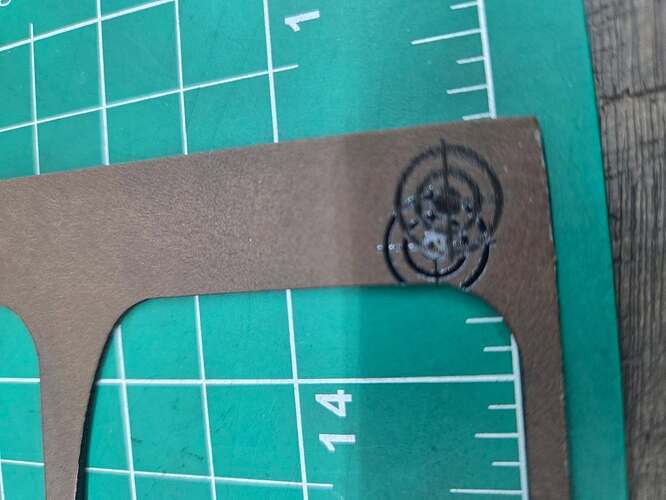

I recently purchased a UV printer and I’m trying to set up a reliable print-and-cut workflow with my laser, but I’m completely stuck.
My laser is a red and black 60W 500x700 Chinese CO2 laser from eBay running LightBurn. I’ve been fighting this issue for over a month now and I’m wasting a lot of time, material, and money trying to get these leatherette patches cut correctly.
Here’s what’s happening:

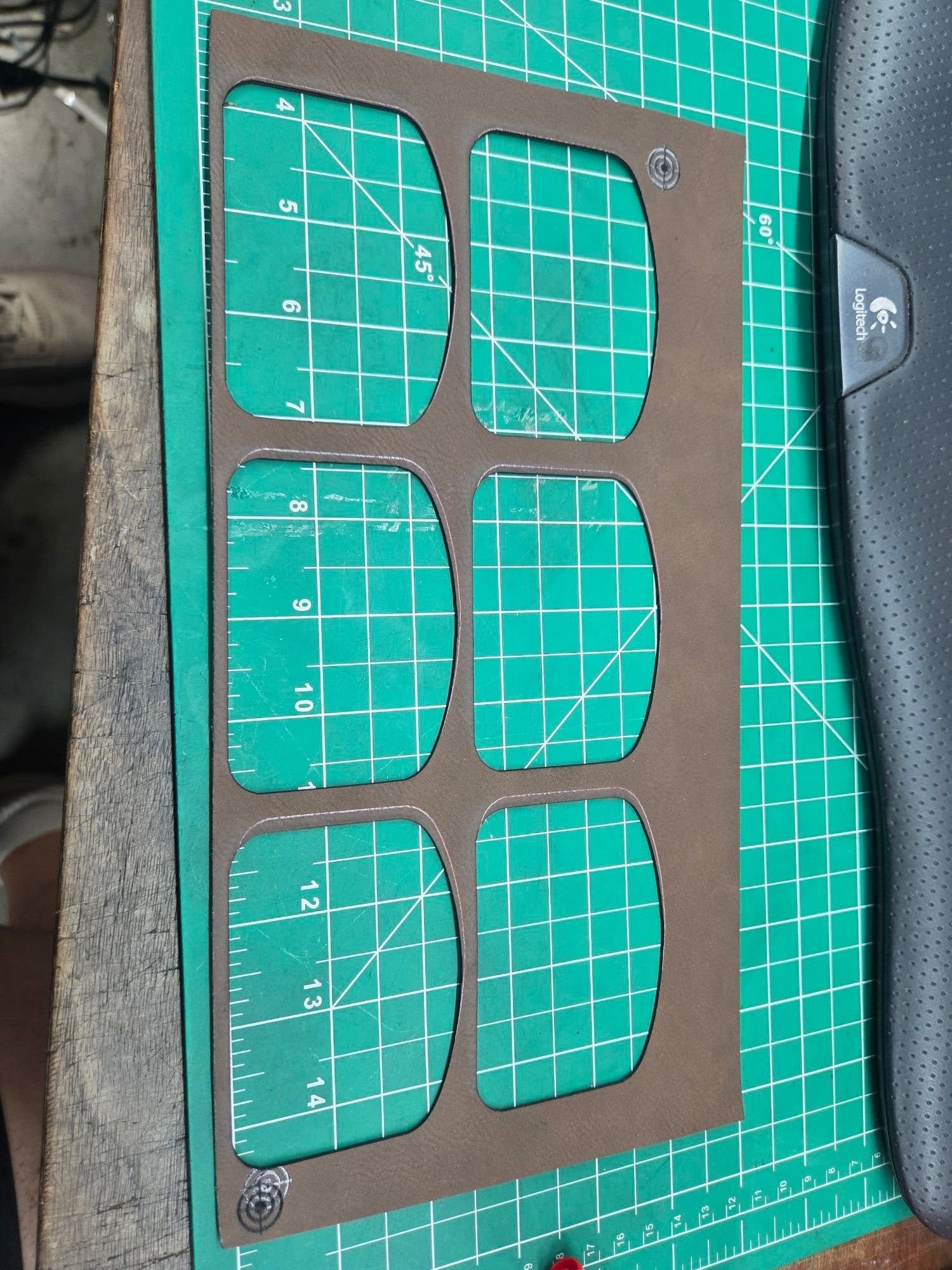

I am laying my leatherette sheet in the upper left hand side of the bed. When I set up my registration targets in the upper left area of the sheet, I can get the target almost perfect by using 1mm jog movements and the pulse button. But when I jog over to the next target, I notice the laser always lands to the right of where the printed target actually is on the leatherette. I continue adjusting it 1mm at a time and pulsing until it visually lines up.
The strange part is when I actually start the job. It looks like the laser should be cutting inside the printed outlines, but the cuts end up nowhere close to where they should be.

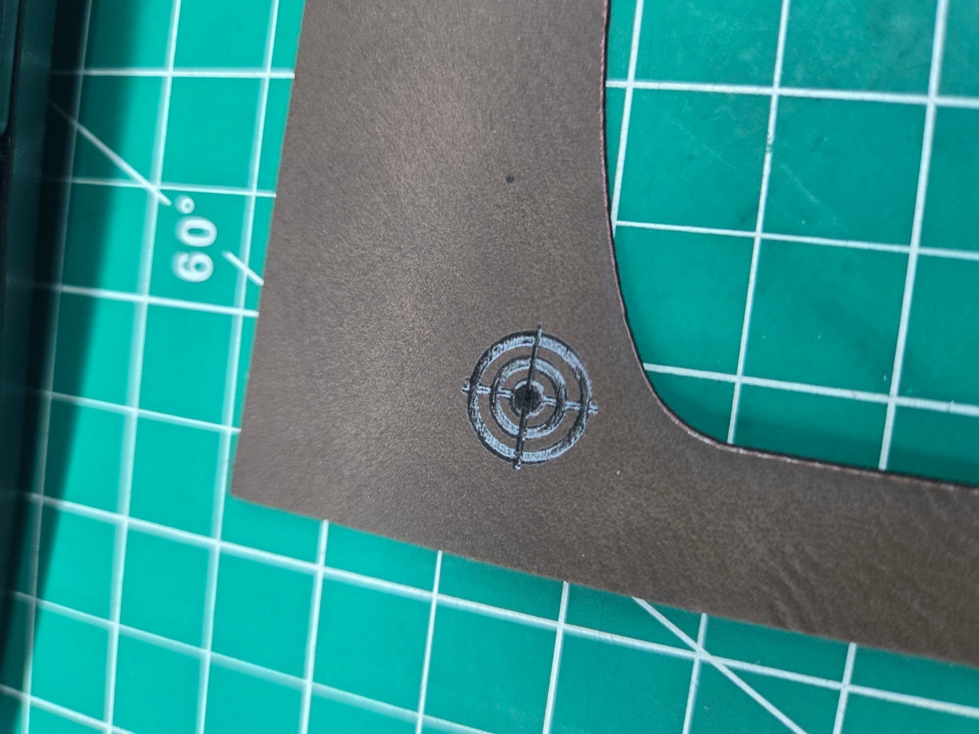

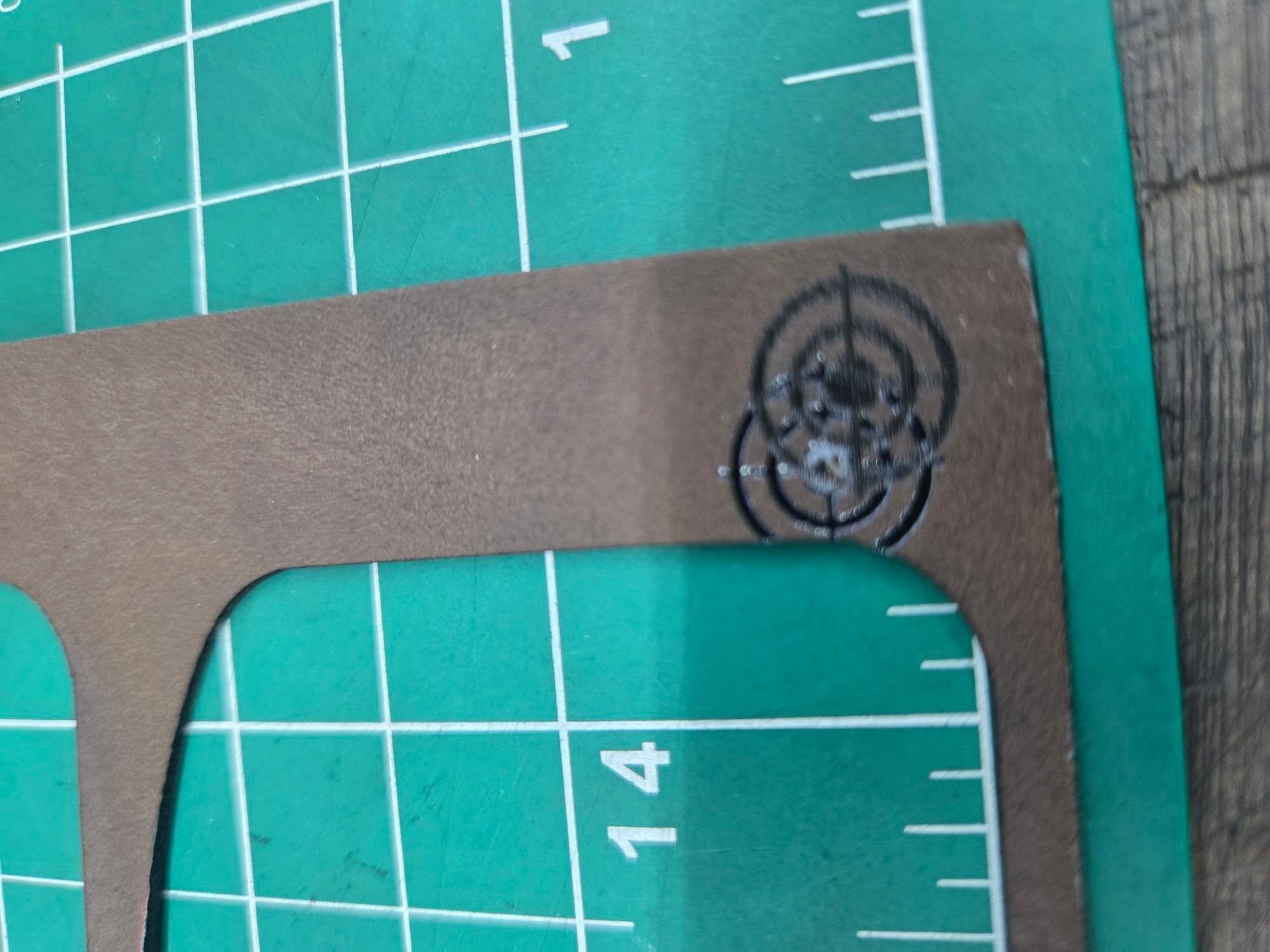

To troubleshoot, I changed my workflow and had the targets engrave after the cut so I could compare the alignment. The top left target engraved perfectly, but the bottom right target engraved about 5mm to the right and slightly lower than the original printed target.
I have already calibrated the X and Y axes in LightBurn multiple times using a 4x4 inch square test cut. Even after entering the corrected calibration values, absolutely nothing changes.

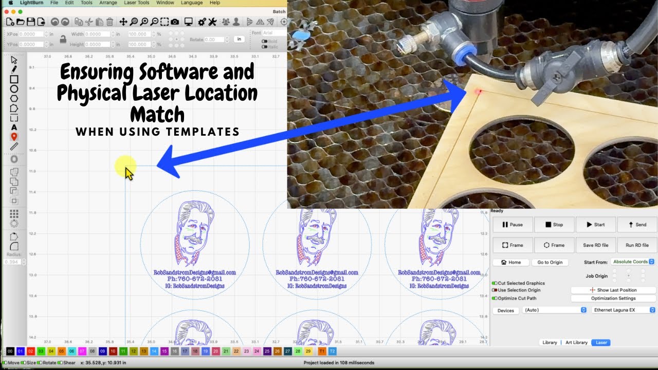

Perhaps, always using “Absolute Coords,” create a template system where you place the pre-cut pieces and center the engraving as needed.
A template that could be fixed in some way, always guaranteeing the same position, with the cuts filling as much of the workspace as possible, and arranging the engravings (in Lightburn) as needed.
I have some difficulty explaining exactly what I mean, but there are plenty of examples of this here.
I’ll leave this video as an example.
I believe it will work even better than the print and cut function.
In my opinion, this function is more intended to complete a job that has to be divided into several sections because the dimensions are larger than the workspace.

I set the Ruida controller’s manual step size to 0.2 mm, use its Fast/Slow button to scoot close to the printed target, then make teeny steps to align the dot at the center; it seems easier to do all that on the machIne’s display than long-reaching to the PC’s keyboard.
You must also verify:
  • The red-dot pointer is coincident with the CO₂ laser beam at the focus distance
  • The laser is focused on the surface of the material
  • The material is flat so everything is at the focus distance
For critical items, I fire a test pulse after aligning the red dot to the printed target:

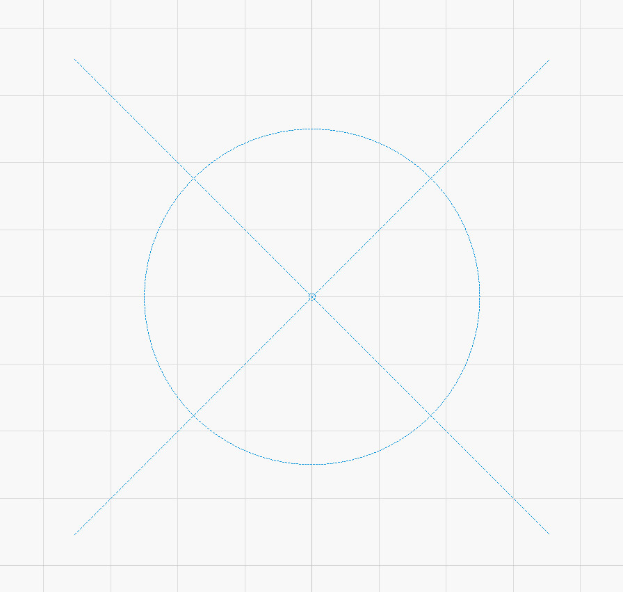

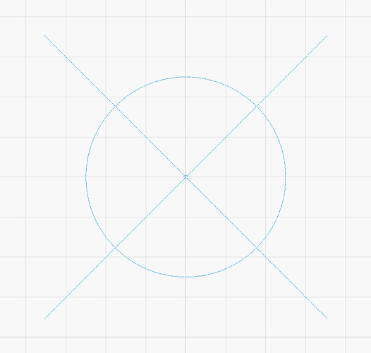

You may get better accuracy with a less-chunky target. I use a vector cross, rather than engraved bars:
That pattern produces the target printed on the paper, although the inkjet-printed lines are much thicker than the vector pattern in LightBurn.
All of which seems is incredibly tedious, but most of it is once-and-done setup. I’ve found I must be grindingly meticulous about everything, because Print-and-Cut has absolutely no sense of humor and will convert “pretty close” accuracy into totally wrong results.

Yeah, that’s part of the problem then. If you have any scaling difference between the two devices you’ll want to use the “with scaling” option.
It’s important to understand that you might not be intentionally scaling them differently, but the devices themselves might not be calibrated identically, which is what the “with scaling” option is intended to fix.
Fun fact 1: inkjet printers have different “calibrations” along the X and Y axes.
Fun fact 2: The Y axis “calibration” depends on how good a grip the feed rollers got on the paper.
Fun fact 3: The paper can roll through the printer at a slight angle, misaligning the pattern with the axes.
My decent-quality Canon inkjet prints images just slightly too large along both axes. Scaling X by 97.0% and Y by 97.9% made the printed pattern line up with the engraved holes:
Across the width of the card, not correcting that 3% error produced a brutally obvious 5 mm offset. :frowning:
