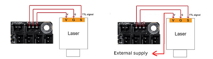

I don’t know how electronically adept you are, but on my machine I just passed a new wire through the existing drag chains directly to the laser head. This bypassed the 12V that was supplied via the control board.
I had an old mount that fit an existing connector. The supply powers both the controller and the laser. Single connector makes it easy to move it around if I need to…
It really depends on your electronics ability…
This is the change… maybe it’s more clear. On the left is the original, on the right is the change…
Make sense?
Thank you for the input and it’s worth trying when my laser arrives☺
