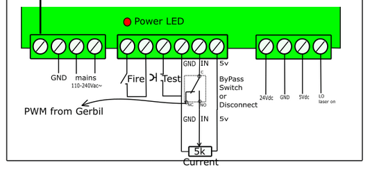

The advice from Monport is to remove the pot by using jumpers.
I am awaiting to hear back if my wiring is preferable as the recommended set up causes the laser to fire on startup according to a guy on YouTube.
ChatGPT is adamant on this. To create a hybrid set up by connecting the PWM wire to the L on the PSU and GND to G
And to stop the laser firing at start up, find the invert laser / active low setting and flip it.
Google AI says inverting the signal would require complex coding or a hardware fix on the PWM line using a ‘shifter’?

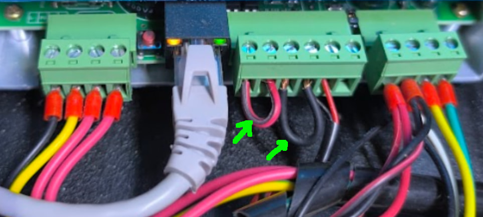

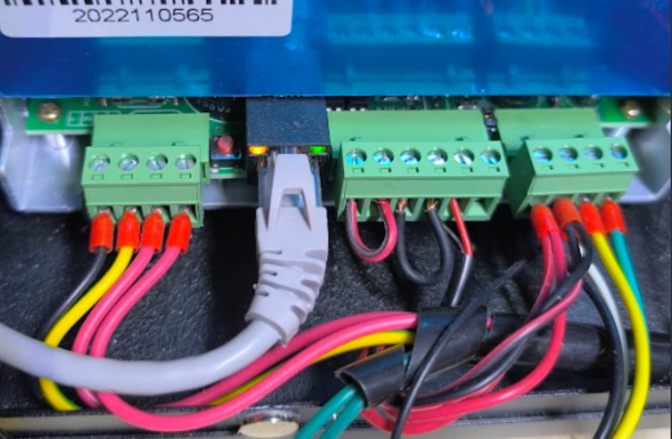

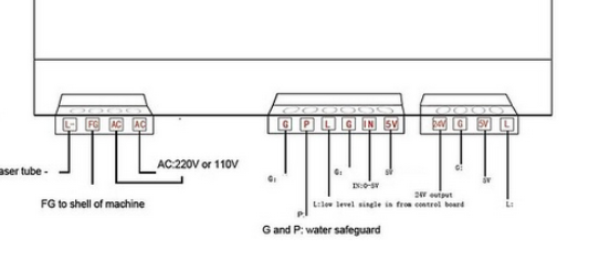

You have it wired to lase anytime the pwm signal is present. The IN of the lps expect either a dc control voltage or a pwm that produces the same voltages.
You have all the interface controls wired for it to turn on. The P is for water protection and the L is laser enable.
You also have a knob that’s plugged into the lps, which isn’t standard, so I don’t know if the schematic with the pot is valid for you.
You have both L and P grounded. Do you have a voltmeter? check the pwm voltage when it’s powered up, remove the ground strap from P and L and put switches on them as this photo implies.

Sorry. Didn’t mean to annoy. I’ll stick with my current set up then, with the pot wired in. If it shows any inconsistencies I’ll add the switches instead as suggested. Cheers for your input. :slightly_smiling_face::+1:
The previous post shows your front panel pot plugged into the supply, at least that’s how it appears. Is that how yours is?
:grinning_cat:
Yes it is. When it’s set at minimum I get software control of power between 1% and 50% producing 2-3mA to 15mA
