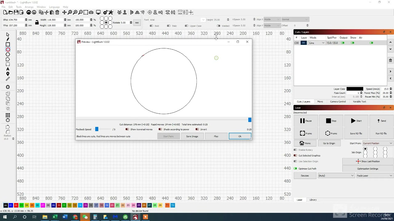

If it’s a shape like the circle, you can apply a ‘lead in’ to have it start inside the circle. The makes the burn on the scrap, assuming you want the hole and not the cutout… you can select either.
Thanks,didnt know about that.This might be problem for that :slight_smile:
The software is generally pretty smart and figures out what is inside and outside of an object.
