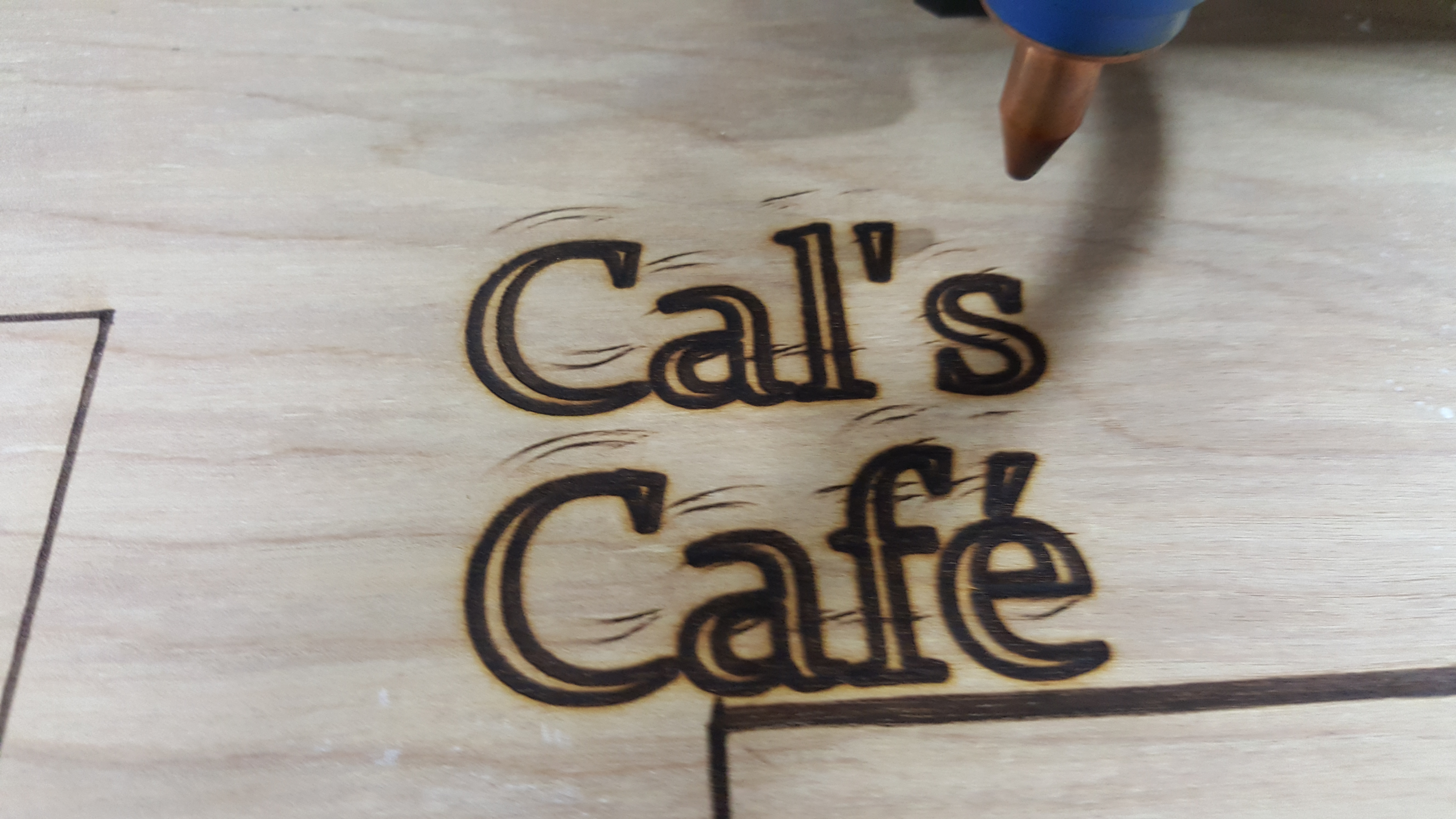

So I am finally getting my Chinese laser machine up and running and resolving the many issues to repair what was a brand new laser machine.
The issue I have currently is the engraving keeps missing or jumping. Please see the photo. Has anyone any idea of what I need to do to correct this?
I have a RUiDA RDC6332G controller and of course the latest version of Lightburn.

It looks to me like your “Y” axis maybe off (top to bottom). I am sure someone on this forum will have some other ideas on how to fix this too.
It looks like a “missing” tooth in the timing belt, or that the axis is skipping somehow. Can you drive a large square at different speeds without it happening?

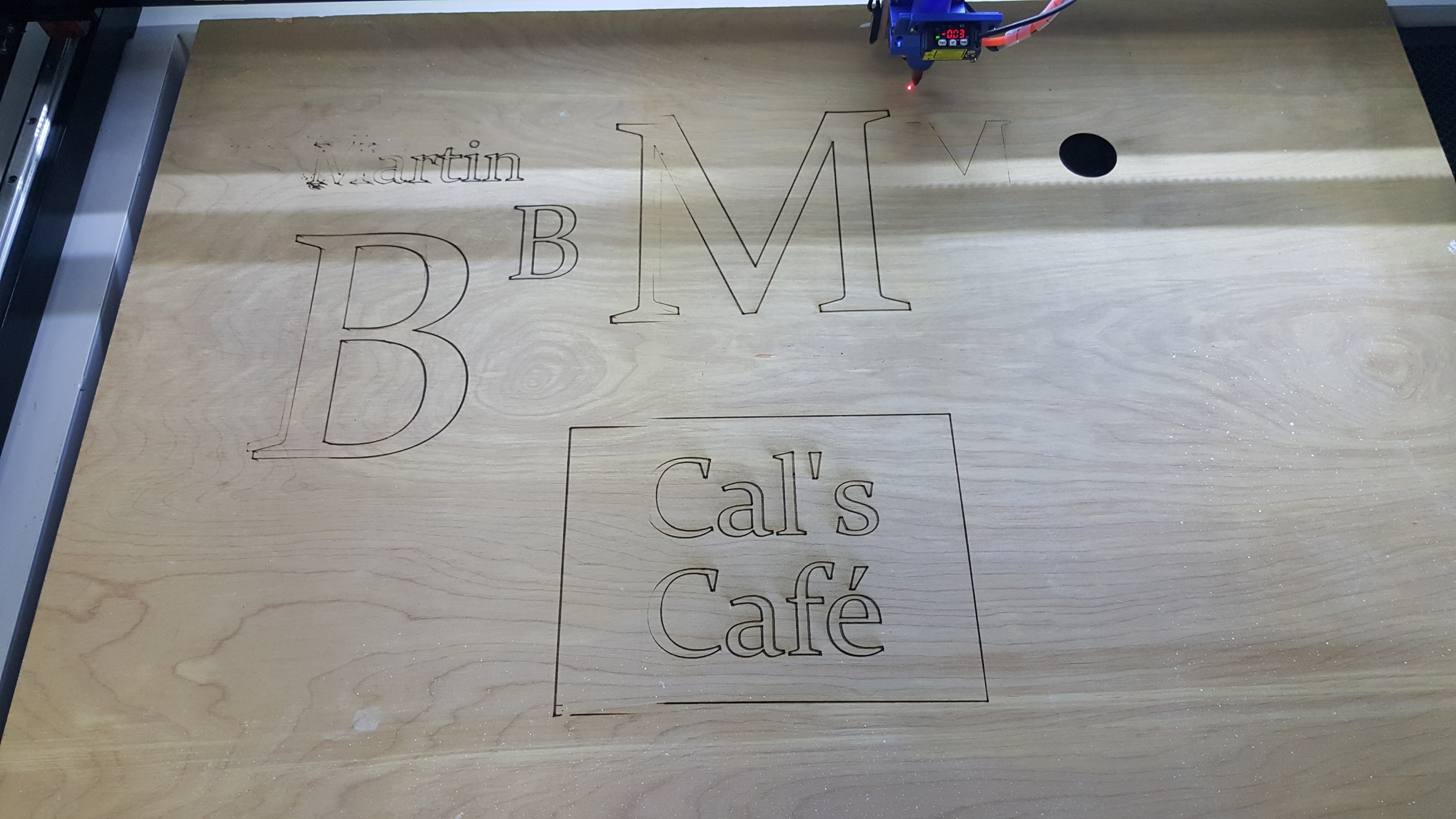

So I have adjusted ‘played around’ with Mirror 3 because I have noticed the laser beam spot does not seem to drive straight down at 90 degrees but off centre (see video https://flic.kr/p/2koDobJ ). Have no idea why this is happening and my adjustments have made no improvement. The square (see image) now has the issue on the right side and there is definitely something wrong with the laser ‘spot’ since it is now broader along the bottom and top.

mysterious, but I also think your laser beam is very wide at the bottom, or is it misleading in the photo? in the top square the lines do not seem so thick.
… and of course you have checked the lens itself, no stains or defects on the edge either … and it is not loose…

I have changed the lens and the spot is now more centralised. Still having some interesting effects.
Not sure why I now have this ghosting effect?
Lines are complete but still some uneven patchiness.
Martin, could it be reflections from the inside of your nozzle? Can you do a focus test, lowest and highest point of your Z (bet) to see if the two points hit the same spot?
Yes, very possible since the nozzle is polished metal. The spot ‘pulse’ is very clean now since I changed the lens (and have installed it the correct way up - flat side pointing down to the work surface)

You need to do a ramp test, it is necessary to determine the exact focal point of just your setup. There are many videos on youtube that explain it better than I can, but it is very simple, you make a line in LightBurn, for example 200 mm. On the laser bed, place a piece of wood at an angle, approx. 20mm in height difference between the ends. Now you burn the line with moderate power and about 800 mm / min or whatever suits your machine best. The point on the line which is the finest indicates your best focus. Measure the distance from this point to the nozzle and you can compare whether the supplied gauge fits or whether you should make a new one.
But, that’s not what I mean when I say that you have to find out if your laser beam breaks in the nozzle, here you have to drive your bet all the way to the bottom, make a shot and raise it to the highest possible and shoot again , here there must be no difference, i.e., they must center both.

So I have made adjustments to the Z-Axis as suggested, and this has solved the issue of the ghosting/double impression. I managed to laser engrave some wood, and the result is okay. But I need to have a smaller laser spot since my main aim is laser engraving photos.
