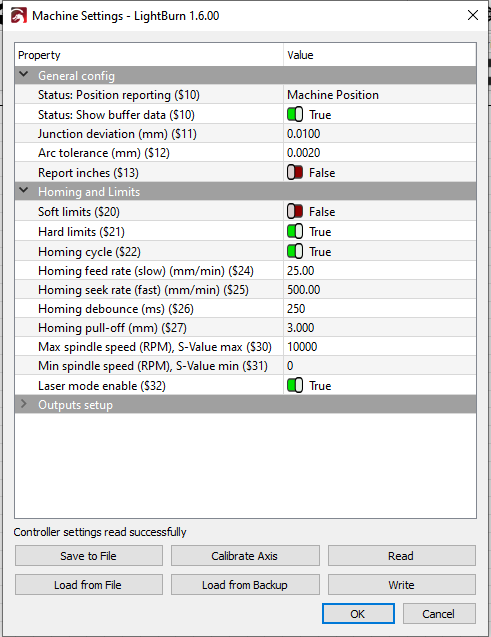

GRBL Settings:
$0=10
$1=255
$2=0
$3=0
$4=0
$5=0
$6=0
$10=115
$11=0.010
$12=0.002
$13=0
$20=0
$21=1
$22=1
$23=0
$24=25.000
$25=500.000
$26=250
$27=3.000
$30=10000
$31=0
$32=1
$100=160.000
$101=160.000
$102=160.000
$110=2000.000
$111=2000.000
$112=2000.000
$120=300.000
$121=300.000
$122=300.000
$130=420.000
$131=310.000
$132=110.000
ok

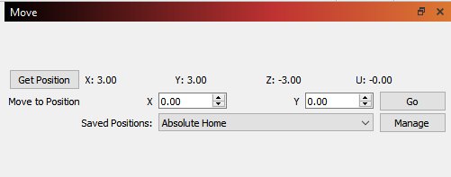

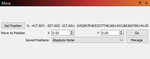

Do your jog controls move correctly?
When it is in home position, and you press get position at top of move window what does it report?
Jog controls appear to be working correctly. When I press left it moves left the defined amount (10mm).
Get Position Home

You will need to change this to $10=0 so that your machine reports Work Position rather than Machine Position.
After you make the $10 change the MPos here should show as WPos and should read something in the range of 420, 310, 110 based on your offset. In actuality I think it might be offset by 3 mm for each axis based on your pull-off distance.

And this is now the result after changing the $10=0 value
Work Position

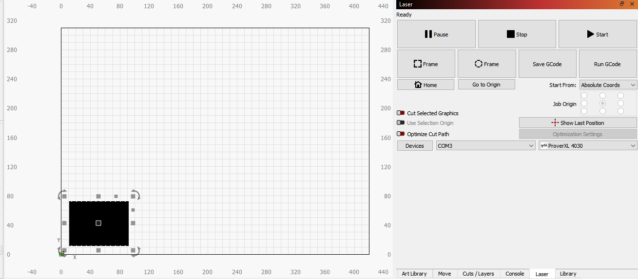

I created a 400x300 test square and it now frames it out without running into the limit switches.
However when I put the object in the bottom left as shown, the laser moves to the back right and frames it.
Seems like the software workspace is reverse to what the actual laser work surface is.
Another example is if I set laser position by clicking, let’s say top right in the software, the laser moves to the bottom left.

Looks like setting the origin back to the rear right corrected the issue. Jog controls are now working correctly, set laser position is working correctly, and if I create a project the same size as my workspace, it will frame it without hitting the limit switches. Also frames the project using the absolute coordinates as it appears in the software.
