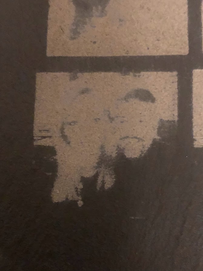

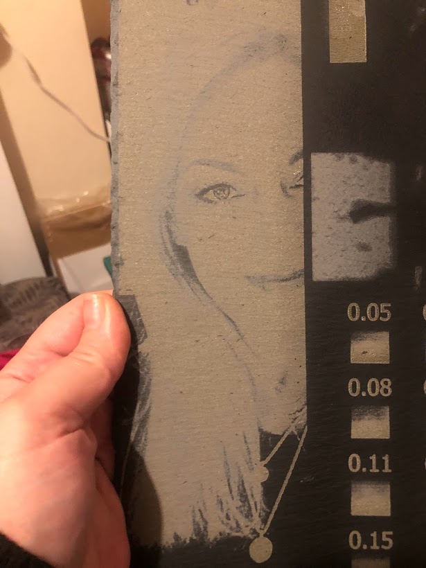

My photographs are coming out just very flat with no gradient. I’ve attached two so you can see. I’ve tried adjusting the DPI also.

The grayscale is the most difficult to work with… Especially the way laser work… It also works different from your led laser.
When you engrave on slate (and most other materials) it damages the surface, like taking a blow torch to it, it will shatter, so the size of the lasers ‘damage’ is generally larger than focused beam.
If you look at the first image, that’s probably the range of ‘gray’ you will get…if you scan squish the grayscale/power to match that’s probably the best you will be able to do on that material.
I think you will do better with a dither with something other than grayscale, for co2 grayscale is 3d engraving… Maybe thinking of it as a printing press where how it’s dithered makes the photo and it’s not a grayscale…
The cannabis leaf is a Stucki dither, click on it and zoom in you can see the dither…
