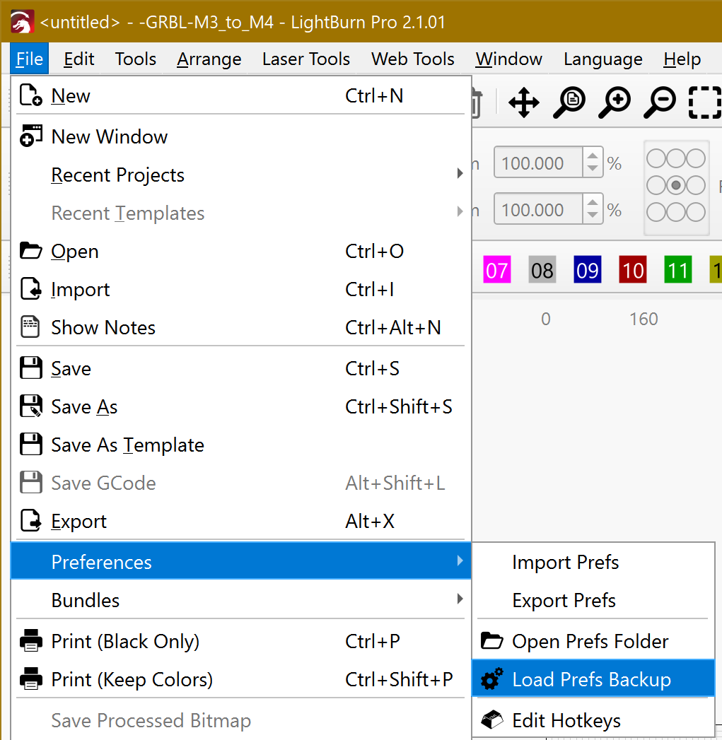

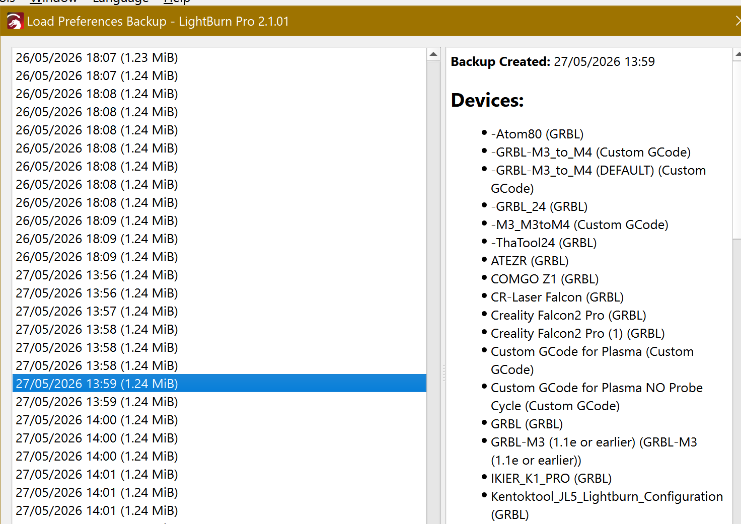

Try loading a prefs file from when it worked:

Thank you so much! I went back to an earlier version, and then did the prefs thing, and everything seems fine now. No idea what went wrong, but that’s something to tackle another day.
