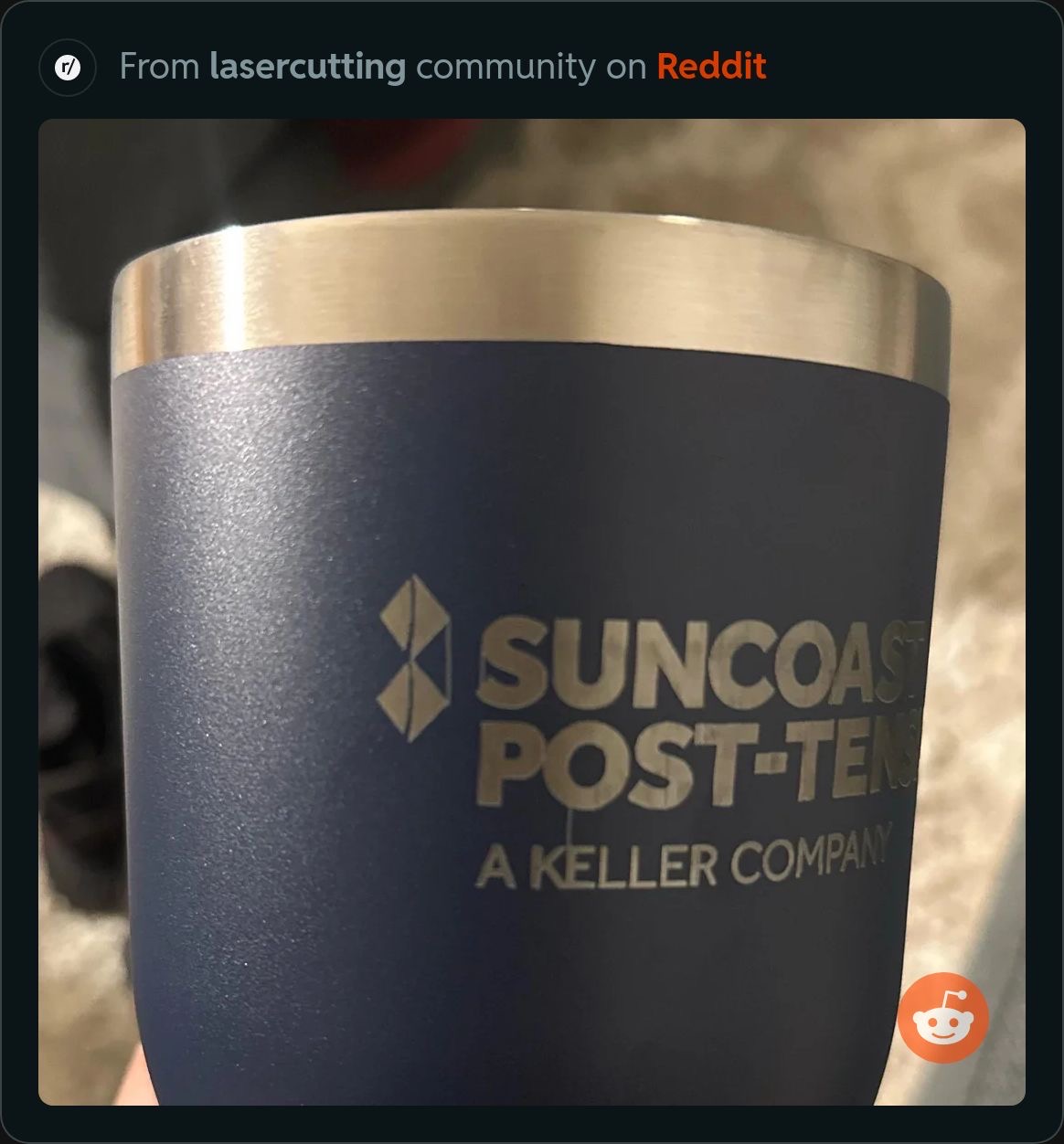

Help - Why am I getting these vertical lines between fills?
$32=1, $31=0, and $30=1000. Using rotary chuck.
In the Console window in LightBurn, with everything powered up, running, and connected, please request the system info report from the xTool by typing:
$i
then press enter.
Please copy and paste that result here.
One of the early xTool Firmware versions would produce marked travel lines.
If it’s not firmware, It could be a communication error but that is considerably less likely.
I have been getting these lines for months, only horizontal. I inquired about this issue in this forum only to be told that it was not the software. I’m not sure if ‘software’ and ‘firmware’ are the same thing, but my issue continues still to this day.

The firmware you have running is the exclusive responsibility of the laser hardware manufacture. LightBurn talks to this firmware to learn how the system is set up and the controls available. Using this understanding, LightBurn can then produce the correct code needed to produce what you plan, and then send this coding to the laser for production.
To find resolution to your questions, you will need to provide the exact firmware version, and the current settings you have applied in the firmware.
How do I go about getting that information?
XTools, if your forum profile list is the laser system we are referring to.
