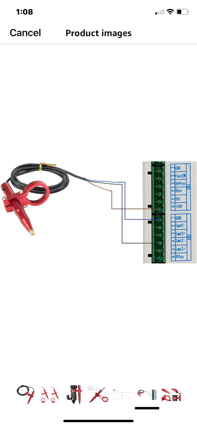

Hello I have a ruida RD 6442S controller just installed a cloud ray auto focus the The bed goes down, but will not come back up and anybody walk me through the Settings that I am missing. I powered it up exactly the way the diagram shows on Cloudray

Hey, thank you so much for giving me an idea to try something new. I will do that. I also noticed I didn’t have my brown wire hooked up to the 24 V once I did that everything worked except for the bed coming back up also it would not focus. Needless to say here is the actual picture of the hook up.

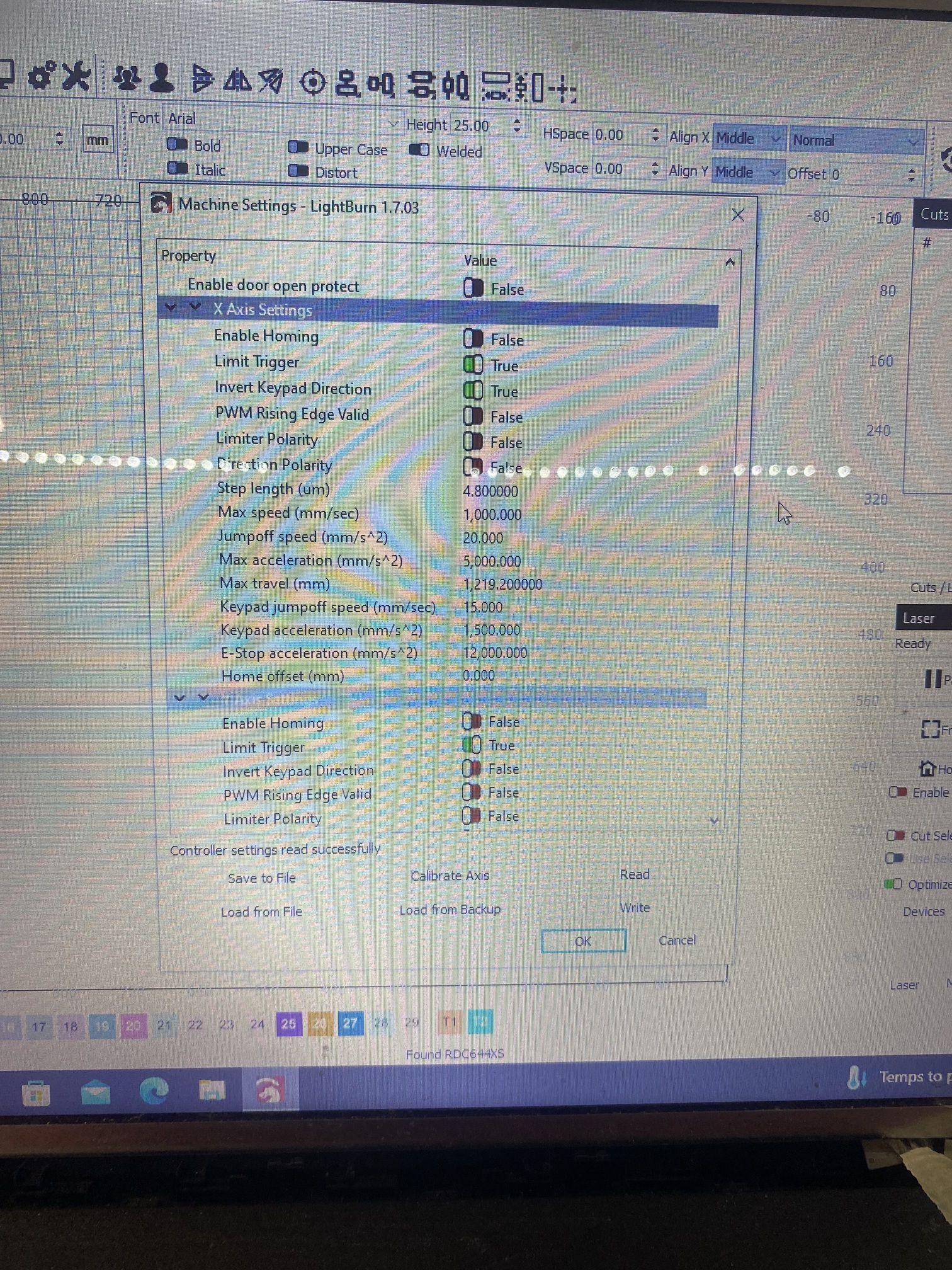

Upload some screenshots of the Machine Settings showing these sections:
MiscellaneousforFocus DistanceVendor SettingsforHoming SpeedZ Axis Settingsfor all the other values

Unfortunately, phone pictures of screens are almost unreadable at this end. Next time around, please take actual screenshots:

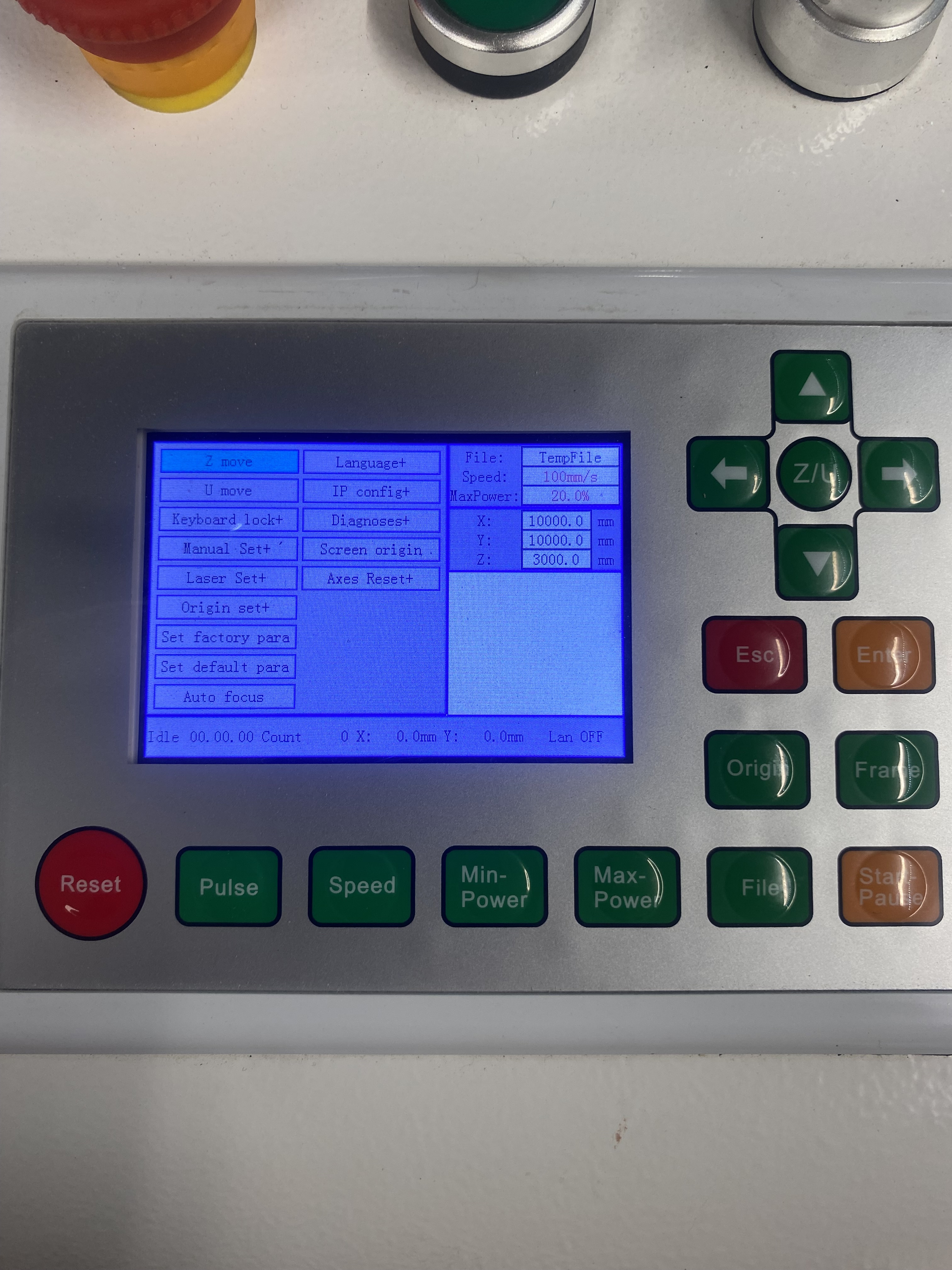

The machine display shows the X and Y axes are at 10000 mm, which means they have not been homed. If the machine has home switches (which it almost certainly does), set the X and Y Enable Homing switches True. Because it almost certainly does not have limit switches on the other end of the axes, set the X and Y Limit Trigger switches False. Doing that will eliminate the problem of Absolute Coordinates not working. ![]()
For the Z axis:
- Set
Limit TriggerswitchFalse - Set
Max Speedto 10 mm/s - Set
Max Accelerationto 100 mm/s² - Set
Home offsetto 0.0 mm
Calibrate the Z axis step length by measuring the actual distance the platform moves when you jog it 10 mm, then set the Z axis Step Length to:
1.25 Ă— (actual distance) / (jog distance)
The 1.25 is the Step Length setting. Repeat that process using the new values of Step Length until you jog it 10 mm and it moves 10 mm, whereupon it’s all good.
With that setup, the machine should home in X and Y when you turn it on and come closer to doing the autofocus dance when you poke that menu selection.
Take screenshots of the X Y and Z settings, then let us know what really happens.

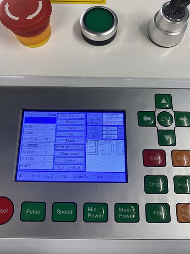

Next, verify the signals reach the controller. The 6442 manual says pressing Z/U → Diagnoses on the controller display will show the input signals. Then manually trigger the home switches and verify that the X Limit - and Y Limit - indicators change.
On my KT332N, the indicators light when the switches are active = triggered. However, @jkwilborn reports his controller has indicators that light when the sensors are not active. The key point is that the indicators change when you manually trigger the switches.
If the indicators do not change, then you must find out why and fix it. Wiring? Power? Something else?
