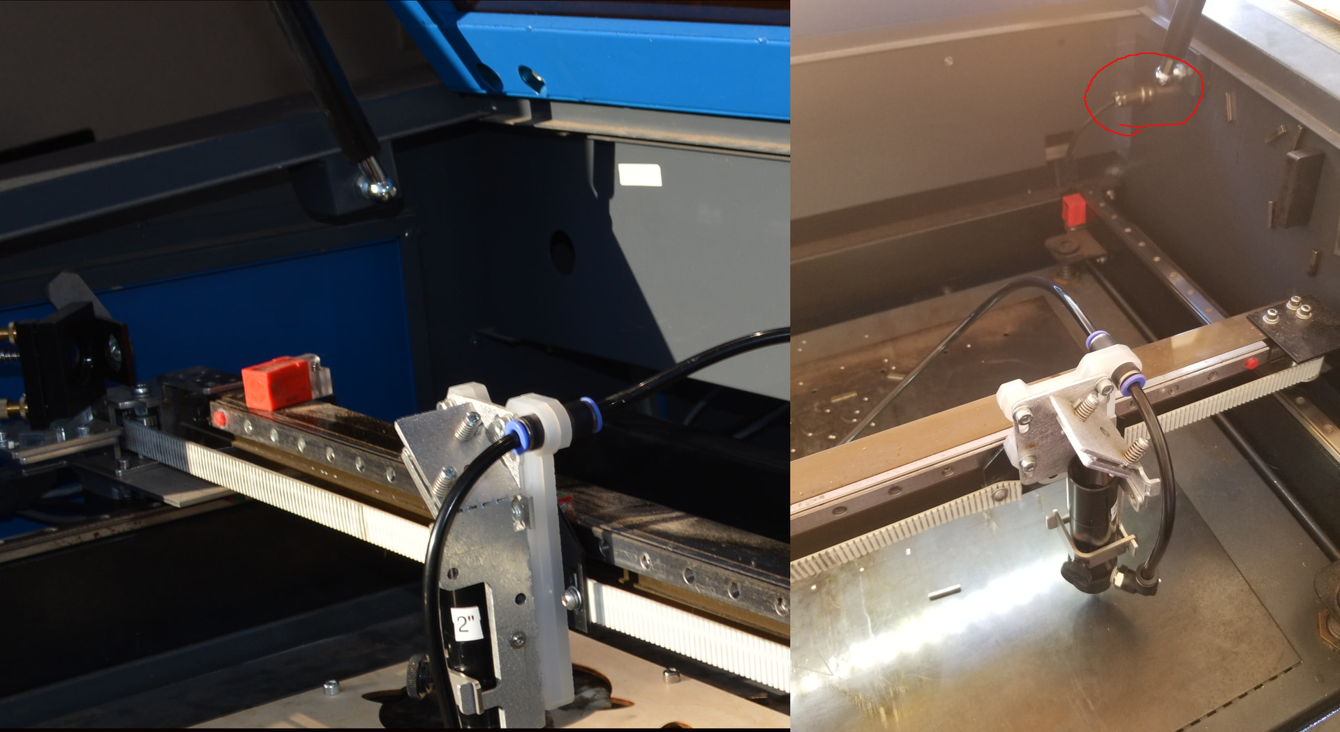

Hello, I am new to laser burning, cutting and engraving. I just bought a Vevor 60 W CO2 laser and the setup guide is about worthless. I was wondering if anyone could point me in the direction of a how to set up guide. When I received it the bed was loose inside the case so I have no idea where origin is for starters along with many additional questions regarding this machine that the guide does not answer. Can anyone point me to a video or some kind of help in setting this up?

When you power it up, it should find the origin, bed loose or not.
Most of these home to the upper left. There are a couple of switches, usually hall effect types on one end of each of the axes.
Here are mine. The orange boxes on each axes. Left is the X axes and right is the the Y. This means it’s home is upper left, generally speaking. You can configure these for any home corner, what it really does is tells it to limit operations within that machine to a single quadrant.
You can see m2 to the far side.
