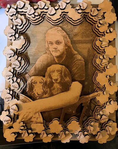

I’m not sure if Lightburn forums are the best place to ask this or if I should investigate a woodworking forum. In this picture, I tried to attach the paw print pieces to the frame but was somewhat unsuccessful.
I laser-cut a “template” along with the pieces to hold all of them in place while I was gluing but I think I might have left it to dry too long before removing the template - thus I had to break it into pieces and it took some casualties with it.
I’ve had trouble in the past with another similar project so I was wondering what suggestions anyone might have for getting lots of small pieces glued down accurately without having to pick up, glue, and place each one individually?
