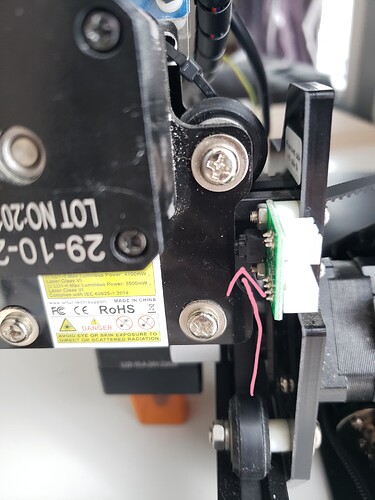

Hi ! I installed the laser module LU2-10A on my Ortur Master 2 and when I try to homing my laser, it doesn’t work. It’s like it doesn’t sense the home button but it really does touch it. When the problem occur, Lightburn write me this. (In french)
OLF 142.

Well when I touch it, it click, but with the manipulation I came to see that the back of the laser engraver doesn’t engage the click. Here’s the reference in the photo.
And yes I requested the question mark while maintaining the X axis switch and the console said me this.
These engravers are designed to touch the switch. It should click. If it does not click something is preventing the motion.
I can see why. That little board with the switch on it, isn’t plugged in.
Have a look at the assembly video, starting at about 7:03 where that circuit board with the X-Axis limit switch gets plugged in.
