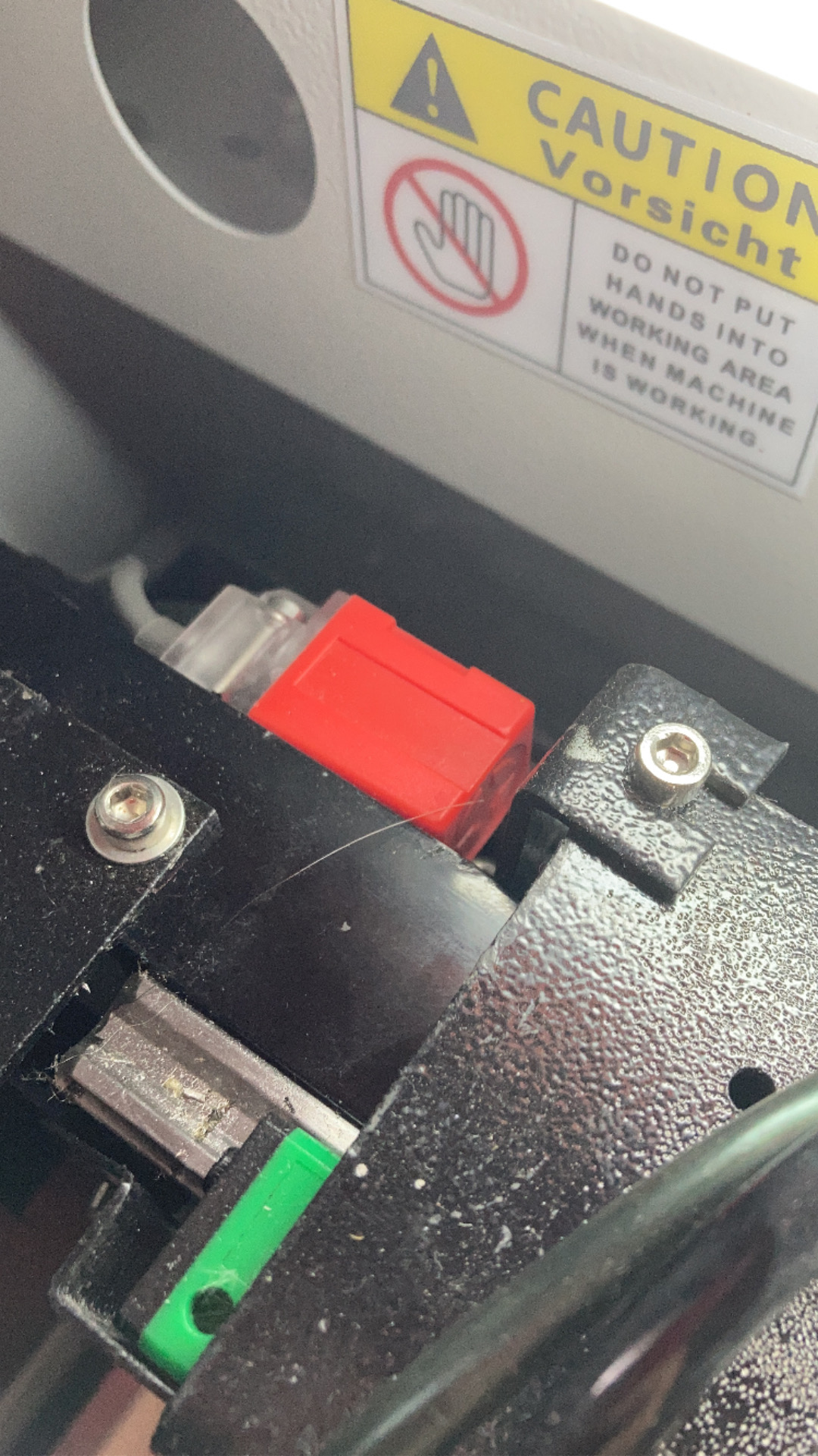

Hi all I have gone from a K40 to a new machine and can’t seem to set it up correctly.
I’ve plugged it in and done devices find my laser click on the ruida 644xs clicked origin of laser to be rear left and finish.
So on lightburn my down moves the laser up, control panel on machine is correct.
The home seems to go to the bottom left of the machine but I would like it on the top left.
The green and red dot on the page on light burn are both at the top and files come in messed up.
Can anyone help me out with these issues

First of all, you should check where your end switches are actually mechanical installed on the machine.
Than get the controller to make your homing correct. Either your home switches are not lower left, or something is wrong with the switches/cables.
Obviously your machine is not homing correct.
A picture of your bed and gantry could help.
Hi thank you I’ll attach pictures now. It homes or try’s to but smashes against the side until I hit the emergency button
To me this looks like your end switches are Up (not clearly to see) and left. Is that right?
Yes I have two one top right and one top left that moves with the laser
So you are homing to top left.
You need to change homing direction at least for the Y-Axis
