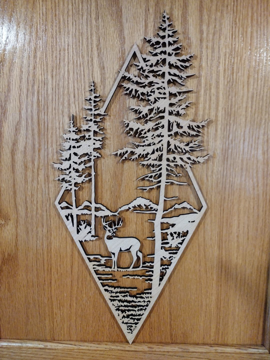

Hello all, I have a scoulpfun s30 pro max 20 watt and I love it! It was so accurate and precise. So I decided to upgrade to the 935x905mm kit.

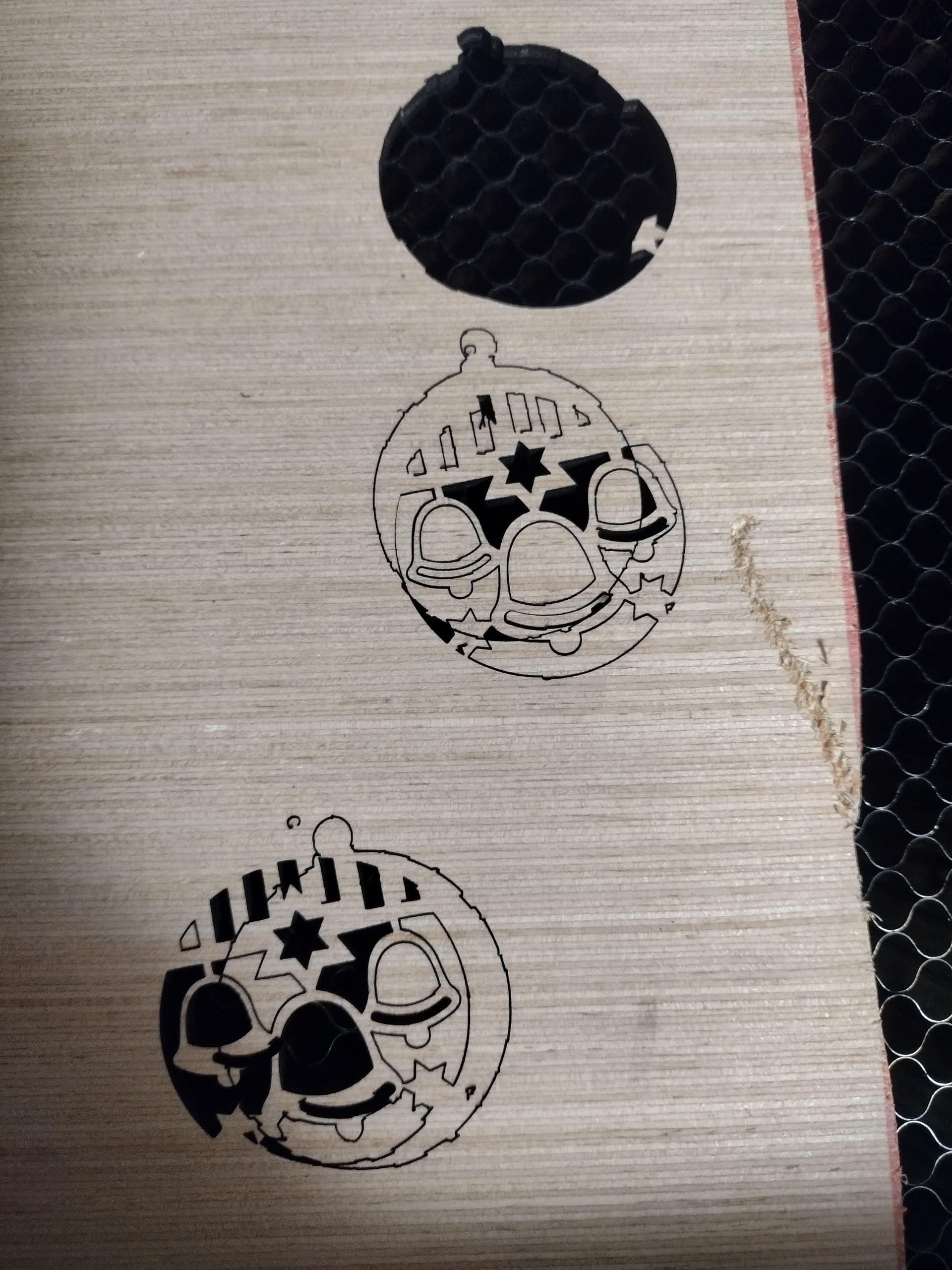

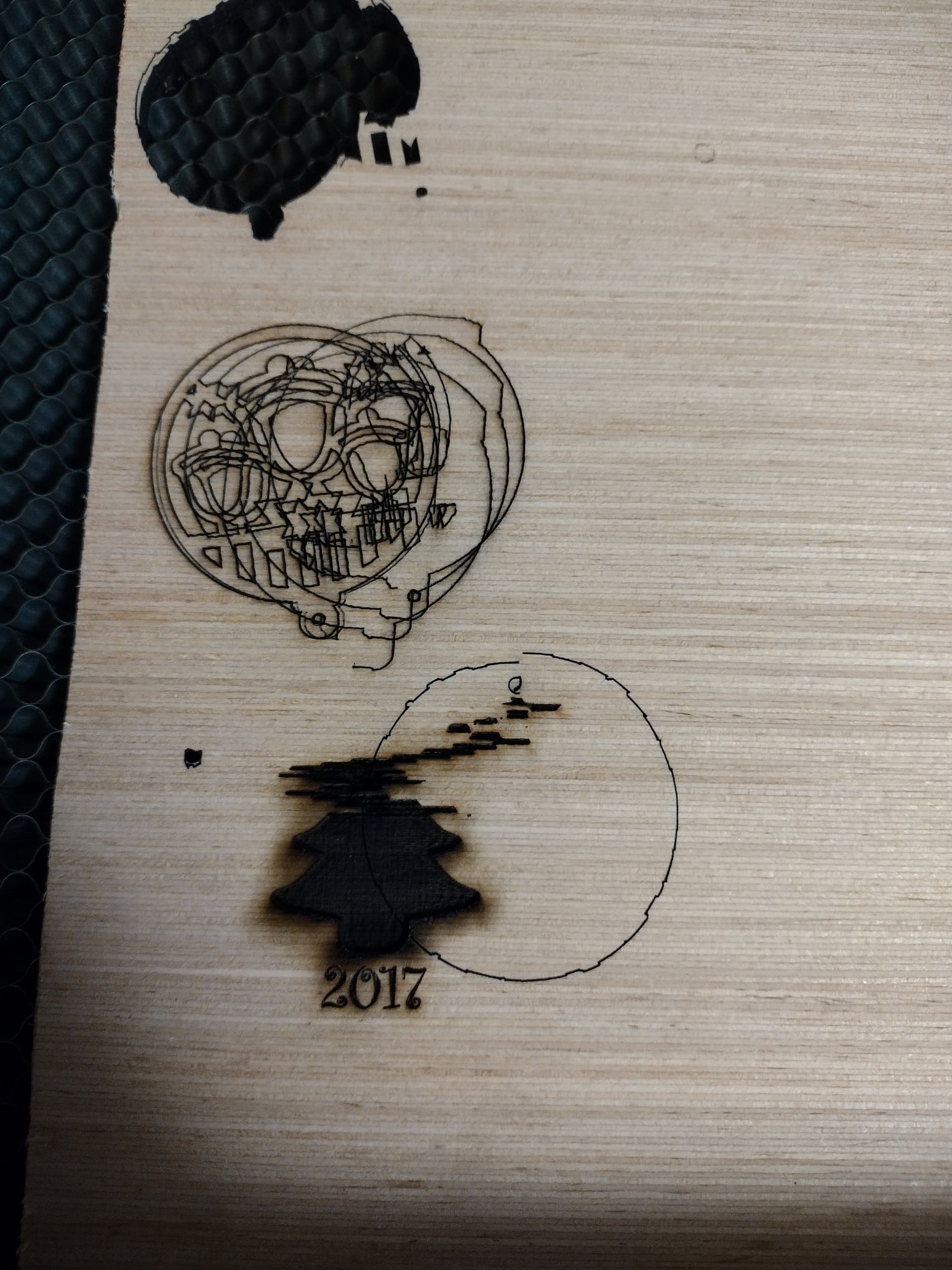

Well I built the original laser from the kit and it worked great. I followed every instruction and everything to a T now, the frame is larger it will not cut very accurate at all.

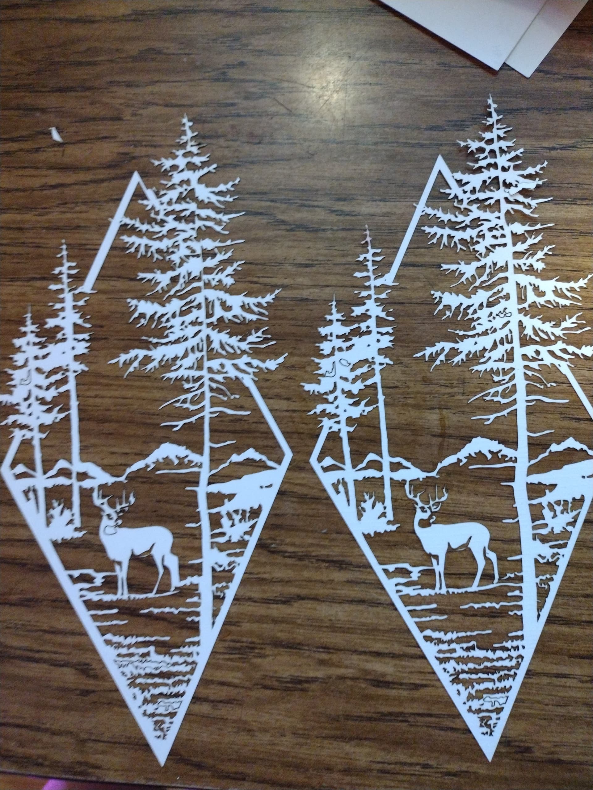

Has anyone got there sculpfun 935x905 running and cutting good and accurate? I will include a picture of the before the upgrade of a deer and tree. Next will be how it’s cutting now.

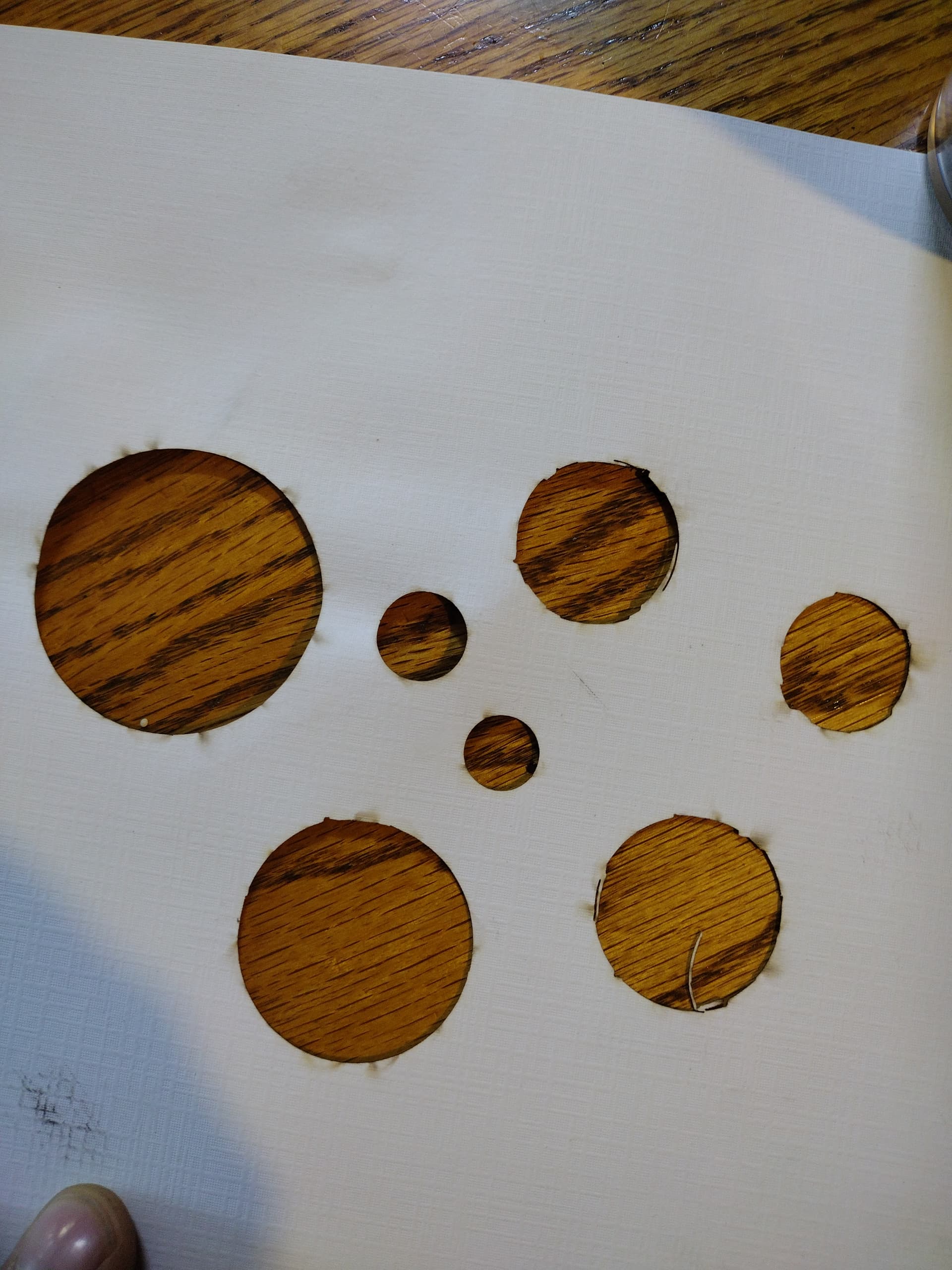

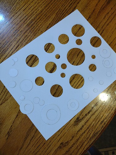

I have went over this machine untill I am blue in the face lol. This is what I don’t get,
Here is a simple circle patterns cut out of cardstock just for speed and not to waste wood. The 1st test turned out sweet!
Now this is the 2nd test I ran same as the 1wt but I had to stop the test. Check this out lol.
Test ran back to back. I am starting to think maybe it’s a mother board issue. I can’t see a adjustment ever cutting pretty perfect then going to crap.

I need to test it on wood tomorrow but I believe I have finally figured it out. Thanks to misken and his power adjustment on the mother board of the laser. I had them maxed out! I could have swore that’s what the video and instruction said to do. So I backed the x and y back off to about 50% power and now it’s been cutting great!
I have just been cutting cars stock but every speed and power turns out pretty good! Will do more test tomorrow.
FYI, I did go over everything over and over the power adjustment was the one thing that made it better and better.
