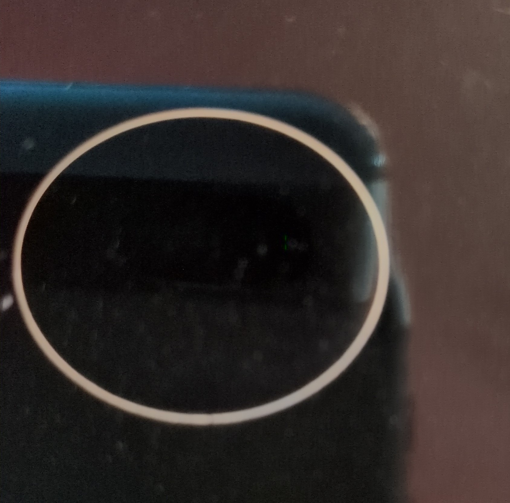

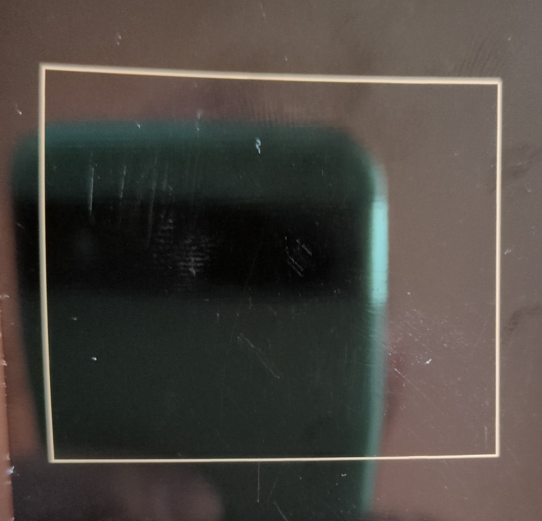

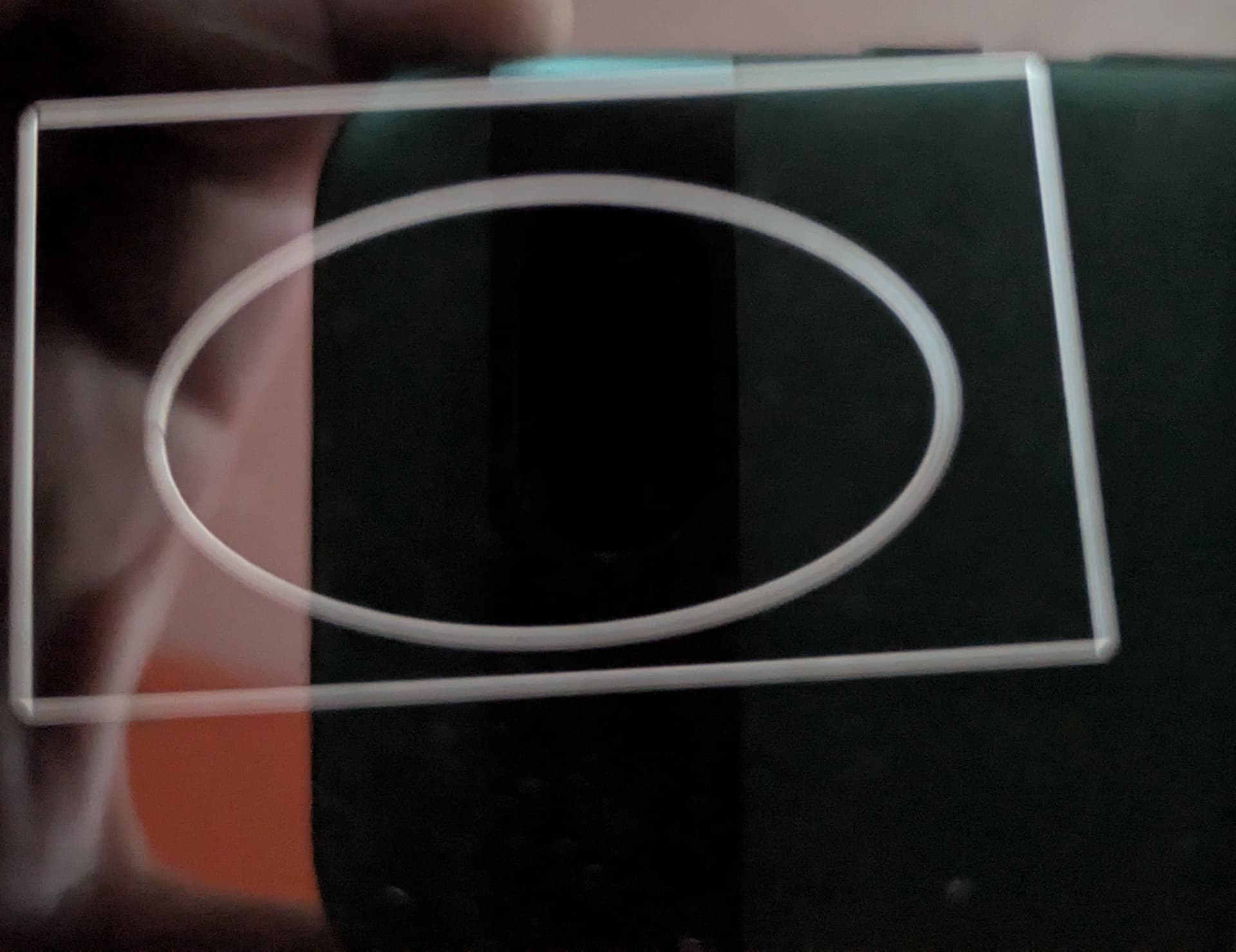

When engraving using LB, the engraved objects come out stretched/deformed. I checked the parameters hundred times, they are correct.
Here are a few examples of markings on business cards. The objects are supposed to be a square and a circle, but as you can see, they are not.
Any kind of help would be appreciated.

Calibration didn’t work. If anything, it made it worse.
This were supposed to be a square and a circle.
well if it is worse now you should do the math yourself, take the current value for the axis that is wrong and multiply by wanted size/actual size

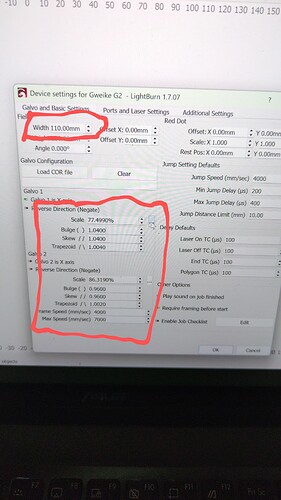

Is the height set the same as the width?
Yes. 110x110 mm
The red highlight covered the height setting, that’s why I asked. I hope you find a solution soon.
