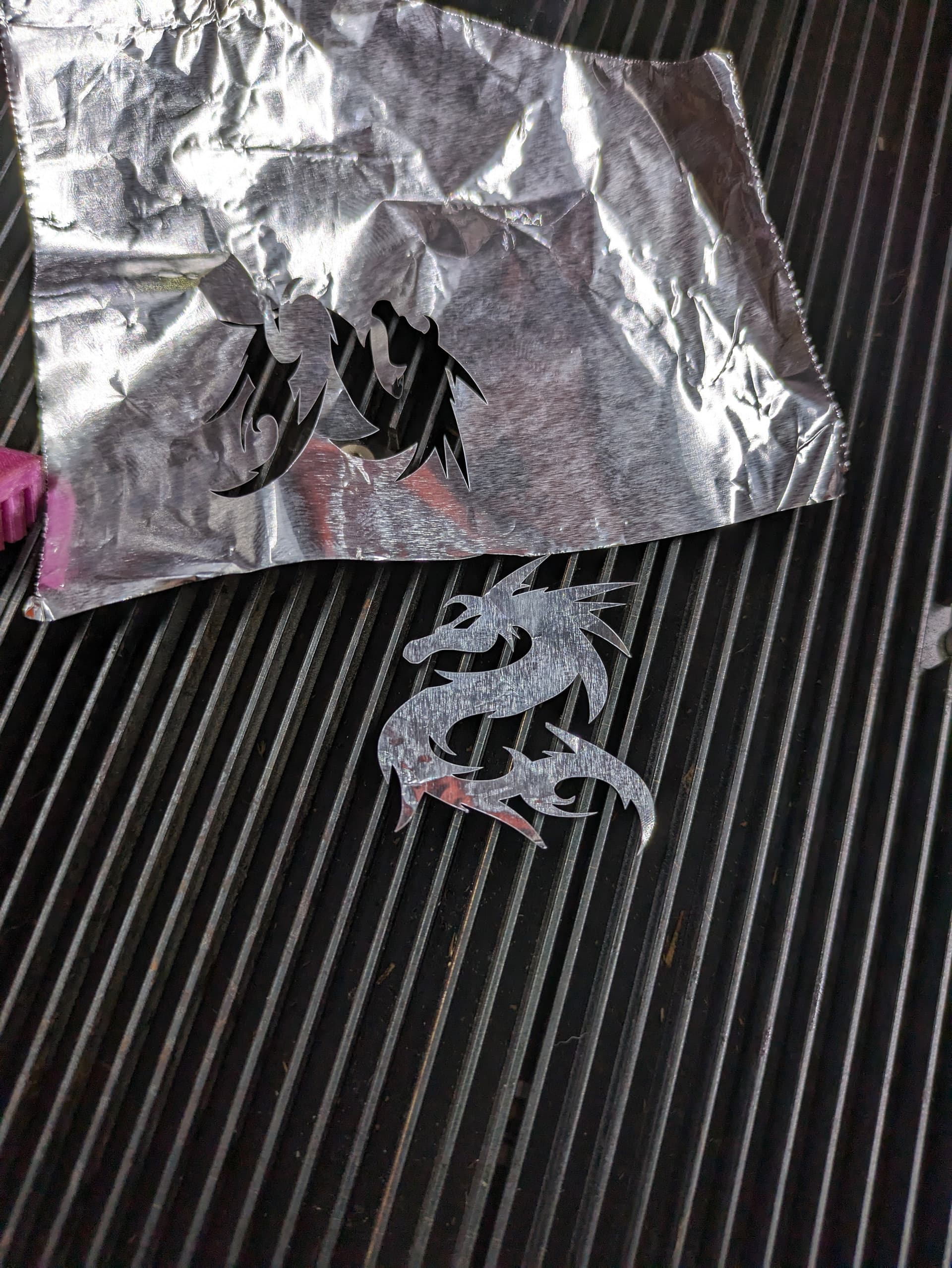

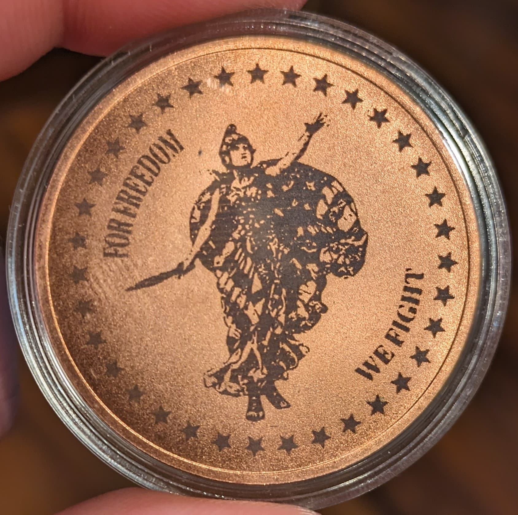

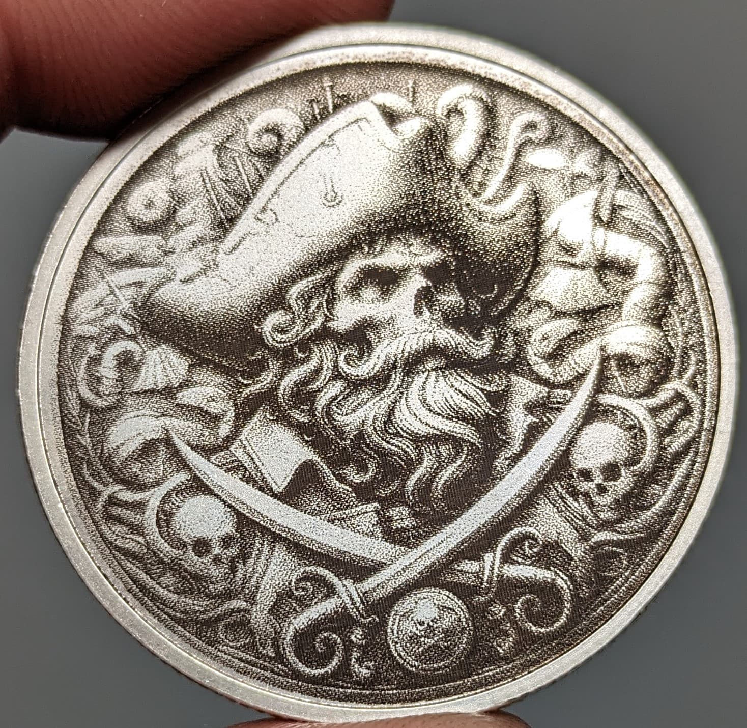

You can get IR diodes now. I personally have the 2W IR from both XTool for my D1 Pro and the 2W IR from Snapmaker. I’ve engraved all sorts of metals with them so far.
And even cut foil

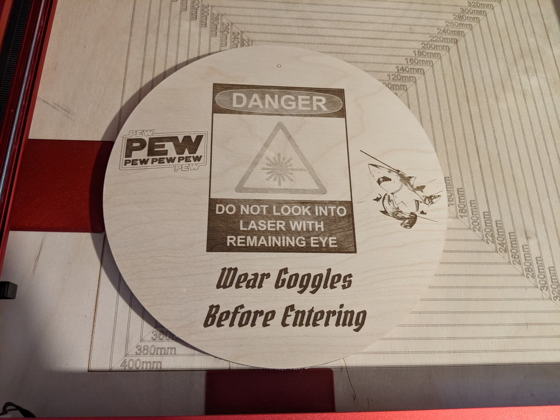

For ease of placement, you’d want some form of board under it and setup a repeatable origin, which is easy enough. You can even quickly engrave a lineup section on your backing board, you can see the grid on mine here;
I also have 3d printed hard stops for alignment as well.
