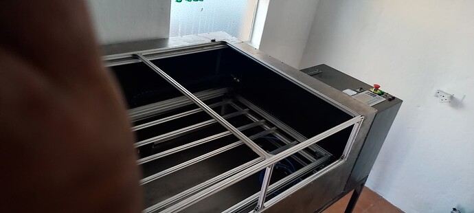

Ok so the laser wont be open completly we are stil busy it has a box will send pix, but we were strugling with the Electronics and i was strugling to get the program and machine to speak to each other so that is sorted, now im strugling to set my mesuerments so the laser nossle does not bumb on the front rail and to calibrate the machine. I have a limit switch on the right hand sight if i stand infront of my machine and the my x and my z and my y but only one on the left hand side
This is the enclosre that wil go ontop of the machine and then the exstraction fan must still be done and the door of the machine witch will get plexi glass on it so it will be closed

Im addin sosome photos and just bare in mind we are still busy we need to do some stuff still

Based on the photos it looks like you have switches meant for homing to top-right. Can you confirm? Does the machine home properly to top right at startup?
In that case if you are crashing to the front of the machine I assume you haven’t setup the max travel limits of the machine on the controller. This defines the software dimensions of your work area.

I only saw two switches in the photos which I took to be the homing switches, one on right side of X gantry, and one on the back right for Y axis. @Laserworl mentioned other switches that didn’t fit the photos so I took those to mean additional limit switches.
I couldn’t see a switch on the left in the photos and took the “right hand side” one to mean one at the front of the machine so interpreted these to be limit switches. I may have misinterpreted.
@Laserworl, can you confirm the total number of switches you have on the machine?
I think @Laserworl needs to clarify if they are actually home or limit. You would normally put limits on both ends of all monitored axes or it’d be rather moot to have any…
