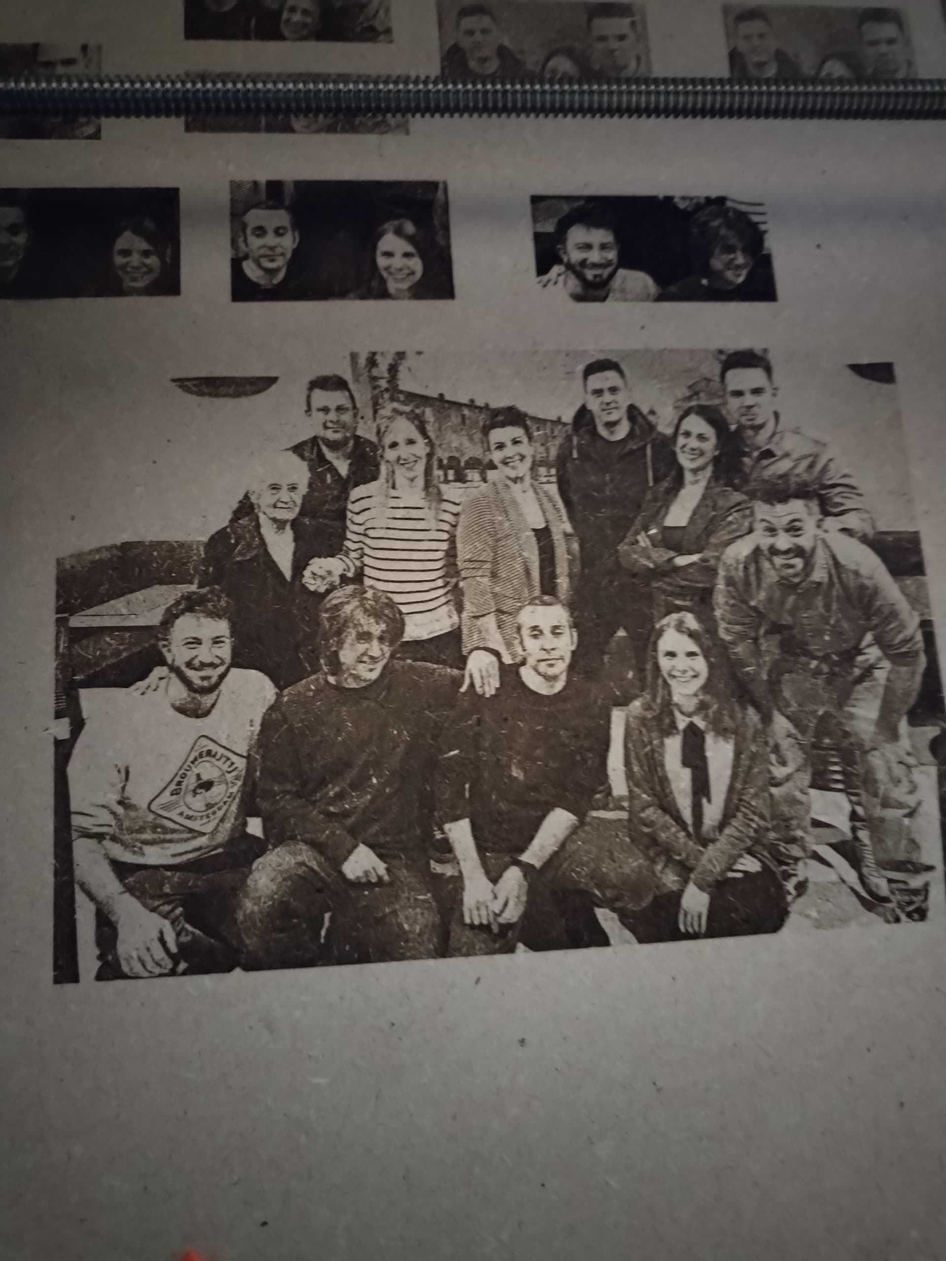

Ho impostato 0.04 come intervallo 635 dpi
0.04 intervallo a 635 dpi perché Light burn mi chiedeva se ero sicuro?
pochi laser fisicamente riescono a fare sopra i 550 dpi recitava il messaggio..
Alla fine sono soddisfatto del mio laser da 10w. Ora si posso quasi sussurrare che questa è un incisione, ancora qualche dettaglio e ci sono.
Ma sono Contento già adesso

A 10w laser with good manufacturing can do at best 318LPI (0.08mm line interval). If you use 636LPI, you cannot improve resolution. At 636LPI, which is 1/2 of a 10w spot, means you will overlap (burn) every pass by 50%. All you are doing is overburning the image.
You cannot beat physics with a Lightburn setting.

A 0.06mm spot size translates to 318LPI, not 600+.
I am not saying the engraving turned out poorly. In fact, it looks pretty good to me. I wish mine turned out that good! But if you want to take advantage of the detail the 10w beam can produce, 318LPI should be your highest setting.
When I am burning wood, I typically use 254LPI because there is always some side burning with the laser. If I am doing tiles, tumblers, or anodized aluminum business cards, then I will use 318LPI because those items can show greater detail.
Summary: Use whatever makes you happy. We are only pointing out details that you may not have known. More knowledge in your toolbox is always a good thing.
Plus it can cut your work time almost in half while still keeping the detail.
Grazie ancora, proverò con 318 dpi, forse dovrò fare più passaggi.
Il materiale su cui sto incidendo è mdf da 4mm.
