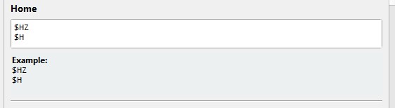

Home all ($H) not work for me
When I press “all home” or when I type $H only XY goes, Z doesn’t move, I have to give a separate command. To get Home Z+X+Y, I have to activate something in millmage?
For now I created a macro for All Home ($HZ
$H ). If possible, this should be on the All Home button of MillMage so that we don’t break cutters at startup. :slight_smile:

No, that’s not possible. The standard home command is $H.
Your firmware is not configured correctly (for your requirements). Depending on your firmware you can either define the homing sequence in a configuration file, or (for example with standard grbl) you need to define this at compile time.
You define arbitrary homing sequences there, (for example, home Y, then home Z, then X). You define it for your machine, and MillMage will always just call $H if you click on home. Everything else doesn’t make sense.

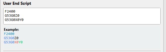

I have solved the problem through MIllMage. I read some code and it helped me. Now it works great. Thank you all for your time.
