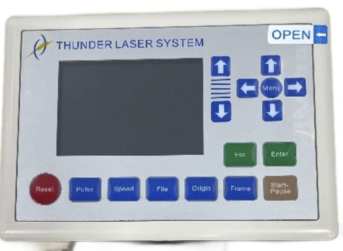

The HOME button in LB is not working in the MOVE window or the LASER window.
All other buttons in both the MOVE & LASER windows are working properly other than the HOME button. Any ideas? Thanks!
Does the Home button on your laser controller (the hardware itself) function as expected?
Hi,
The control panel on my Thunder Nova Plus with the Ruida controller doesn’t have a “HOME” button. The arrows that jog the laser head to the home position work fine though. All of the other buttons in Lightburn MOVE work too. Just HOME in the MOVE window and HOME in the LASER window are non-functional.
Pressing the reset button causes a Ruida to home.
Yes, and that function works as it should.
I was able to resolve this issue by reinstalling LB.
