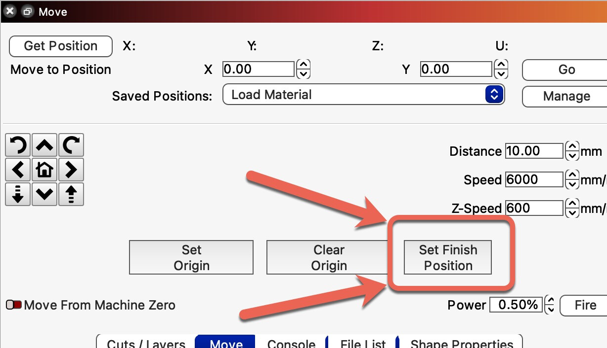

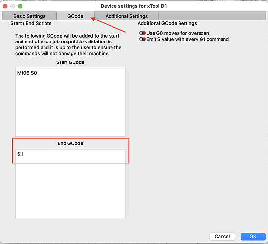

Home laser after job
Is there a way to get the laser to home automatically when it’s done with the job?
You can set the finish position in the Move window
Another option is to add a homing command ($H), to the ‘End GCode’ field in the Device Settings window, under the ‘GCode’ tab (‘Edit’ > ‘Device Settings’ > 'GCode)
