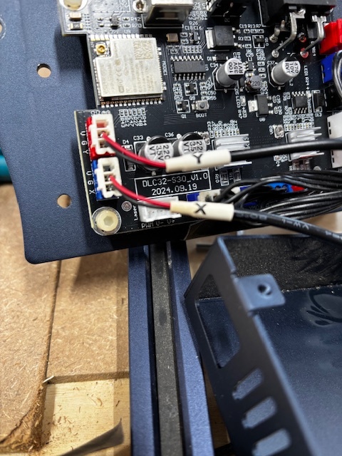

I’m going to pull the cover off again and double-check my connections. I’ll photograph what I have.
Thanks for the reply.
That tells us that either the conection is bad, the switch is bad or the cable is bad. Check the connection first. If everything worked properly before you changed the board, it’s most likely a bad / incorrect connection on the board.

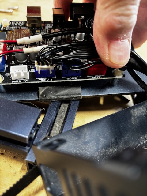

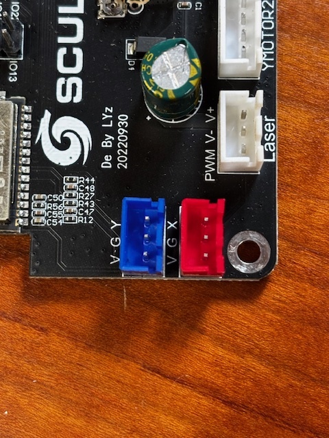

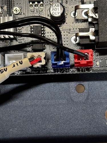

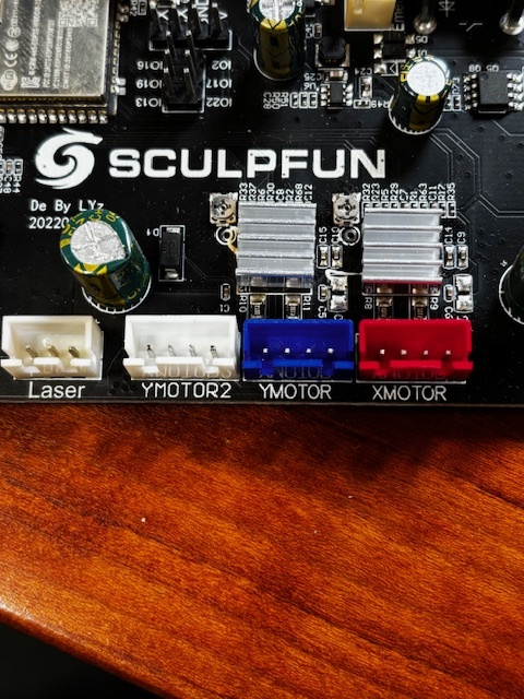

Here are the ‘replacement’ connections and the original motherboard. There’s a slight difference in the female connectors in the new board. The YMOTOR2 socket is blue while the original was white but all three males are plugged into their respective sockets.

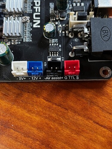

Regarding where the air assist wire goes, its location is different as are the 12/24U and G TTL S but I’ve plugged the appropriate cables in. Same with the X and Y
Original board:
Plus the X & Y sockets are turned 90* FWIW.

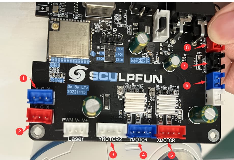

This is the note and photo from Sculpfun to go with the new board:
You can refer to the following instructions to complete the wiring, and then turn on the limit switch function on the software without refreshing the firmware.
  1. VGY is the connection point of the Y-axis limit switch,
  2. VGX is the connection point of the X-axis limit switch.
  3. YMOTOR2 is the interface of the Y2 motor
  4. YMOTOR is the interface of the Y motor
  5. XMOTOR is the interface of the X motor
      • is the interface of the laser power supply
  6. AIR is the interface of the air pump
  7. TTL is the signal interface of the laser
Follow the above instructions to connect. After the wiring is completed, if you are not sure whether it is correct, you can send us a photo of your wiring on the motherboard for confirmation.
I noticed I had #6 & #7 backwards as I put the air cable where it was labeled air on the board. I just reversed it to what Sculpfun showed and now the laser moves to the left when starting, not to the bottom.
I don’t know how to check for broken wires or switches.
The only thing I notice in the photos is the Y2 connector doesn’t appear to be fully engaged. That may just be the angle of the photo. That would not affect the limit switch not working though.
You said you don’t know how to test the switch, so I assume you don’t have or know how to use a multimeter. That’s Ok. I’m going to suggest a test to see if it’s the switch / wiring or the board.
On the board, swap the X and Y switch connectors and repeat the test where you press the switches to stop movement. IPressing the switch on the frame should now stops the sideways movement, pressing the switch on the gantry should stop front to back movement.
Perform this test and report your results.

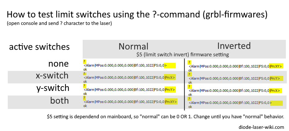

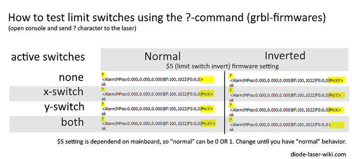

Melvin, this is what I got when I entered ‘?’ into the console bar:
It certainly looks different than your screenshot. However, as per my last note, it appears to be working so I’m not sure how important this is. Is it? Or are my parameters OK?

What were the results of the test I asked you to do? When you swapped leads, did the X axis stop when you pressed the X axis switch or when you pressd the Y axis switch? What was the behavior of the Y axis?
Tim, I have the extended 900x900 frame, ~40" x ~40" OD.
Performing your test, engaging the limit switch on the gantry did not stop it from moving side to side nor did touching the switch on the frame stop it from moving front to back.

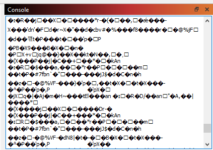

Also got a lot of this at one time:

If the machine continues to work, it is nothing ov concern. That is the PC and Controller trying to sync up and communicate.
You need to adjust Max Y travel ($131=900) to get it to home in one motion from the far end. The “Rubbish” in the control tab is usually due to incorrect Baud rate setting or Interference being picked up by the USB Cable
