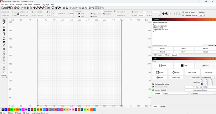

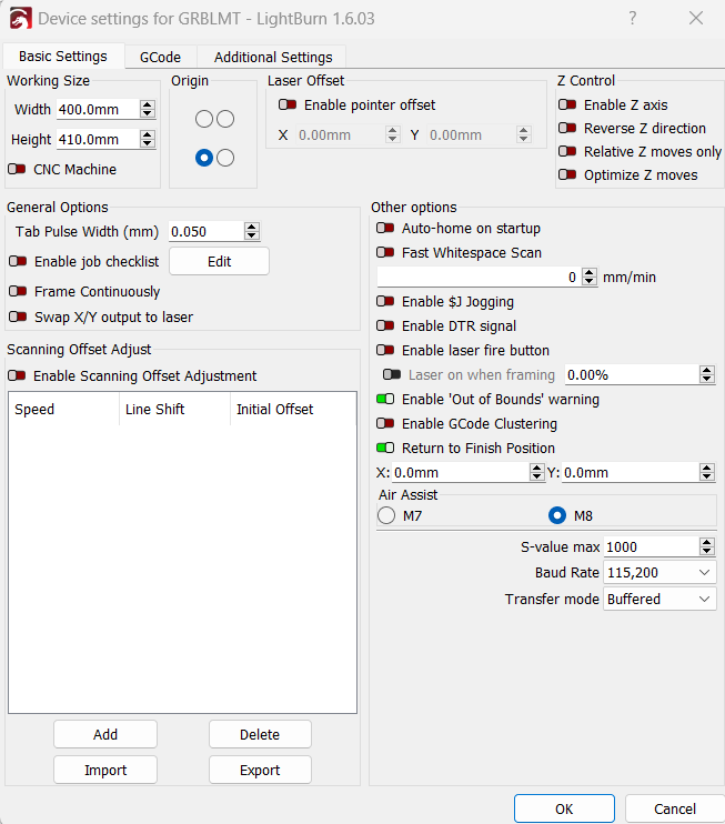

I can’t get out of error 8, 9, 5 and alarm 2. When It’s not one, is the other. this happened since once my lasser crashed with the side once
Show a full screenshot of your LB window and of the device settings window.
There you have.

Those screens look ok.
I think your laser was stuck in negative coordinate space then, though I don’t know why it happens if you reset / rebooted it completely. Never mind, if it works now, it’s fine.
